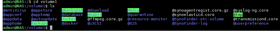

Pilot 0 Posted October 12, 2021 Posted October 12, 2021 (edited) I've run into similar issues as others on here - waited 4 months after DSM 7 was out/stable before upgrading. Upgraded DSM... and then realized Emby (which was already at 4.6.4) was no longer working, so clicked the Repair button in Package Manager and no dice. My Emby files were never located in /volume1/Emby - unless using the Repair button moved them. There is no such directory on my system. However, I have looked and they all appear to reside in /volume1/@appdata/EmbyServer as they would after the manual copy via SSH. I found this thread after I realized Emby wasn't working. What I then did was uninstall the old Emby 4.6.4, reinstall the 4.6.4 DSM 7 package, delete the Emby_PKG user* per the instructions, ran the chown command, and added the emby System Internal User to the single shared folder (Media) where all my media lives. *I never had a video group - so there was nothing to delete there I do see both the -WAL and -SHM files in there, but the file sizes are much larger than the DB files, so I'm hesitant to delete them: When I start the application, I get the setup screen - not the login screen: I uninstalled and reinstalled Emby and and re-ran through all the steps and it's still not working. Would appreciate any ideas/assistance here! Edited October 12, 2021 by Pilot
Carlo 4552 Posted October 12, 2021 Author Posted October 12, 2021 Hi, if you shut down Emby Server the wal and shm files should disappear. If not you can delete them. Your DSM 6 version of Emby could be installed on a different volume. /volume1/Emby is just the default. If you like send me a PM and I can remote in and take a look. If we can find you old install, we can migrate all the data over for you.
Pilot 0 Posted October 12, 2021 Posted October 12, 2021 4 minutes ago, cayars said: Hi, if you shut down Emby Server the wal and shm files should disappear. If not you can delete them. Your DSM 6 version of Emby could be installed on a different volume. /volume1/Emby is just the default. If you like send me a PM and I can remote in and take a look. If we can find you old install, we can migrate all the data over for you. I ran a search on my NAS and the only place it found library.db in the entire system is in /volume1/@appdata/EmbyServer. The wal/shm files didn't disappear after the shutdown but I did delete them (well, moved them to a different folder elsewhere just in case) manually. Then I completely restarted the NAS. Still brings up the getting started / setup screen.
