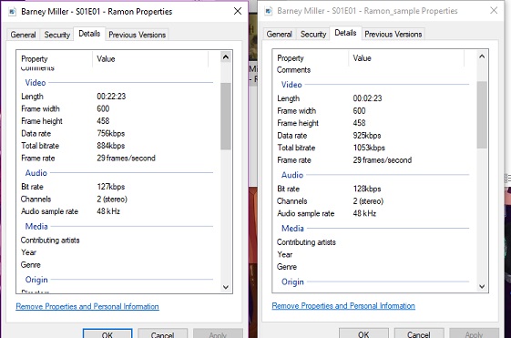

Flamebird 7 Posted September 13, 2017 Posted September 13, 2017 (edited) An sample file if possible. @@Happy2Play Okay, I made a sample file from an episode that "green screens" with direct play in both apps; but I don't know if I actually did it right I just chopped a twenty-two minute file down to about two minutes; cause I wasn't sure how big it needs to be the thing I'm mainly not sure of; is that it changed the bit rate and data rate in the sample file. I have no idea if that makes a difference for what you'll get. Next question of course; is how do I get the sample file to you? Edited September 13, 2017 by Flamebird
Happy2Play 9449 Posted September 13, 2017 Posted September 13, 2017 As long as the sample reproduces your issues. Do you have a dropbox? And if you do and you don't want to post here, you can pm me.

Flamebird 7 Posted September 13, 2017 Posted September 13, 2017 (edited) @@Happy2Play, @ebr: Way too early for me I guess; I can't get the sample file to even show up in Emby. Here's link to the sample file in Microsoft Box. Never used it before; so I'm not sure how you download from the link. https://app.box.com/s/80wltbfuhgvhbf7dhpnthr22ly3bcjr4 Edit: If this doesn't work, I can, apparently; upload the original file, but I have really slow internet and will take a while to upload. Edited September 13, 2017 by Flamebird

Happy2Play 9449 Posted September 13, 2017 Posted September 13, 2017 (edited) I got green screen on my Ultra in beta app. Force transcode in BNN it plays fine. Edited September 13, 2017 by Happy2Play 1

Happy2Play 9449 Posted September 13, 2017 Posted September 13, 2017 (edited) @@speechles @@ebr Was mpeg4 removed as supported Roku format? https://sdkdocs.roku.com/display/sdkdoc/Audio+and+Video+Support I just confirmed all my mpeg4 media gets Green Screen. Edited September 13, 2017 by Happy2Play
Happy2Play 9449 Posted September 13, 2017 Posted September 13, 2017 Is it direct playing or transcoding? It only plays force transcoding for me in BNN. To me it looks like mpeg4 support was dropped and Emby will have to update the profile.
