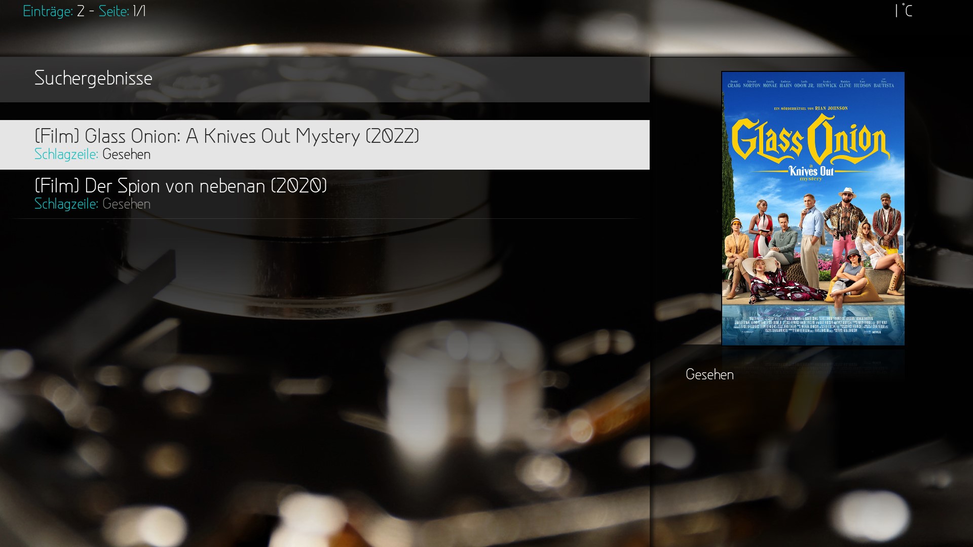

Centory
Hi @quickmic I have a question, when i select an actor, in this case "Dave Bautista", i get different results. In the movie "Glass Onion" is the result only one another movie (Der Spion von nebenan), When i select "Dave Bautista" in the movie "Guardians of the Galaxy", i get all other movies what i have (except Galls Onion & Der Spion von nebenan). In emby is all correctly working. In all ...movie.nfo files is the same info.
  <actor>
    <name>Dave Bautista</name>
    <role>Duke Cody</role>
    <type>Actor</type>
    <tmdbid>543530</tmdbid>
    <imdbid>nm1176985</imdbid>
    <thumb>C:\Users\Centory\AppData\Roaming\Emby-Server\metadata\people\Dave Bautista-tmdb-543530\folder.jpg</thumb>
  </actor>
I hope the pictures let you understand what i mean.
Spoiler
edit: I see in kodi.log
EMBY.database.video_db: Duplicate PersonName detected: Dave Bautista / UNIQUE constraint failed: actor.name
I will delete the emby and video.db and make another db reset, ihope this will work.
Edited by Centory
Link to comment

quickmic
  <actor>
    <type>Actor</type>
  </actor>
Do you use multiple movie libraries?
Link to comment

Centory
I did know what you mean exactly,  i have a NAS with 4 hdd, so i have a folder on hdd 1 with comic films, here is Guardians of the Galaxy 1 and on hdd 2 i have also an folder with comic films, in this folder is Guardians of the Galaxy 2 and i the in the library section i add a library Comic Movies and add both folders from both hdd's, is this what you mean?
edit: deleting emby and video.db and db reset will not help to solve my problem.
Edited by Centory
Link to comment

quickmic
6 minutes ago, Centory said:
I did know what you mean exactly,  i have a NAS with 4 hdd, so i have a folder on hdd 1 with comic films, here is Guardians of the Galaxy 1 and on hdd 2 i have also an folder with comic films, in this folder is Guardians of the Galaxy 2 and i the in the library section i add a library Comic Movies and add both folders from both hdds, is this what you mean?
I mean Emby server libraries, doesn't matter on which (hdd) drive they are located. But different movie libraries on Emby server are treated independently by the plugin.
Edited by quickmic
Link to comment
Share on other sites
quickmic
Like I said the libraries are handled independently, also Actor wise. This is a concession to musicvideo multi library support -> Kodi has limitations.
That's the reason I think the assigned movies to an actor works this way as you described.
Link to comment
