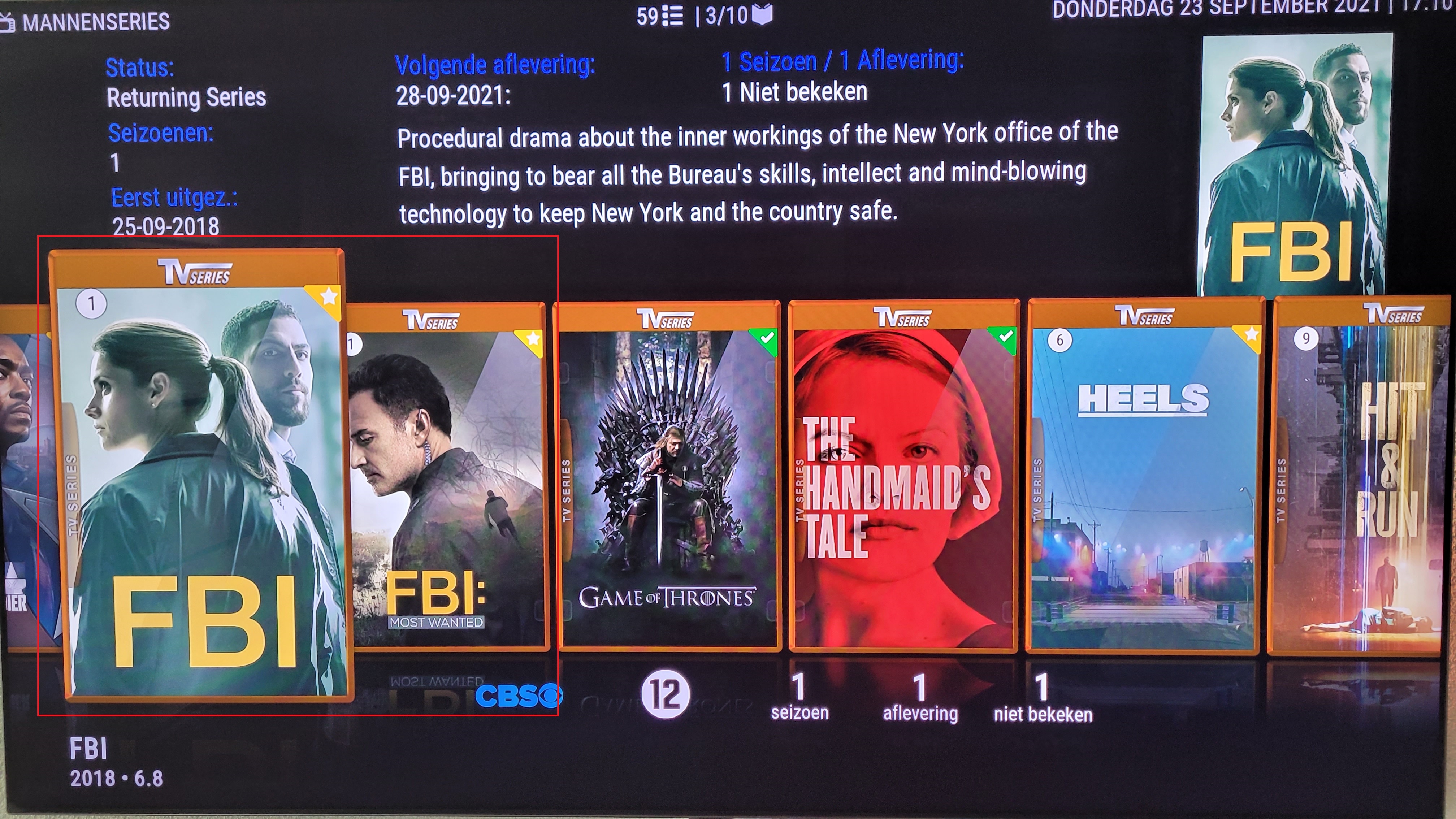

heula 192 Posted September 23, 2021 Posted September 23, 2021 Today I got something weird. My new added recordings did not show up automatically again so I tried updating the library, that did not help getting them visible so I did a library repair and there they were all my new added recordings. The weird part was that in one of my recordings there was a third episode that did not belong there. It was the pilot of FBI international that showed up in the Chantals beauty camper recordings. FBI international was also gone from the library where it belonged. No idea how but it doesn't go well (yet) Thanks. kodi.log embyserver.txt
BaukeZwart 94 Posted September 23, 2021 Posted September 23, 2021 (edited) I had a similar thing yesterday, I was dl 6 seasons of a new series, when I looked yesterday evening it had downloaded everything except season 4.in season 4 the same FBI int. series was shown. This morning after 6 seasons were dl the whole series disappeared from the catalog. This happened on both Shield and fireTV. A Kodi reboot didn't fix it. On both systems I needed to do a dB reset including a complete e4k settings wipe. Edited September 23, 2021 by BaukeZwart
quickmic 1609 Posted September 23, 2021 Author Posted September 23, 2021 I assume it has something to do with the remove item bug I reported in one of the earlier postings. New version is almost finished and should be fixed. The remove bug also affects relabeled files and probably several more cases. 1 3
