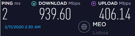

21 hours ago, CharleyVarrick said:
I suggest you try getting a decent internet plan, unlike this 🤣
Seriously envious, but I saw mention you have dynamic libraries and while I cannot explain all the nuts and bolts of it, it might be a big part of the slowness you are refering to
Consider syncing that library
Dynamic libraries are just the way the addon (E4K) sees the libraries until they are synced into the KODI .db file.
I'm syncing them into the KODI .db file.
I only referred this because it's what the addon can see, for debug purposes.
I dont stream/transcode from my server either.
I use native playback :D
My internet plan has nothing to do with this but thanks for quoting my sig :D Internet is cheap where I live
