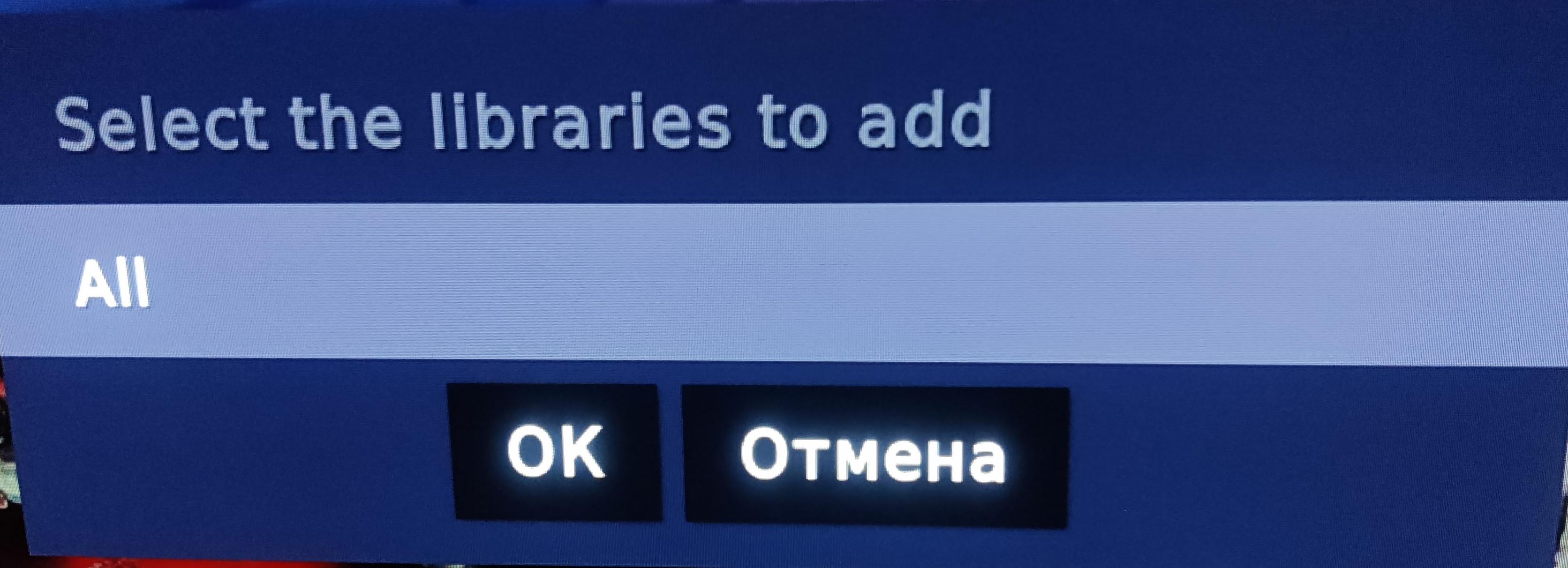

Brief feedback on the current version the function Add libraries "all" or individual libraries only starts after a restart of Kodi.

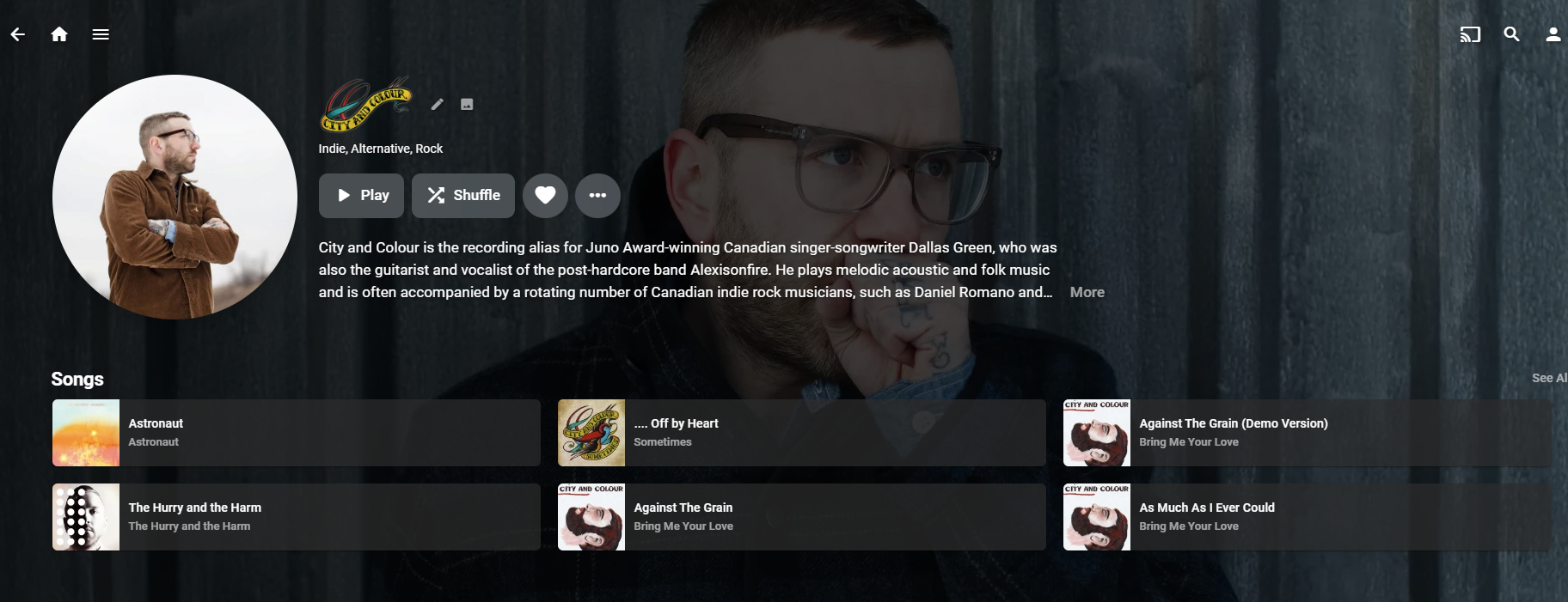

One thing I noticed with 7.9.2 (may be earlier but can't recall when this started with recent releases but definitely not in 7.2.0...probably started during the more recent artwork revamp for TV) is that for music the fanart background appears to be blank.
Using the default skin, no visualizations and playing any song the background would be the fanart for the artist whereas now its blank/black. Emby web still shows the "correct" background.
Upon further review, in this playback it looks like the album art was replaced by artist while the main artist view page still shows the correct album art.
See below, first image is Kodi play back with black background with setting shown for fanart, second is Emby web, third is the Artist/Album view in Kodi with proper Album art shown.
