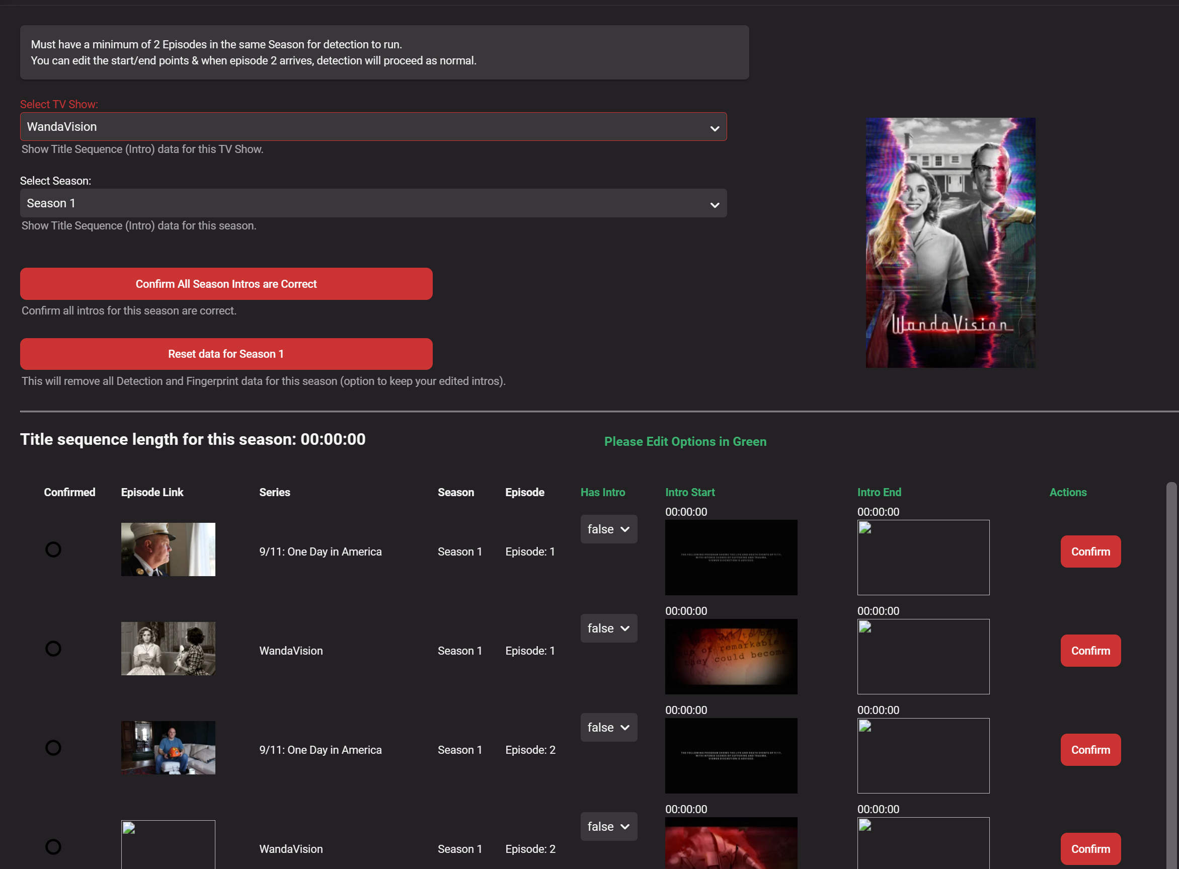

kaj 276 Posted October 15, 2021 Posted October 15, 2021 2 hours ago, rbjtech said: @kaj - The only shows that have any Intro Detections on them - are Wandavision S1 and Game of Thrones S5 - it then errors with a SQL error - meaning the reset of the shows are not being detected. This is what it shows for WandaVision, which doesn't look encouraging 1 hour ago, chef said: I just don't know. @kaj your library has some series, season and episodes I'm not sure about: This emby library entry hasn't got a season number attached. 2021-10-15 05:16:56.933 Debug Intro Skip: TV - S: - E:3: Extracting chunks from binary chroma-print. 2021-10-15 05:16:56.935 Debug Intro Skip: TV - S: - E:3: .bin file removed. That would throw intro skip for a loop because everything we do revolves around working within season. Here is another item in your library that is interesting: 2021-10-15 05:14:11.449 Info Intro Skip: FINGERPRINT: Season 1 - S: - E:1 complete - 18 seconds. Is the series called "Season1"? If so it also doesn't have a season number attached to it. Also here in GOT, some of those episodes have no index number either. 2021-10-15 08:07:57.428 Debug Intro Skip: Game of Thrones - Season 5 - E: 9 matched E: 4 - detection took 6892 milliseconds. 2021-10-15 08:08:03.708 Debug Intro Skip: Game of Thrones - Season 5 - E: 9 matched E: 5 - detection took 6279 milliseconds. 2021-10-15 08:08:09.979 Debug Intro Skip: Game of Thrones - Season 5 - E: 9 matched E: - detection took 6271 milliseconds. 2021-10-15 08:08:15.977 Debug Intro Skip: Game of Thrones - Season 5 - E: 9 matched E: - detection took 5997 milliseconds. 2021-10-15 08:08:21.946 Debug Intro Skip: Game of Thrones - Season 5 - E: 9 matched E: - detection took 5969 milliseconds. 2021-10-15 08:08:27.922 Debug Intro Skip: Game of Thrones - Season 5 - E: 9 matched E: - detection took 5976 milliseconds. 2021-10-15 08:08:39.794 Debug Intro Skip: Game of Thrones - Season 5 - E: 1 matched E: - detection took 5965 milliseconds. 2021-10-15 08:08:39.872 Debug Intro Skip: Game of Thrones - Season 5 - E: matched E: 1 - detection took 5959 milliseconds. 2021-10-15 08:08:45.785 Debug Intro Skip: Game of Thrones - Season 5 - E: 1 matched E: - detection took 5990 milliseconds. 2021-10-15 08:08:45.850 Debug Intro Skip: Game of Thrones - Season 5 - E: matched E: - detection took 5977 milliseconds. 2021-10-15 08:08:51.790 Debug Intro Skip: Game of Thrones - Season 5 - E: 1 matched E: - detection took 6004 milliseconds. 2021-10-15 08:08:51.856 Debug Intro Skip: Game of Thrones - Season 5 - E: matched E: - detection took 6005 milliseconds. 2021-10-15 08:08:57.761 Debug Intro Skip: Game of Thrones - Season 5 - E: 1 matched E: - detection took 5971 milliseconds. 2021-10-15 08:08:57.828 Debug Intro Skip: Game of Thrones - Season 5 - E: matched E: - detection took 5972 milliseconds. 2021-10-15 08:09:09.777 Debug Intro Skip: Game of Thrones - Season 5 - E: 2 matched E: - detection took 5983 milliseconds. I'm gonna to have to think about what is happening here, I'll be back soon. I've checked and don't have any show called Season1. The GOT are old files. I'm happy to delete the entire show, to see if that helps.
chef 3808 Posted October 15, 2021 Posted October 15, 2021 (edited) 8 minutes ago, kaj said: This is what it shows for WandaVision, which doesn't look encouraging I've checked and don't have any show called Season1. The GOT are old files. I'm happy to delete the entire show, to see if that helps. Actually, WandaVision didn't get scanned. We broke intro Skip at the end of GOT, before we could scan Wanda vision. So that wouldn't have intro data. It's okay! I'm gonna PM you, and we're going to figure out where exactly we are tripping up the episodes, and then You'll have awesome intro data Edited October 15, 2021 by chef 1
