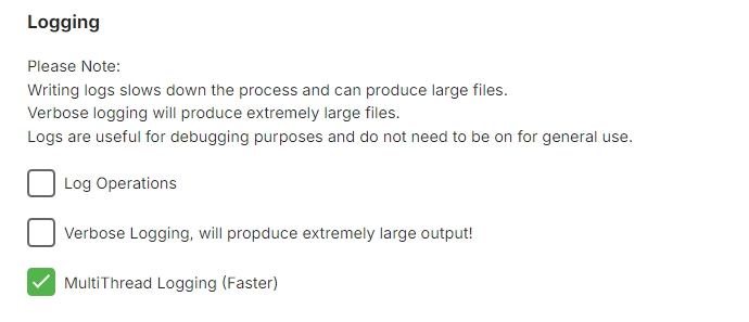

mickle026 607 Posted March 7 Author Posted March 7 if you are on windows 11, delete the VOD folder from the "CMD" window, but be careful, rmdir cannot restore if you do it wrong. Example: rmdir /q /s "D:\VODS" [Enter] This with take a couple of minutes, compared to windows taking forever.... I have found the error in the directory deletion code and corrected it. I have fixed logging verbose mode so that it writes everything, even if Log Operation is unticked. (they were 2 separate Log writing commands, verbose should be both) A few GUI description tweaks. Removed these "--------------------------------------------------------------------------------" lines from the logging, they were originally there to make it easier for me to read and debug. They are not needed anymore and taking up CPU cycles and making the log bigger than it needs to be. You might have already noticed I have also put started and completed timestamps in the log. If logging is off they should still create a log, but just with the timestamps and nothing else. I am currently testing in in full verbose mode, as we know this is much slower so it'll take a bit longer. I think this plugin is getting to be a decent addition. It still works with my own VOD m3u, and now seems like it will work with almost any.

mickle026 607 Posted March 7 Author Posted March 7 Yes, Logging is a good bit slower than without it, verbose logging is a lot slower still. Without multithreading its horrendously slow. Even if the process is finished, its all wrapped in a task that emby can monitor (I have no control over the scheduled task only triggering and progress bar), so it will wait until everything is done before reporting back to emby that it is complete. So that means even if the file is fully processed, all the OS commands are issued, any outstanding IO writes or deletes (queue) will make the task wait until they are done including log writes. I can skip this and force it, but what happens then is the task runs for 0 seconds, and all processes are running in the background, so the reporting is wrong.

mickle026 607 Posted March 8 Author Posted March 8 4 hours ago, gillmacca01 said: It has now been running for over 14 hrs and still hasn't finished The tv shows folder in VOD only has 18 folders, so I believe there must be an awful lot more to appear. If I'm right, then this is going to take well over 24 hrs Even taking into account i have slower hardware, less threads, it still shouldn't take this long, when i can add the whole m3u into live tv and have it finish in less than 2 hrs It is definitely the logging, The next dll has a very different method of logging, instead of writing at every action as it happens which it seems is causing thread locking while the CPU waits for a thread allocation permit (called a semaphore). (This was beyond me, until I spent more than a few hours reading about it, I have been up half the night!) So now I have spent a few hours more figuring out a way to get around this issue. This new version has a rewritten logging system, that stacks the log requests, then writes in batches. so instead of writing in 1kb chunks, it writes in 300kb+ chunks. Much faster logging. It reduces the IO operations for logging 300% so reduces the threads requested massively and reduces disk access, and therefore bottle neck created by the log requests. However logging might still be slower than not logging, and then again maybe not by much. (testing that) I am hoping (fingers crossed) that the new system will have a minimal impact, but running some tests. With the new logging system: standard logging: Task Duration: 00:30:54 for me when the VOD folder didn't exist using your m3u file and my ignore list. and new to this version I stacked the output into YEAR ordered folders like this: D:\VODS\TV Shows\2011\NL HBO MAX\Game of Thrones (2011)\Season 08\Game of Thrones (2011) S08 E06.strm I am just checking with no logging & then I will check with verbose. I have fixed the check and update (I believe) & I am just testing that now. (I was checking folders but not folder content in previous versions) I don't think it will be as fast as just a few minutes, because of IO operations here, but if I can get it to average 30 mins then I am happy. I am hopeful that the new logging method will reduce everything's timings to be in that range. The new version also has a number of additions. Be aware that I am still testing this version VODtoSTRMscheduledTask.dll
gillmacca01 180 Posted March 8 Posted March 8 Testing now. I have unticked all logging options, so nothing should be logged (apart from start time and maybe end time)

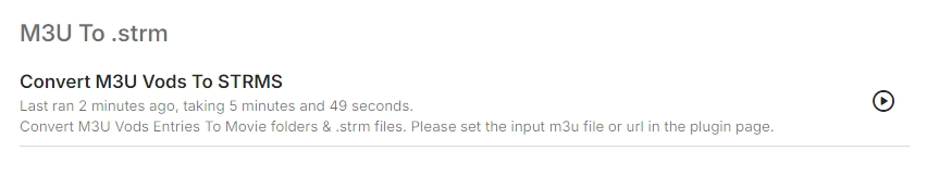

mickle026 607 Posted March 8 Author Posted March 8 No logging on at all - 5 minutes 49 seconds. I will start the verbose test now, post results later as I am off to work....

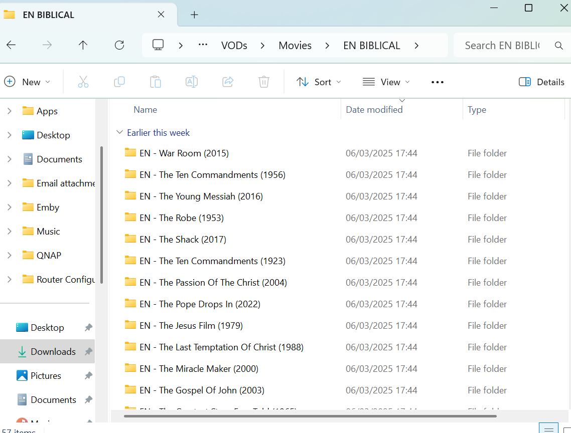

gillmacca01 180 Posted March 8 Posted March 8 (edited) Found a problem which might explain some of the issues (either a bug or I have configured the plug-in wrong. I have added EN BIBLICAL in the ignore field, but the folder and the strm files are still being created I have attached my configuration file (removed m3u link). Can someone confirm I have set the ignore up correctly Here is a screenshot of the folder for EN BIBLICAL that has been created in VODS I'm going to stop it running for now, until i get feedback VODtoSTRMscheduledTask.xml Edited March 8 by gillmacca01
