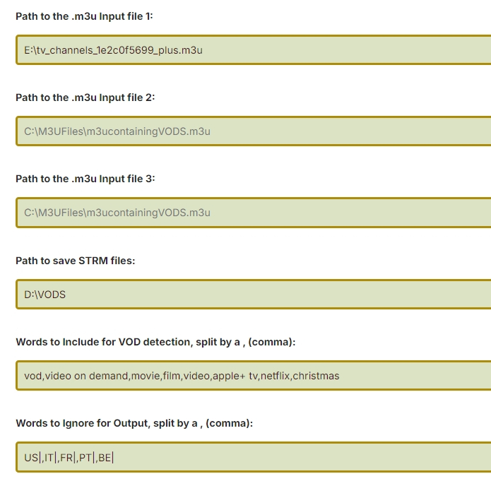

mickle026 601 Posted March 2 Author Posted March 2 (edited) Here is the latest build. This is not in post 1 yet. It now has ignore capability, and reverts away from Regex for the include words, so it takes the | pipe as part of the word (and needs it) I think this way may be more suitable for everyone. Let me know how it is functioning.. Edited March 2 by mickle026
gillmacca01 180 Posted March 2 Posted March 2 (edited) Latest build is missing the ignore part Plus still cannot download via URL Will the ignore part allow wildcards, example If I want to ignore |DE| Films & |DE| Series, etc, could I enter |DE|*? Edited March 2 by gillmacca01
mickle026 601 Posted March 2 Author Posted March 2 (edited) Try this one, it is downloading from an URL for me. The ignore is working, clear you internet cache files if you cannot see it (win 11 and edge is really weird for me) Task triggered 2nd time by Emby internally is cancelled (Gawd knows why Emby is triggering it again exactly 20 seconds after the first one, I have come across this before but Luke just said no it doesn't, but yes it does!) VODtoSTRMscheduledTask.dll Edited March 3 by mickle026
mickle026 601 Posted March 2 Author Posted March 2 (edited) 2 hours ago, gillmacca01 said: Will the ignore part allow wildcards, example If I want to ignore |DE| Films & |DE| Series, etc, could I enter |DE|*? I will have to look into how to do that, since i moved away from regex to allow the pipe | , .net string comparer does not support wildcards. That means moving back to regex ... Just so you know, currently the Ignore is an if string contains |DE| then it is ignored, so will ignore all |DE| So I probably also need a don't ignore, so you can ignore all |DE|, but allow |DE| * Sports Edited March 2 by mickle026
