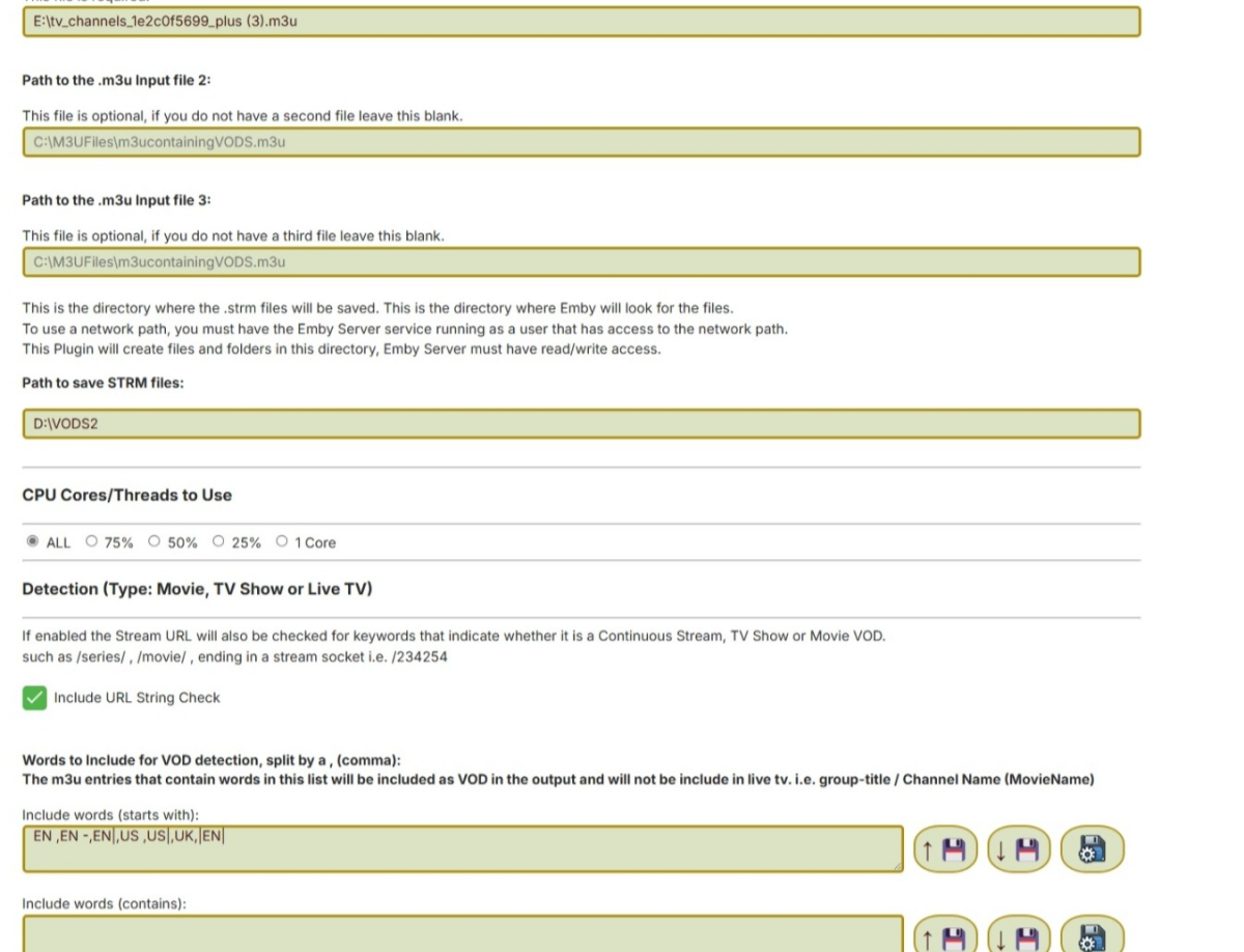

I have enabled the plugin to take 3 m3u urls or paths, but it is designed so that it can do it all from one m3u.

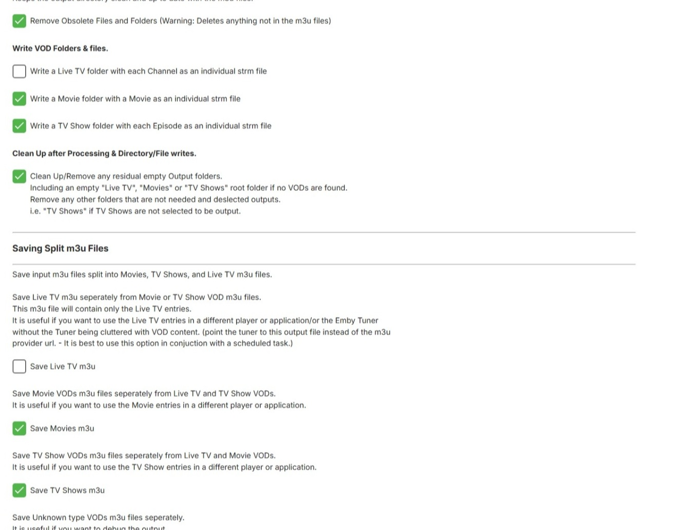

It will split the m3u into LiveTV,TV Shows & Movies, and if you set the option it will save the split m3u files.

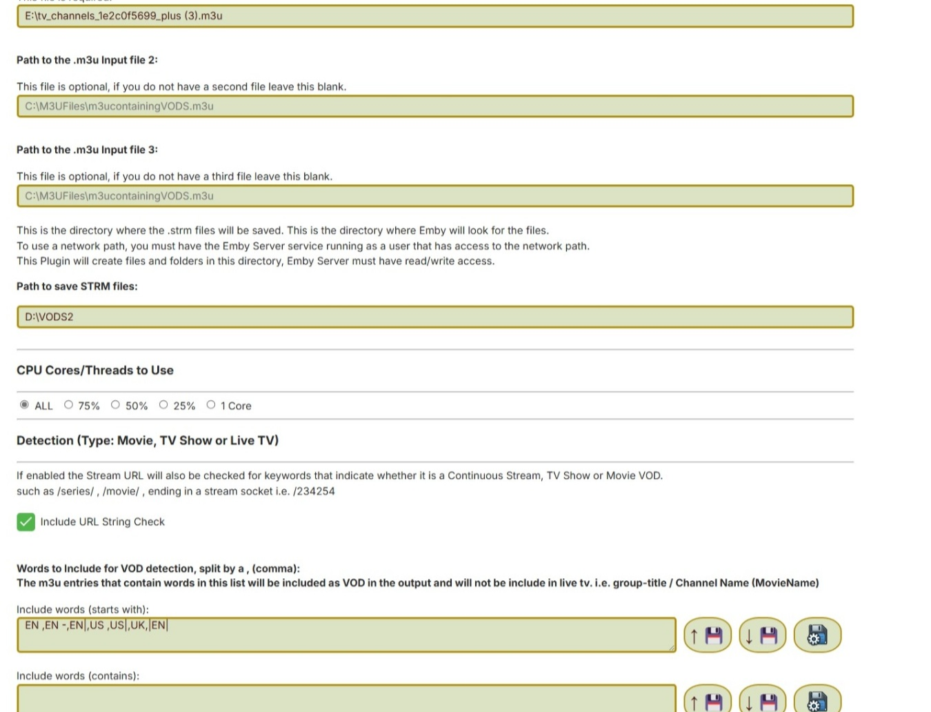

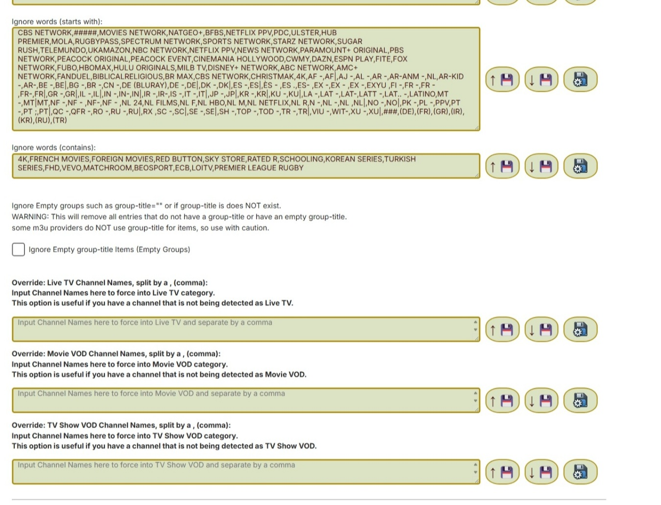

Added fields for inclusion words for VOD detection
01-03-2025
Finally got the new system to build a working DLL
Saving should be fixed
Added a textbox to allow adding your own VOD keywords

Added option to delete any folder content not in the current m3u's- i.e. obsolete entries, (previously wasn't an option)

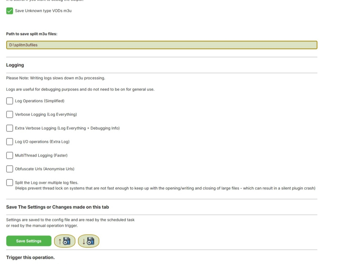

Many things converts to multi-threaded for speed increases.
Multi-threading the log is the biggest difference of all, this can reduce processing time by many HOURS if the m3u input files are large.
Not logging at all is the fastest option.

Logging can slow the operation down a huge amount, its recommended only for debugging.
Read more in the thread

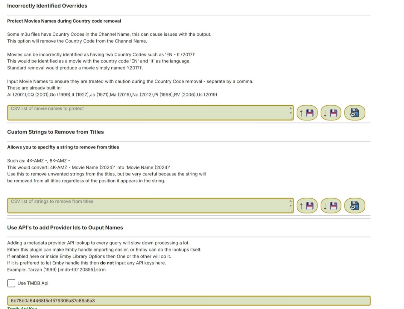

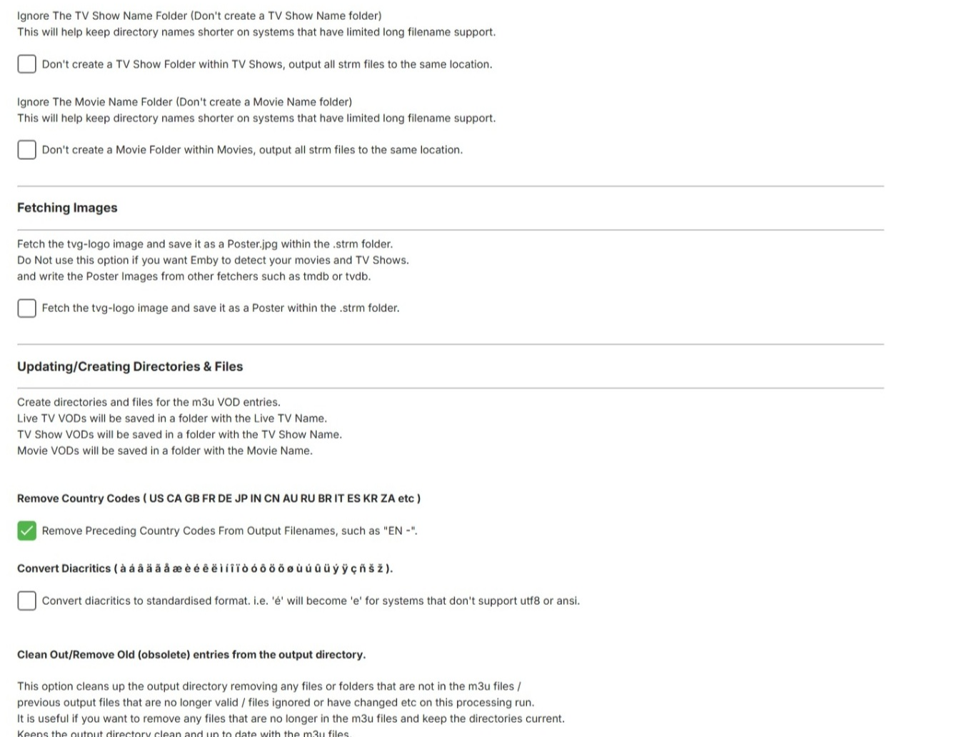

Added a section for incorrectly removed country codes when that option is selected, allowing the user to specify where the plugin is making an error and allow it to be processed as an edge-case.

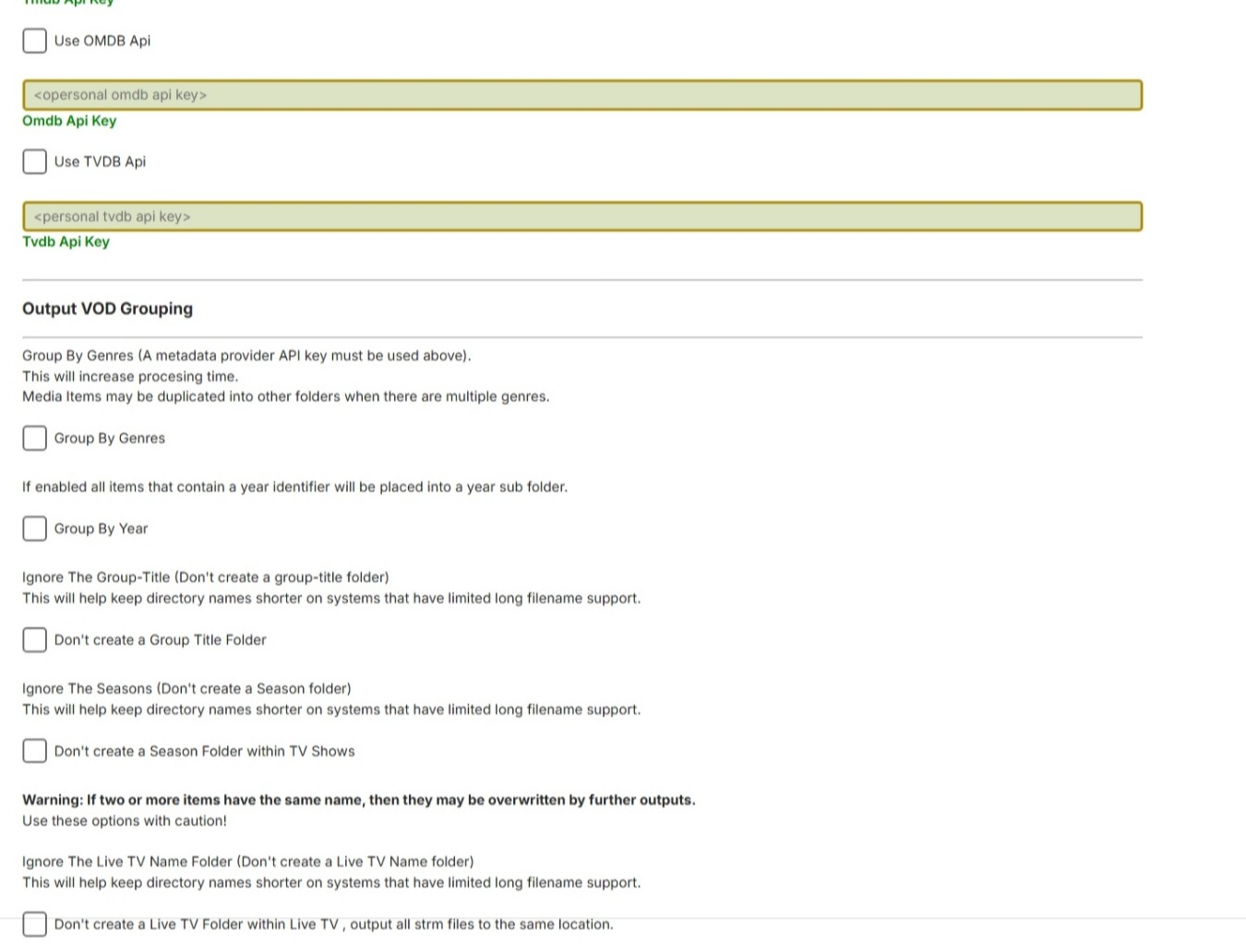

Support for tvg-title with imdb provider ids

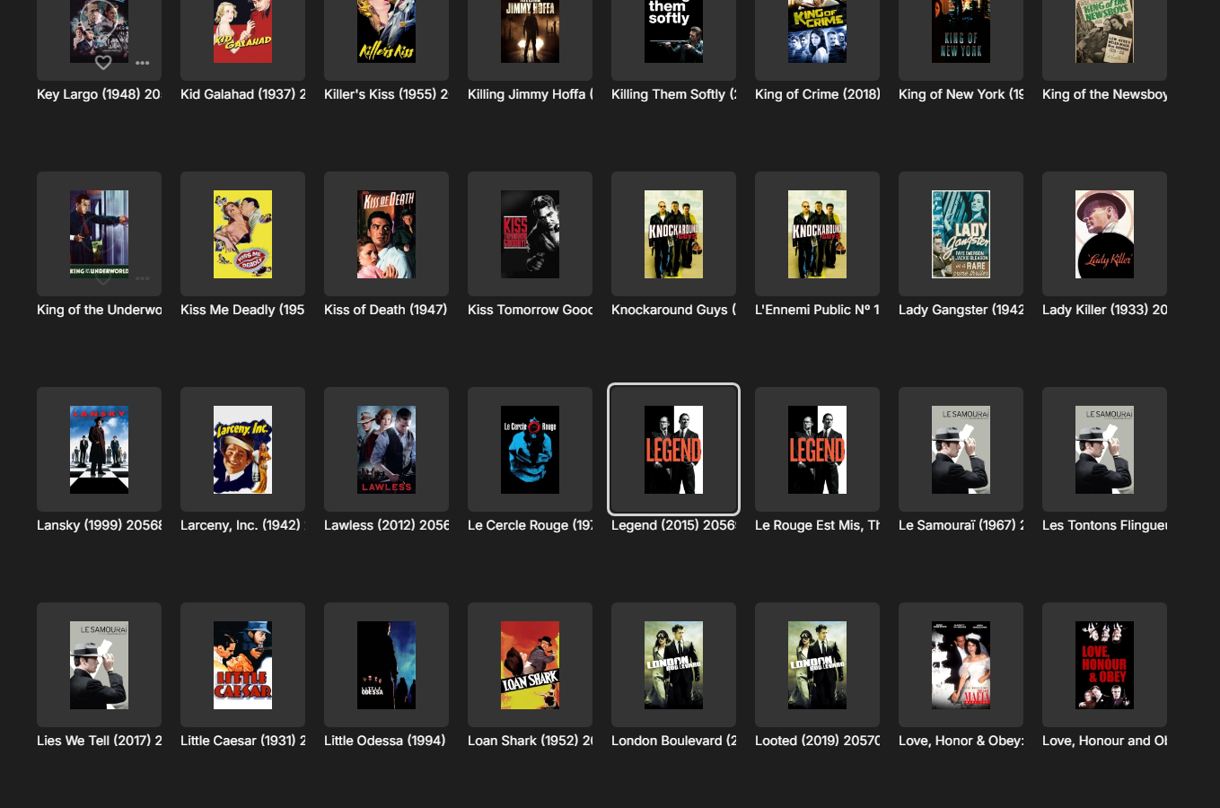

image1x1.thumb.jpg.6b2617d4c4f80e305048fa281a8c7fb7.jpgimage1x2.thumb.jpg.2c1ef2357d3876b8e5e7168b36012a51.jpgimage1x3.thumb.jpg.ead4d2ec7b04c3b0f9f5aac04cb7f345.jpg
image1x4.thumb.jpg.ee0cf2368b423f3e72218c3b8e454563.jpgimage1x5.thumb.jpg.e93d1b717d5e1aa20566a80506e95e67.jpg
image1x6.thumb.jpg.6de71d49a037b4968684439b787da495.jpgimage1x7.thumb.jpg.2ff957fd2a77e7e888e452f2eb11d289.jpgimage1x8.thumb.jpg.b10cce05479d211e1f69cb85406a64bc.jpg

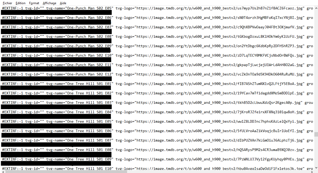

#EXTINF:-1 tvg-id="" tvg-name="A Clockwork Orange (1971)" tvg-logo="http://somesiteorother.com/images/0066921.jpg"group-title="VOD"
http://somesiteorother.com/movie/XXXXXXX/XXXXXXX/17944.mkv
Here is a sample, just copied from elsewhere in this forum.
tvg-id = tv channel id
tvg-name = tv channel name
tvg-logo = the tv logo
group-title = the subsection it belongs in, in ip-tv programs you see lists of countries or genres etc.
There can be more identifiers such as a link to a tv-guide xml file
So what I am doing, is reading the m3u file and separating Live-TV, Movies, and TV-Shows,

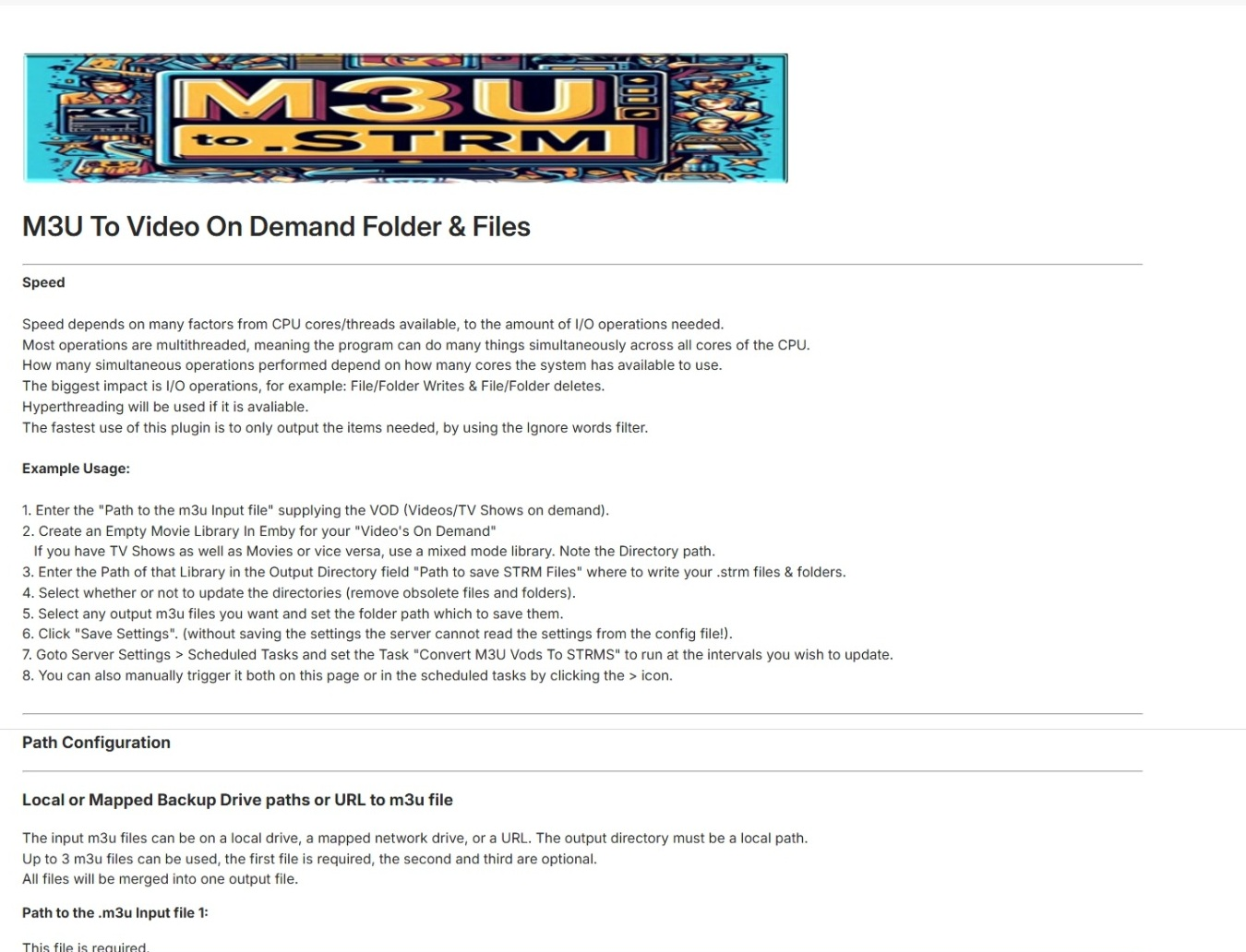

Hi how do you install on macOS?
mickle026
Copy the dll to your programdata/plugins folder and restart the server

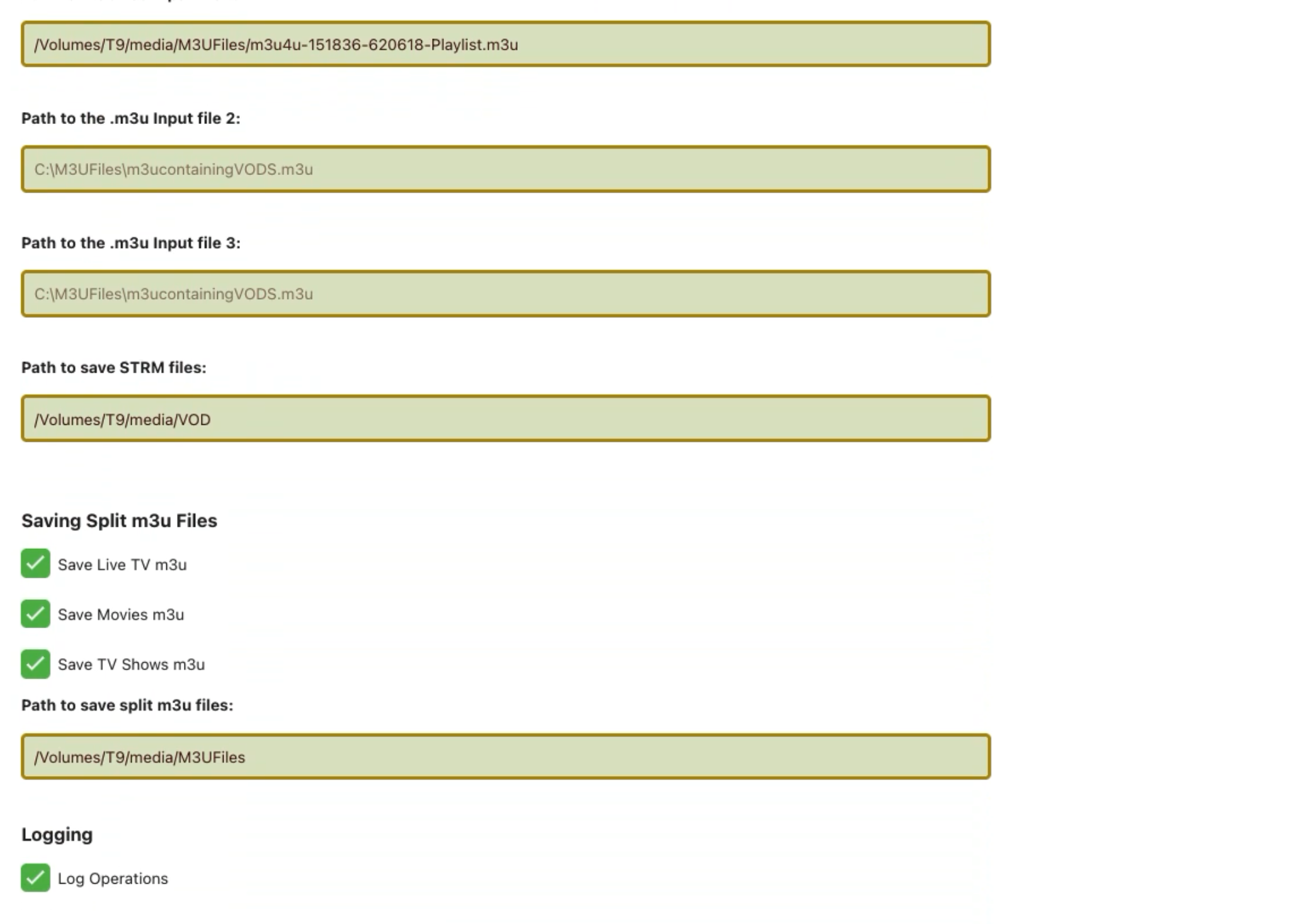

I might be an idiot. I placed the DLL in the plugins folder, installed it from the plugins section of emby and restarted the server. It appears installed but then what do I do next to use it?
Edited by BigIrn
BigIrn
Ok so on macos, there are 2 plugin folders. I put the dll in both and now I see it. However It's not working.

Not sure, but with the log saying no input files I have to ask, did you click save settings before triggering it?
Without saving settings in the web user interface, the server backend has no information written to the settings file to read from in order to do the task.

gillmacca01
Didn't work when I entered a URL (said no input file), but partially worked when adding a downloaded M3U
Presuming I have set it up correctly, it will except the downloaded M3U file and creates the folders and split M3U files, but there is nothing in the split M3U files
here are a couple of lines for the movies:
#EXTINF:-1 tvg-id="" tvg-name="NL| APPLE+ TV" tvg-logo="http://*********/piconsnew/Apple-TV-logo.png" group-title="NL| FILMS",NL| APPLE+ TV
http://line.myox.me:80/*******/1569086
#EXTINF:-1 tvg-id="" tvg-name="EN - Kinda Pregnant 4K (2025)" tvg-logo="http://*****/stalker_portal/screenshots/185/18468.jpg" group-title="4K NETFLIX MOVIES",EN - Kinda Pregnant 4K (2025)
http://line.myox.me:80/movie/******/1792483.mkv
The stars have just replaced the web address and username
I have attached the log file
ScheduledTask-[M3UToStrm]28.Feb.2025 - 14.03.58.txt
Edited by gillmacca01
mickle026
Try this build
@gillmacca01, @Kcircuit
Errornous build removed
Added code to ignore lines with EXTGRP,
Added code to include "vod|video on demand|movie|film|video|apple+ tv|netflix" as vods
Added code to log m3u Url Schema validation checks
Edited by mickle026
gillmacca01
This build isn't working at all.
It is not appearing under plugins and under Scheduled tasks, it is not showing anything (not listed)
gillmacca01
17 minutes ago, mickle026 said:
Try this build
VODtoSTRMscheduledTask.dll
apple+ and netflix are just 2 examples. I have many more.
Maybe we need a section in the plugin, where we can add extra ones, otherwise we are going to have to keep asking you to add news ones (if new ones are added by the provider), also there are some VOD folders that I don't want to see (e.g. Bollywood)
