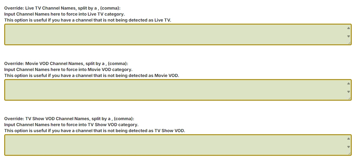

mickle026 604 Posted March 3 Author Posted March 3 (edited) Here is the latest build, I am back at work tomorrow for most of the week, so wont get a lot of time this week. However I will do what i can. This is detecting VOD better, and sorting between MOVIE and TV SHOW better, this should also allow URL's that end : &type=m3u_plus&output=ts Let me know if it resolves the issues so far VODtoSTRMscheduledTask.dll I am aware of this mis detection: 03.Mar.2025 - 19:44:12 channelName: SOC - Real Sociedad - Barcelona 10.11.2024 03.Mar.2025 - 19:44:12 logoUrl: 03.Mar.2025 - 19:44:12 Processing [59361]..Item Name: SOC - Real Sociedad - Barcelona 10.11.2024 03.Mar.2025 - 19:44:12 Checking: #EXTINF:-1,SOC - Real Sociedad - Barcelona 10.11.2024 03.Mar.2025 - 19:44:12 Checking: http://*******************/1216223.mkv 03.Mar.2025 - 19:44:12 Item [59361] Sanitized Channelname: SOC - Real Sociedad - Barcelona 10.11.2024 03.Mar.2025 - 19:44:12 Item [59361] Type: - Year Not Detected in the Channel Name. 03.Mar.2025 - 19:44:12 Item [59361] Type: Movies - Detected movie file extension: .mkv 03.Mar.2025 - 19:44:12 Item [59361] Season: 10, Episode: 11, Type: TV Shows 03.Mar.2025 - 19:44:12 Item [59361] Adding to internal TV Show VOD List Currently being detected as a Season and Episode, these values are not written out though, so should this be a tv show or a movie type? The file extension is detected first to make it a movie type, but then the Season Episode detection is overriding and changing it to a tv show type, what do you think? Well you also now have the option to put the channel name and override the detection to force it into a category too. Edited March 3 by mickle026
mickle026 604 Posted March 4 Author Posted March 4 Last build for now, There was an error in the previous build outputting the split m3u files, it has been resolved. I think this one is all good, but I haven't tested the override option boxes yet. VODtoSTRMscheduledTask.dll
