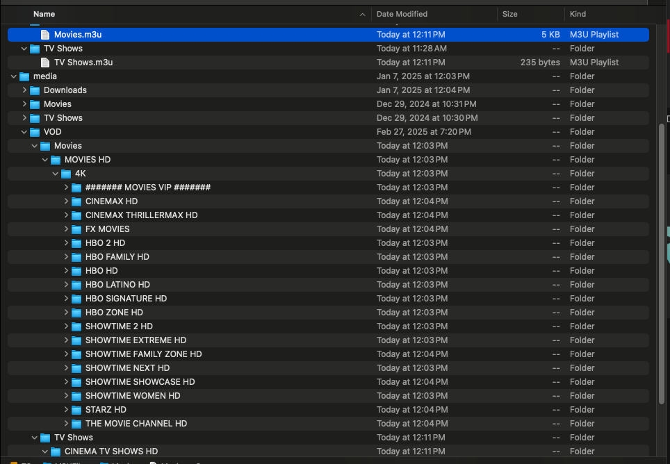

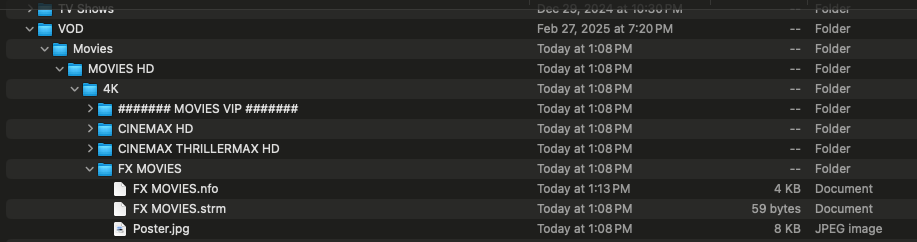

Ok now it runs with no errors after adding gobbledegook to ignore but it's only capturing Live TV in the m3u folder and nothing in the stream folder (I assume that's obvious?).
TV Shows and Movies m3u are 0 kb and folders are empty.
ex:
#EXTINF:-1 tvg-id="(no tvg-id)" tvg-name="CM NETFLIX 1 4K" tvg-logo="http://logo.protv.cc/piconsnew/cinemania.jpg" group-title="CINEMA TV SHOWS HD/4K",CM NETFLIX 1 4K
http://cf.go4k.me:80/live/REDACT/REDACT/696324.ts
It does not appear in the log.
ScheduledTask-[M3UToStrm]03.Mar.2025 - 11.42.56.txt

So instead of the movie it shows this:
mickle026
I am still at a loss of what you mean.
What am I looking at? Is FX Movies wrong? If so what should or do you expect it to be?
The strm file will contain the link to the movie, emby should pick up that folder , which it looks like it has because there is an .nfo file
So, are these actually live tv channels?
BigIrn
