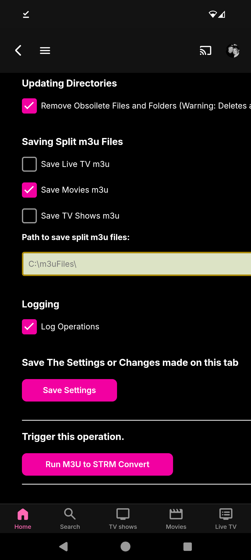

gillmacca01 180 Posted March 1 Posted March 1 4 minutes ago, gillmacca01 said: Message sent Just sent you screenshots of my settings, incase I have set it wrong
mickle026 601 Posted March 1 Author Posted March 1 Got everything. I will look into it and get it all working asap.

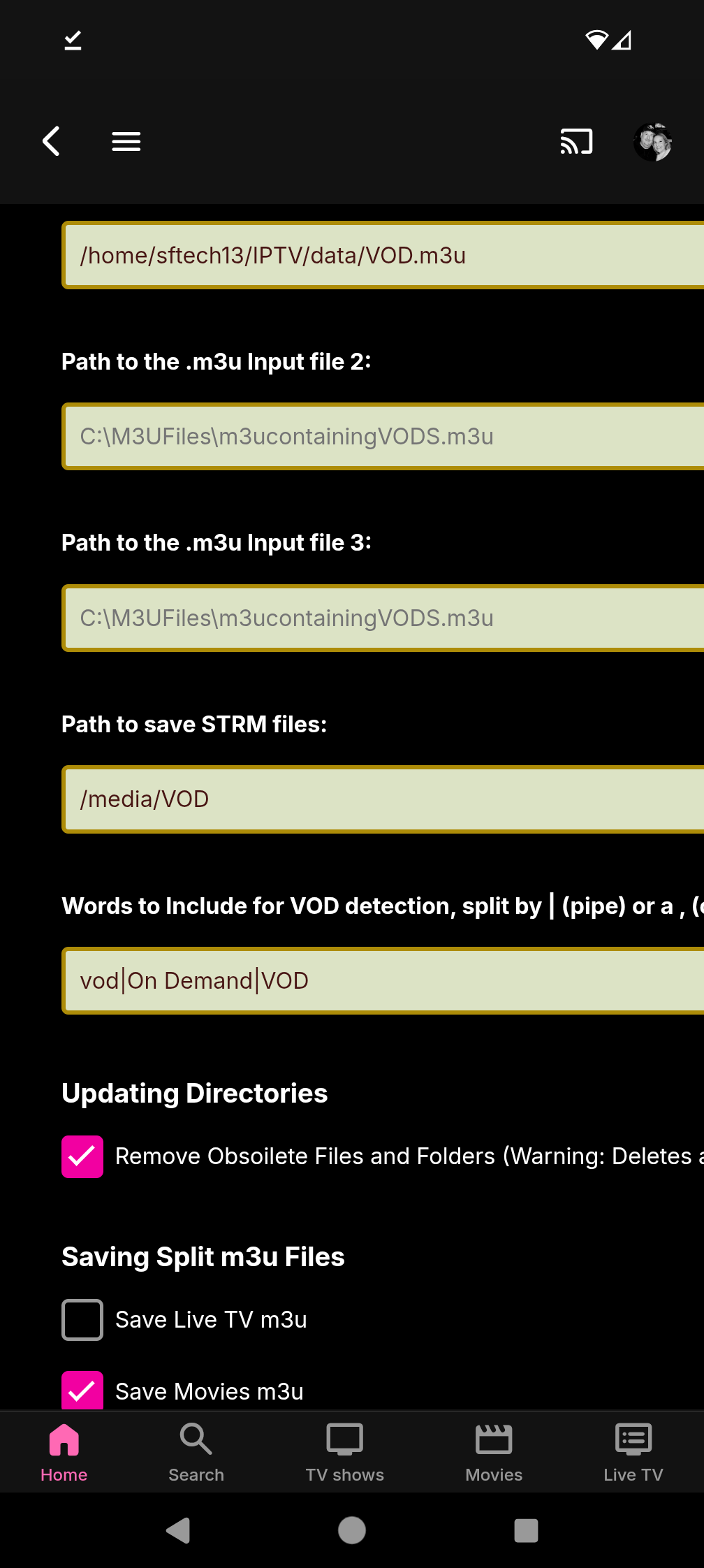

sftech13 21 Posted March 1 Posted March 1 (edited) @mickle026 I'm using Ubuntu and it doesn't seem to be working. Using latest dll in 1st post Log attached and screenshot. ScheduledTask-[M3UToStrm]01.Mar.2025 - 13.00.23.txt Edited March 1 by sftech13
