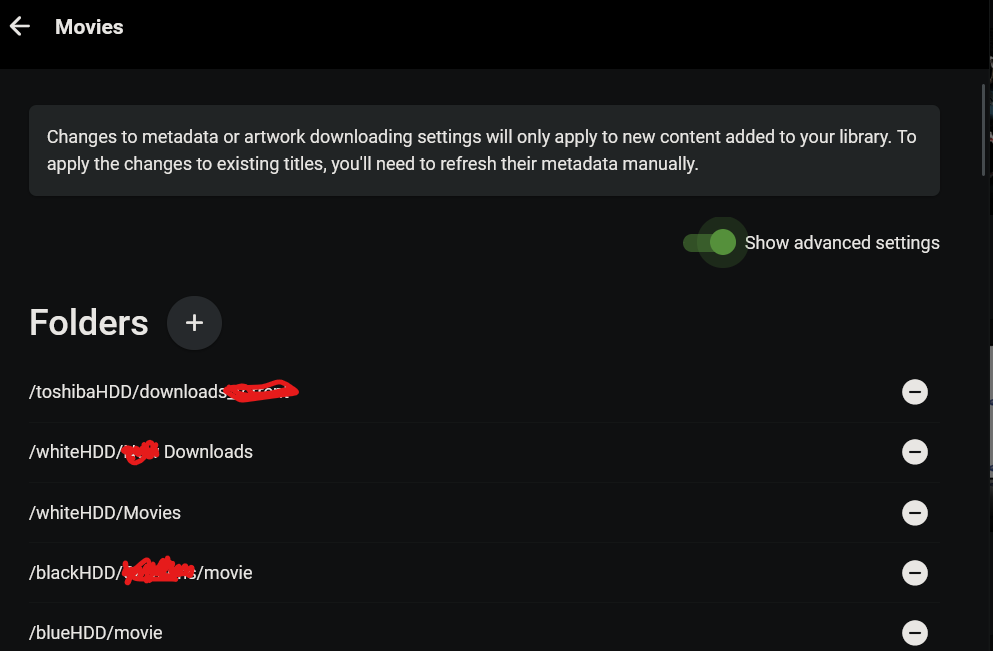

3 minutes ago, Darkseidd said:
yeap i rmb you ran emby docker on synology.
i dont use default path except /config. User permission is no issue since i'm using qbit to download just fine. and also using the same username to access smb share via my winPC & android
this is my docker compose :
version: "2.1"
services:
  emby:
    image: lscr.io/linuxserver/emby:latest
    container_name: emby
    environment:
      - PUID=1001
      - PGID=100
      - TZ=Asia/Singapore
    volumes:
      - /srv/dev-disk-by-uuid-bbc1f360-c89a-4600-839a-3dde7645de18/whiteSSD/AppConfig/emby:/config
#     - /path/to/tvshows:/data/tvshows
#     - /path/to/movies:/data/movies
      - /srv/dev-disk-by-uuid-76b61cab-b409-4cb0-8358-9ca778e71788/toshibaHDD:/toshibaHDD
      - /srv/dev-disk-by-uuid-35755813-de7e-49c4-a129-694966b527ae/whiteHDD:/whiteHDD
      - /srv/dev-disk-by-uuid-5c047584-4a24-471a-abcf-325edbe3acad/blackHDD:/blackHDD
      - /srv/dev-disk-by-uuid-35e39203-8f9e-48e7-b0f7-6ec5fb33f21d/redHDD:/redHDD
      - /srv/dev-disk-by-uuid-3260cb13-e651-404f-9b51-9bc94339e30d/purpleHDD:/purpleHDD
      - /srv/dev-disk-by-uuid-ce2002f9-a335-492c-8691-ab2b1fd55555/blueHDD:/blueHDD
#      - /opt/vc/lib:/opt/vc/lib #optional
    ports:
      - 8096:8096
      - 8920:8920
#    devices:
#      - /dev/dri:/dev/dri #optional
#      - /dev/vchiq:/dev/vchiq #optional
#      - /dev/video10:/dev/video10 #optional
#      - /dev/video11:/dev/video11 #optional
#      - /dev/video12:/dev/video12 #optional
    restart: unless-stopped
this is *example* how folder looks at my library setting. all runs well for multiple users from internal and external
My OMV is a custom built PC but that doesn't matter. As long as your sorted container path wise it should work.. strange.. Are you still running a raspi?

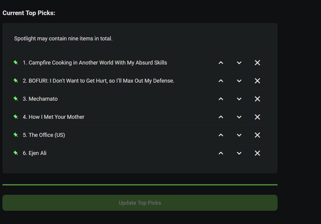

manual top picks , with tvshow that i know works, in mix with tvshow i know didnt worked
embyserver(4).txt

Okay, I can follow that error I think.
Jinny's kitchen gets it's NFO file but immediately fails right after.
Brb.
