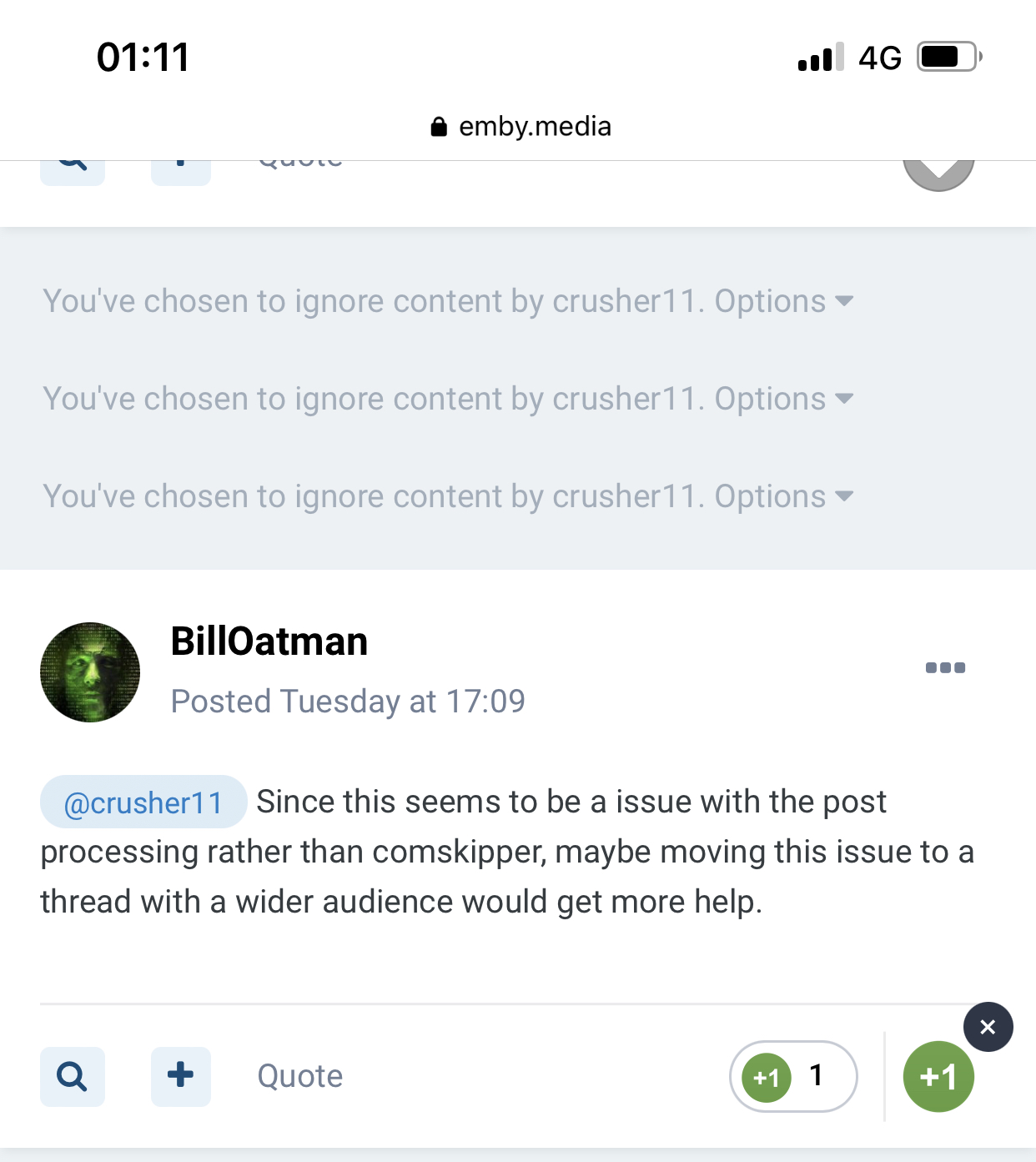

Cheesegeezer 3102 Posted September 29, 2022 Posted September 29, 2022 (edited) A picture paints a thousand words! Disclaimer: This is all my account that displays those content curtains. Bill you are the best and I love our wee niche cheeky dev group. Chin up fella Edited September 29, 2022 by Cheesegeezer
crusher11 979 Posted September 29, 2022 Posted September 29, 2022 3 hours ago, Cheesegeezer said: A picture paints a thousand words! Disclaimer: This is all my account that displays those content curtains. Bill you are the best and I love our wee niche cheeky dev group. Chin up fella Could someone please tell Cheese to stop acting like a toddler?
