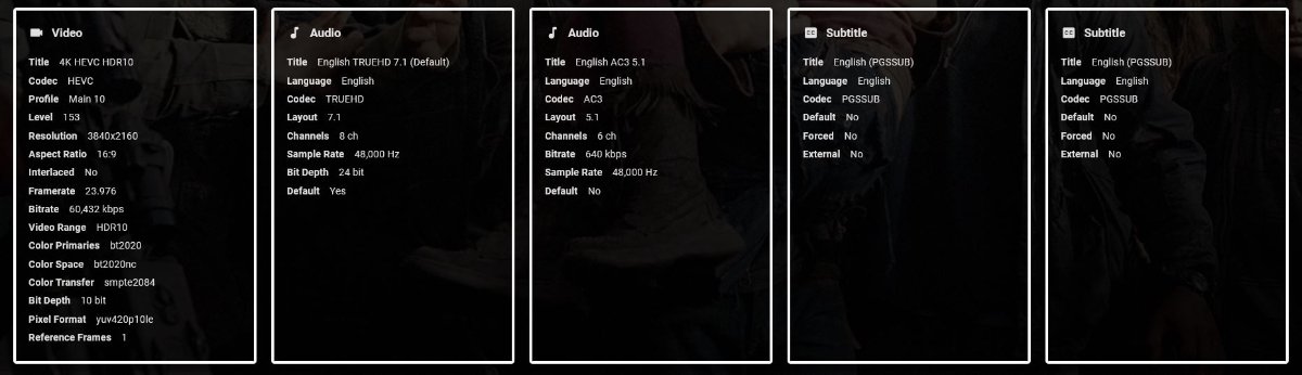

roaku 836 Posted January 30, 2021 Author Posted January 30, 2021 (edited) 6 minutes ago, arrbee99 said: While playing, if I pick Type for Property Key, what kind of thing do I put in Property Value (if anything) to just see if it works ? 'Video' or 'Audio' will work. They should match just about everything... You can narrow it down by using Type 'Audio' then adding another property to match "Codec" to "H264" or "AAC", for example. MediaStream works, but is a bit of a free for all right now that needs more documentation. You can experiment and the worst that will happen is that Iconic will fail and you'll just get back the unmodified image. Edited January 30, 2021 by roaku

roaku 836 Posted January 31, 2021 Author Posted January 31, 2021 1 hour ago, arrbee99 said: So I'm at Add Media Stream Rule, where does Video and 3840 go ? The only box that has a drop down list is Property Key and that only has (among others) Type and Video Range. Does Property Value come into it somewhere ? If you download the updated Beta in the link below, you should now get the Resolution property option in the dropdown I thought was already there and it should work like I thought it already did. Just a reminder though, for the betas, if you match more than one rule, you'll only see the Icon for the first matched rule on all badges.
