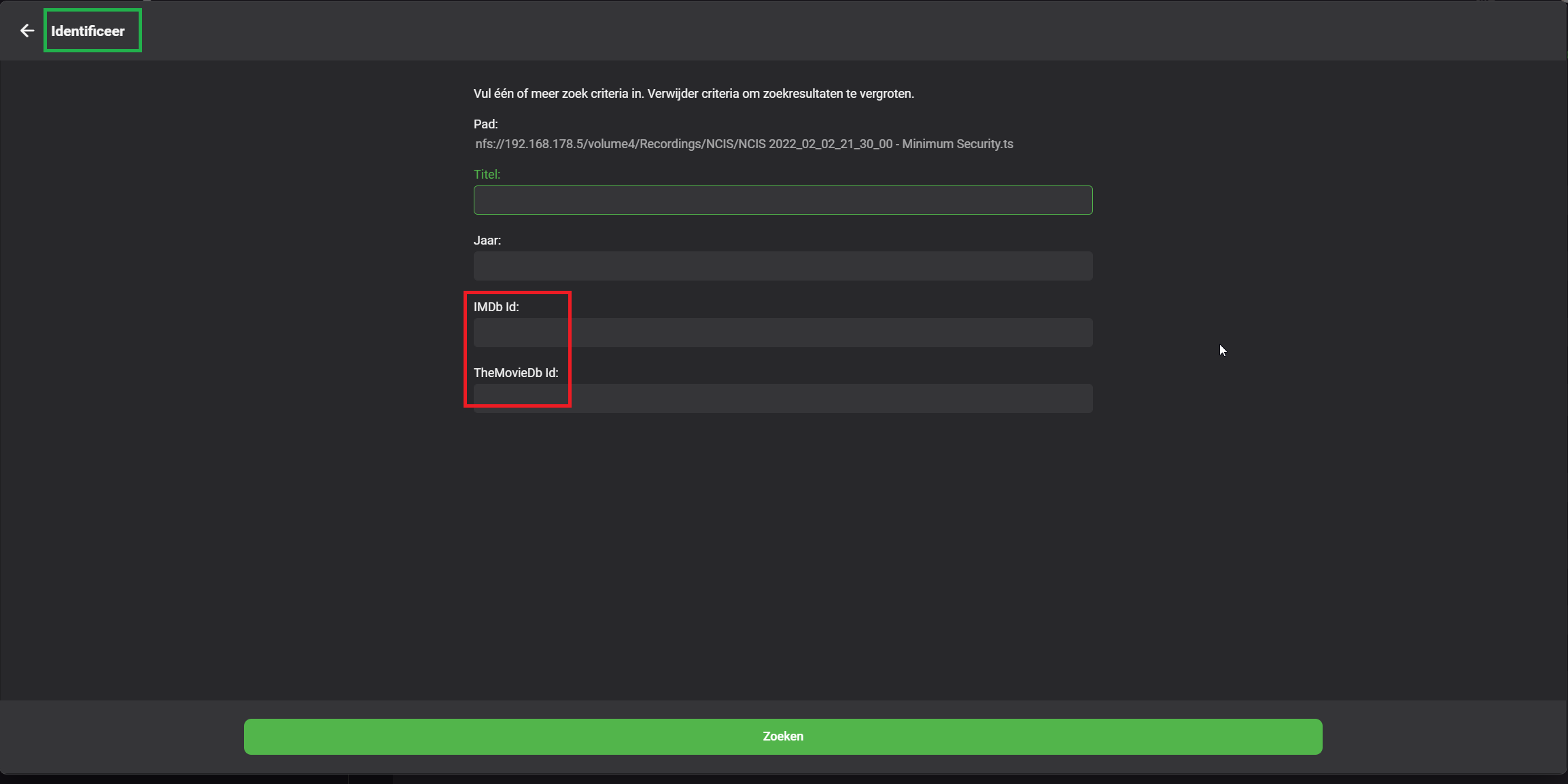

heula 192 Posted February 2, 2022 Posted February 2, 2022 New test to show you what I see. 3 new test recordings are recording now. Visible in Emby and Plex but not in Kodi Next Gen. Not in recorded tv shows and not in recorded movies. (Why can't they be combined in just one Recorded library item like in Emby itself?) kodi.log
quickmic 1607 Posted February 2, 2022 Author Posted February 2, 2022 (edited) 1 hour ago, heula said: New test to show you what I see. 3 new test recordings are recording now. Visible in Emby and Plex but not in Kodi Next Gen. Not in recorded tv shows and not in recorded movies. (Why can't they be combined in just one Recorded library item like in Emby itself?) kodi.log 168.71 kB · 0 downloads Well, Kodi has no database for recordings. You can leave them unsynced and use dynamic lists or you sync them. If synced it needs to fit in some Kodi understandable category. Movies, TVSHows, Musicvideos, Music is possible to sync to Kodi. Emby server categorized the recordings and send this info for rec content: - Type: Recording - MediaType: IsSeries If Recording has "IsSeries" metadata, the plugin treats it like a TVSHows. A Kodi TVShow requires mandatory Series info. Season is optional as far as I know. I think that's what causes the issue. Series info not available when the new episode was pushed via realtime update to Kodi. The Series info was pushed after the episode. Anyway, yes I can treat all recordings as movies and ignore the MediaType. In this case, the issue should not appear. That's why I asked, if you set up Emby server that all your recordings are movies (at least as a test). Also only realtime updates are affected. A complete sync or setting back the sync date will sync the content correctly. At this point, Emby server assigned for the recorded Episodes a Series and Kodi/plugin is happy. I ASSUME Emby server sends the realtime (new episode) notification right after recording was started or immediately after recording finished. At this point, Emby server hasn't updated all crosslinks. Also a possible option would be, sync recordings ALWAYS on Kodi start again (due to "special" startup timestamps -> same as for boxset updates. But the realtime update issue as it is, cannot be fixed on plugin side. A sophisticate analyses of Emby server realtime msgs/timing etc with multiple test cases are required. Following is just one test case identifing the EXACT issue and probably talk with the Emby devs. What if a series exists (due to previous recordings of the same show) and just the episode was new. This would verify if the series itself was missing at the point the new episode info was published (via Websocket) or it's just an issue with the assignment of the episode. Edited February 2, 2022 by quickmic
quickmic 1607 Posted February 2, 2022 Author Posted February 2, 2022 6 minutes ago, quickmic said: Well, Kodi has no database for recordings. You can leave them unsynced and use dynamic lists or you sync them. If synced it needs to fit in some Kodi understandable category. Movies, TVSHows, Musicvideos, Music is possible to sync to Kodi. Emby server categorized the recordings and send this info for rec content: - Type: Recording - MediaType: IsSeries If Recording has "IsSeries" metadata, the plugin treats it like a TVSHows. A Kodi TVShow requires mandatory Series info. Season is optional as far as I know. I think that's what causes the issue. Series info not available when the new episode was pushed via realtime update to Kodi. The Series info was pushed after the episode. Anyway, yes I can treat all recordings as movies and ignore the MediaType. In this case, the issue should not appear. That's why I asked, if you set up Emby server that all your recordings are movies (at least as a test). Also only realtime updates are affected. A complete sync or setting back the sync date will sync the content correctly. At this point, Emby server assigned for the recorded Episodes a Series and Kodi/plugin is happy. I ASSUME Emby server sends the realtime (new episode) notification right after recording was started or immediately after recording finished. At this point, Emby server hasn't updated all crosslinks. Also a possible option would be, sync recordings ALWAYS on Kodi start again (due to "special" startup timestamps -> same as for boxset updates. But the realtime update issue as it is, cannot be fixed on plugin side. A sophisticate analyses of Emby server realtime msgs/timing etc with multiple test cases are required. Following is just one test case identifing the EXACT issue and probably talk with the Emby devs. What if a series exists (due to previous recordings of the same show) and just the episode was new. This would verify if the series itself was missing at the point the new episode info was published (via Websocket) or it's just an issue with the assignment of the episode. I'll try to sync recordings again on Kodi startup, no matter if they are already pusblished via realtime updates. I hope this will work/is possible. (this is something for 7.X) 1

heula 192 Posted February 3, 2022 Posted February 3, 2022 (edited) 20 hours ago, quickmic said: Well, Kodi has no database for recordings. You can leave them unsynced and use dynamic lists or you sync them. If synced it needs to fit in some Kodi understandable category. Movies, TVSHows, Musicvideos, Music is possible to sync to Kodi. Emby server categorized the recordings and send this info for rec content: - Type: Recording - MediaType: IsSeries If Recording has "IsSeries" metadata, the plugin treats it like a TVSHows. A Kodi TVShow requires mandatory Series info. Season is optional as far as I know. I think that's what causes the issue. Series info not available when the new episode was pushed via realtime update to Kodi. The Series info was pushed after the episode. Anyway, yes I can treat all recordings as movies and ignore the MediaType. In this case, the issue should not appear. That's why I asked, if you set up Emby server that all your recordings are movies (at least as a test). Also only realtime updates are affected. A complete sync or setting back the sync date will sync the content correctly. At this point, Emby server assigned for the recorded Episodes a Series and Kodi/plugin is happy. I ASSUME Emby server sends the realtime (new episode) notification right after recording was started or immediately after recording finished. At this point, Emby server hasn't updated all crosslinks. Also a possible option would be, sync recordings ALWAYS on Kodi start again (due to "special" startup timestamps -> same as for boxset updates. But the realtime update issue as it is, cannot be fixed on plugin side. A sophisticate analyses of Emby server realtime msgs/timing etc with multiple test cases are required. Following is just one test case identifing the EXACT issue and probably talk with the Emby devs. What if a series exists (due to previous recordings of the same show) and just the episode was new. This would verify if the series itself was missing at the point the new episode info was published (via Websocket) or it's just an issue with the assignment of the episode. Most of my recordings are existing tv shows so they are added as a serie. Non existing recordings are always added as a movie in Kodi and I really hate that. Isn't there a way to add a tag to each recording that it is a serie. Than all my recordings will be placed in just one folder in Kodi. Non existing recordings also do have a problem with getting the right tv show id within Emby because there is no option to identify tv shows in the metadatamanager. To have that option available for TV shows I need to delete the created nfo file wich is a movie nfo file. If all recordings are added as a tv show (serie) than it has a better chance to find the right info from thetvdb in my opinion because now it searches for movies info and that is always the wrong info. When a tv show is added with the wrong info I can easily adjust it within the metadatamanager by identifying the right tv show. The option to sync the recordings at startup would be nice but when I open my Shield TV Kodi is not always shut down and I go on where I left off. Is it possible to sync when this happens also? If not I still like the direct button to sync my recordings library to do it manually. Thanks. Edited February 3, 2022 by heula
