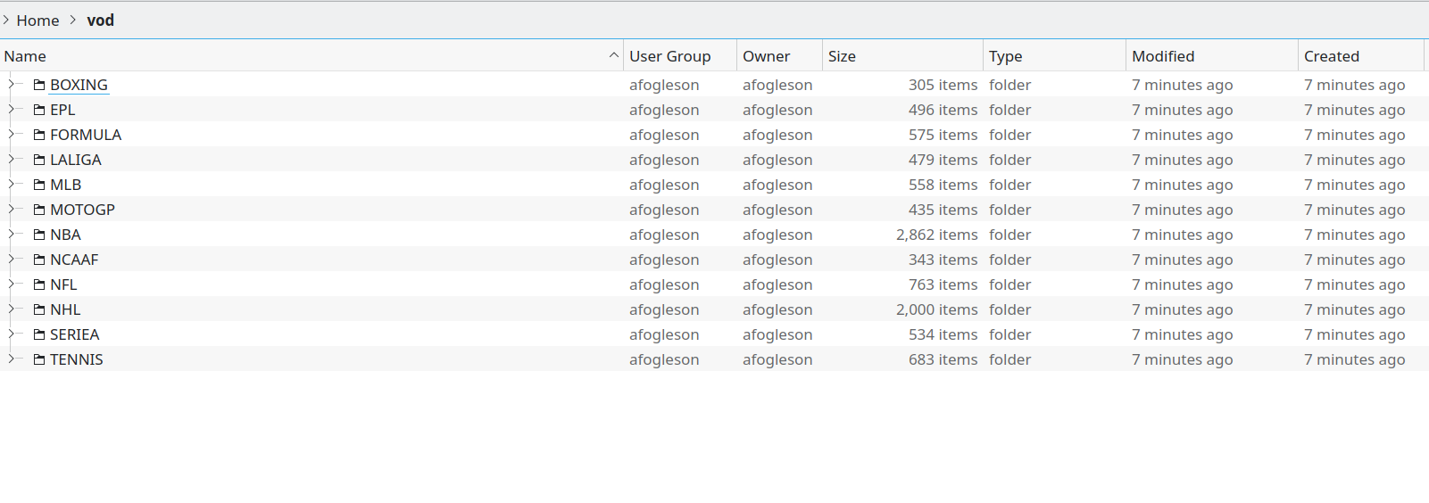

afogleson 13 Posted July 29, 2022 Posted July 29, 2022 10 hours ago, gillmacca01 said: I'm using apollo, and all 3 event m3u files. I get other java errors with the event_2 and event_3, which I believe maybe due to the space issue OK i have just tested this locally... So just in case there is some difference between what i have locally and what you have i have attached the program again. I have also attached the file i used to produce my stream files (of course you would need to replace your email / password but you can see i am using all 3 streams also) and a picture of the options i selected on the UI to do this. (please note that NOT all of the options are available in even the help menu as some of those are features I am working on a tthe moment. but if i do all that i get a LOT of stream files Finally if using from the command line here is what i call to do this (using the same setup as in the ui picture) and i get 10033 streams created CreateStreams-1.0/bin/CreateStreams -i false -n /home/afogleson/Videos/SportVOD.m3u -o /home/afogleson/vod -u true The interesting thing to note about the way that apollo does Sport VOD is that using -u true or false changes nothing. it always will group them into folders by event type. but everything does seem to be working CreateStreams-1.0.zip SportVodExample.m3u 1
gillmacca01 180 Posted July 29, 2022 Posted July 29, 2022 (edited) hmmmm....interesting. I was missing a couple of jar files, and now things have improved, but a couple of things. Your saying your get 10033 streams, I'm only getting 9963 (strm files are now being created successfully) Still looks like I am missing some sport categories: WWE, UFC, UEFA & UFC FN - IGNORE THIS, LOOKS LIKE THERE ARE MORE M3U FILES NOW Never seen the M3U Handler window (although I don't think I need it) Still getting java errors - I have attached a txt file with the java error messages I am getting from the CMD window javaerror.txt Edited July 29, 2022 by gillmacca01
afogleson 13 Posted July 29, 2022 Posted July 29, 2022 Just now, gillmacca01 said: hmmmm....interesting. I was missing a couple of jar files, and now things have improved, but a couple of things. Your saying your get 10033 streams, I'm only getting 9963 (strm files are now being created successfully) Still looks like I am missing some sport categories: WWE, UFC, UEFA & UFC FN Never seen the M3U Handler window (although I don't think I need it) Still getting java errors - I have attached a txt file with the java error messages I am getting from the CMD window javaerror.txt 52.12 kB · 0 downloads if you start the program with NO options it will show the UI screen. weird that I dont see the errors on pipe characters. of course a pipe char is a valid character on a linux system. but i suspect that is why you do not get 10033 entries Let me look at my clean path function and see if i can fix that quick
