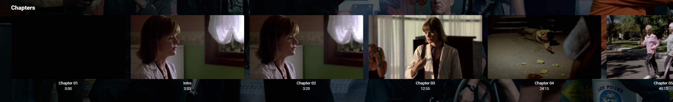

So going back to the issue - here is an example of the challenge -
The Plugin has found Intro points in the following file - Breaking Bad s01e03
So IntroStart = 03:03, IntroEnd = 03:21
The original MKV and thus Emby has the chapter points listed as -
From the Emby 'chapter dB' - extracted from the MKV

This displays as -
Chapter 1 - Is from 0:00 to 03:20.825
So Chapter 2 is actually the END of the Intro - Great
But I don't want to skip directly to Chapter 2, because I'll be missing the first 3 minutes of the episode.
So I'm going to ADD/INSERT the 'Intro' chapter point.
It now looks like this -
(I'm not sure why the thumbnail is the same, need to look into that..)
So I play from the Start - as soon as I get to the 'Intro' chapter START (03:03) - I am in the Intro Chapter.  Ideally yes, it should then prompt me on the screen with a 'Skip Intro' button, but we don't have that, so the next best thing is just to 'skip to the next chapter'.  So we do that - and we are now @ 3:21 - which happens to also be Chapter 2
If the next chapter point was an auto generated point @ say 05:00 - then we need to re calculate the points FROM 03:21 - otherwise when you skip to next chapter - you will miss the time inbetween 03:31 and 05:00.
These are the issues we need to understand and get right ..

Yes, this has been taken into account.
If the show has no intro (which is possible, ie. Mr. Robot) then the entry is marked as HasSequence = false.
If the intro is too short,  we ignore it.  The option to skip wouldn't show.
As long as the intro appears within the first 15 minutes of a sitcom, or 20 minutes of any show longer then the length of a sitcom,  we'll find it
The detection algorithm doesn't use chapters :)
It's pretty cool  how we were able to do it  :)
You can see here, that we were able to detect the intro for Archer season 1 episode 1, and there was obvious story line prior to the title sequence starting :)
Edited by chef
