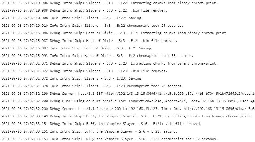

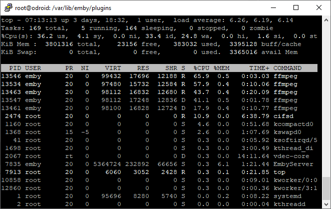

So I thought I'd be brave and try this on my main setup :D.
My setup is Headless Linux Server on an Odroid, connecting to media stored on a Windows 'NAS' (old hp microserver) via a gigabit switch.
It's been just over an hour and it's done 4.9%, so just under a day total I'd expect. I have debug logs on and everything seems good so far- not sure what the "standard" speed everyone else is getting with the latest version, but if anyone has Sliders, Hart of Dixie, or Buffy they can compare :D.
I'm not sure on whether 4 concurrent streams are best for my particular setup, as it runs fairly hot and doesn't seem to match 1 ffmpeg to 1 core. Interestingly, as you can see from the below, I seem to have 5 ffmpeg instances running when doing this.
2021-09-06.png.055aae3cc6c15336f6cbd0f19c47ac75.png44907606_2021-09-06(1).png.52a5c991e3a2089dc7a87b901174227b.png

Very interesting outcomes here. Thank you for taki g the time.
58s is a little long, but it could be the processor trying hard to keep up with encoding 5 at a time.
The encodings are successful, so this is a good thing.
It will be interesting to see how the sequence task executes.
I'm not sure how smart we want to try and make the plugin, but we could set try and default processes based on CPU.
Im just wondering if the CPU would take 58s doing 5 encodings at a time, it might be faster to encode a small amount at once. Maybe 2 or 3.
Doing 2 or 3 at once at a 9s encoding would speed things up.
This is exactly what I found @chef - lowering the number of parallel tasks speeds up the entire process because the CPU is not waiting for disk I/O.
The 'balance' is going to be very tricky to get right - and it also depends on how much overhead you want this task to take.
Again, a personal preference is to not take all the resources as this is a 'shared' server (ie it has other vM's and services running) - but on a dedicated machine with no active clients, then you may want it to go as fast as possible.
I think the manual settings is all you can do here - with the default as a very cautionary 2 or 3 max - if the user wants to increase (and we use a suitable warning), then that is up to them.
Remember that at the end of the day - this is a one off task - so for new episodes, it should be reasonably transparent in all the other new episode processing ?

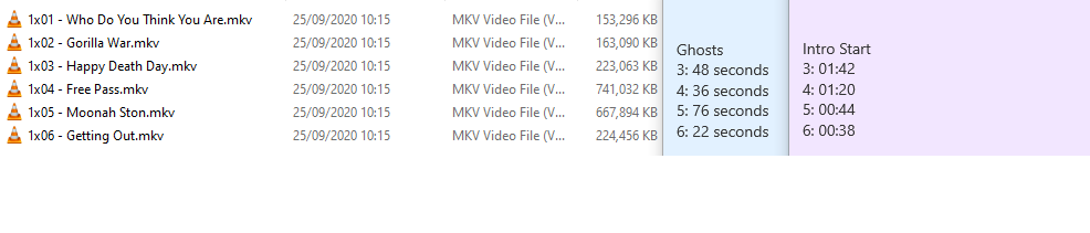

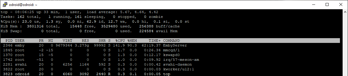

So right now I'm approx halfway through, a couple more observations.
I'm definitely hitting some resource constraints somewhere, prime suspect is the CPU rather than disk I/O.
At first I thought that some of the encode times might have been based on file size, since my TNG Bluray Rips were taking a long time, but this does not seem to be case, as evidenced below by "Ghosts". The fingerprint time in the case of Ghosts also isn't affected by where the intros are- which leaves resource conflict as the only thing I can think of for the abnormal bumps.
I also thought I'd see what happened if I tried to watch an episode as it was being fingerprinted. I can safely say that also doesn't seem to adversely affect speeds. In fact, in my (admittedly small sample size), it increased speeds. Possibly due to disk caching?
image.png.5c689f2e21bcfb6c8b2ba733885d9538.png  <<- "Normal" speed.
  image.png.6fd2d9d912cefd9dd3aca51413c958bd.png<<- "Abnormal" speed.
image.png.5acc2ea0cfdb67b3b67f988cb0c6dcfb.png<<- "Normal" speed.
image.png.9a357f6585f3715c7a8fdc3a0e45d2ed.png<<- "Normal" speed.
image.png.e07fe851b62a17a3736d1009a8c06efc.png <<-- File Streaming at the same time
image.png.2861a0f80db71567b70a5a2a0b26e193.png<<- "Normal" speed.
image.png.e4f77d5ad7d2a17ffba0c58216770da5.png <<-- File Streaming at the same time
So far so good, and upon reflection it makes sense that larger filesizes don't affect it so much, as the audio stream is likely to be the same whether it's a 720, 1080, or even downmuxed 4k rip.

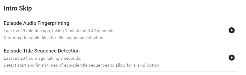

Hit another resource issue with my main setup.
Seems that the "refresh internet channels" scheduled task and the Episode Title Sequence detection tasks don't play well with each other. My instance completely froze up- no web interface/ not responding to clients. I had to switch the odroid off and on again. Unfortunately I didn't have debug logs enabled at that point, though I've re-enabled them now incase it happens again.
I'm honestly not sure which one is at fault, since they both seem to show up as "EmbyServer" processes. But clearly limited to the CPU on the box.
@chef@Luke Is there any way that the Sequence Detection can detect if any other scheduled tasks are running and pause automatically? The Audio Fingerprinting didn't seem to be affected, I imagine that's because it spawned its own separate ffmpeg processes.

Looks like I can't edit my previous post. Crashed again, lost the emby server process. When I restart it, which logs (if any) would be useful?
Edited by Micael456
Yes. I can try to make the task stop for other tasks.
