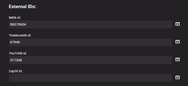

rbjtech 4996 Posted September 5, 2021 Posted September 5, 2021 (edited) Each episode also has a unique provider ID - could we link to that instead of the emby ID - as this never changes - thus on a emby dB rebuild, you will automatically link back to the correct FP ? It also makes the db very portable - as it can be used on any instance of emby and it would work (using the SAME media source obviously..) Edited September 5, 2021 by rbjtech 1
chef 3808 Posted September 5, 2021 Posted September 5, 2021 Just now, rbjtech said: Each episode also has a unique provider ID - could we link to that instead of the emby ID - as this never changes - thus on a emby dB rebuild, you will automatically link back to the correct FP ? This is also possible. Implementation would super easy, barely an inconvenience. Does the provider ID depend on which providers are selected in the dashboard? If the user changes provider hierarchy, would that ID change?
rbjtech 4996 Posted September 5, 2021 Posted September 5, 2021 Good call - I was just going by the metadata for an Episode. If the metadata for External ID is blank - then I assume you could fallback to the embyID - but with the caveats that if this changes, you lose the link and need to recalc the FP ? Same caveat if you change the provider - ie - if you use TheTVDBId and the user removes this, then they'll need to recalc the FP again ? But all 3 external references will not change - so take your pick on which one to use I guess ?! 1
