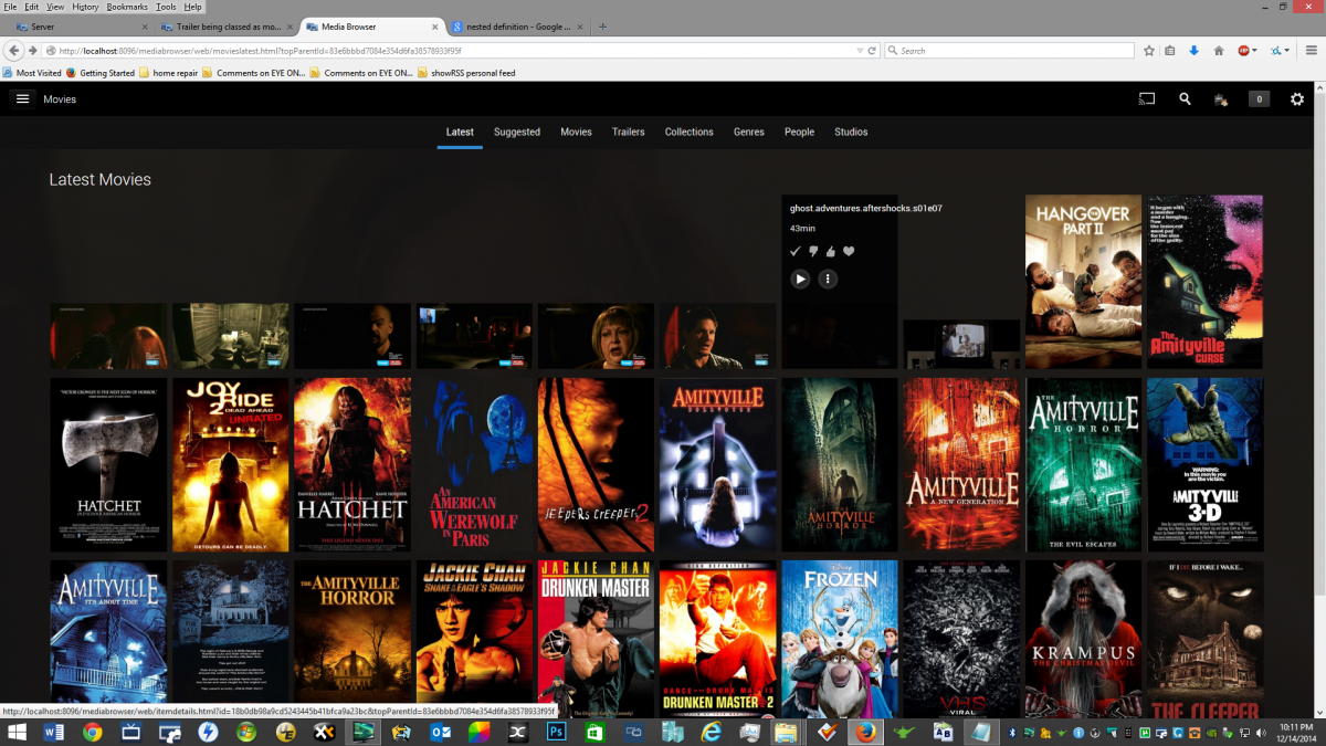

lexisdude 144 Posted December 15, 2014 Posted December 15, 2014 (edited) I am having somewhat of a similar issue - TV episodes are showing up as Latest Movies.. Same with my documentary files. My documentary files are set up in MB as home videos so that they do not appear in movies; and my TV shows are set up as TV shows. This is a real annoyance because now there does not appear to be a seperating line between them. I also checked to see if perhaps the xml files had changed, movie.xml in directory or series.xml was missing - nothing has changed, and no files appear to show modification since they were added. Screenshot :: Edited December 15, 2014 by lexisdude
Luke 40126 Posted December 15, 2014 Posted December 15, 2014 I am having somewhat of a similar issue - TV episodes are showing up as Latest Movies.. Same with my documentary files. My documentary files are set up in MB as home videos so that they do not appear in movies; and my TV shows are set up as TV shows. This is a real annoyance because now there does not appear to be a seperating line between them. Screenshot :: Can you post screens? thanks.
Luke 40126 Posted December 15, 2014 Posted December 15, 2014 I am having somewhat of a similar issue - TV episodes are showing up as Latest Movies.. Same with my documentary files. My documentary files are set up in MB as home videos so that they do not appear in movies; and my TV shows are set up as TV shows. This is a real annoyance because now there does not appear to be a seperating line between them. Screenshot :: Untitled.jpg hmm. are you on the beta or the new dev build? can you try dev? thanks.
lexisdude 144 Posted December 15, 2014 Posted December 15, 2014 hmm. are you on the beta or the new dev build? can you try dev? thanks. I am on Version 3.0.5462.0
Luke 40126 Posted December 15, 2014 Posted December 15, 2014 I am on Version 3.0.5462.0 ok, can you do two things. first grab the dev server by setting your update level to Dev in the advanced section, then restart the server and it will update. then can you also post a screen of your library setup in the dashboard. i want to make sure you've set that tv folder up as tv. double check you haven't added the tv location twice, once as tv and once as movies.
lexisdude 144 Posted December 15, 2014 Posted December 15, 2014 Ok I updated to dev build. and looked at the settings for my TV show directory in config.. It is now set to mixed movies & tv... Very strange - because it was not touched and I know for sure it was set to TV shows originally.I am removing and rebuilding it again to proper type -
Luke 40126 Posted December 15, 2014 Posted December 15, 2014 excellent. that should fix it. maybe you used the backup plugin? i know it used to have an issue where it wasn't preserving the folder type. but i'm pretty sure that has been fixed.
lexisdude 144 Posted December 15, 2014 Posted December 15, 2014 excellent. that should fix it. maybe you used the backup plugin? i know it used to have an issue where it wasn't preserving the folder type. but i'm pretty sure that has been fixed. Well it is active in my plugins but this is something that changed between updates. It's truly strange; but I can accept strange as long as it's not too strange
Luke 40126 Posted December 15, 2014 Posted December 15, 2014 so you haven't actually restored from a backup created by the plugin? well if not, i guess we will have to keep an eye out and see if this happens again. i'm glad you're back up and running. by the way- change your update level back to beta because you're probably not going to want to be subjected to daily server updates.
