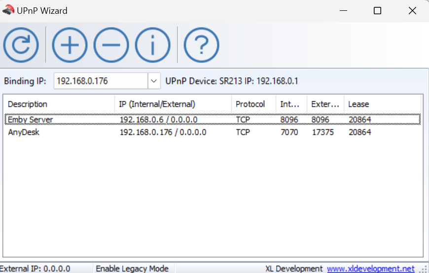

sa2000 880 Posted April 19 Posted April 19 1 hour ago, amck24 said: What are the next steps? Ensure your local IP Address for the Nvidia Shield is DHCP Reserved in the router to avoid complications later and once you have done that, follow the steps in Connecting from Client Apps - External Connections for automatic port mapping. You can use "uPnP wizard" which is mentioned, as a useful and you can use that to see what is mapped for public port 8096

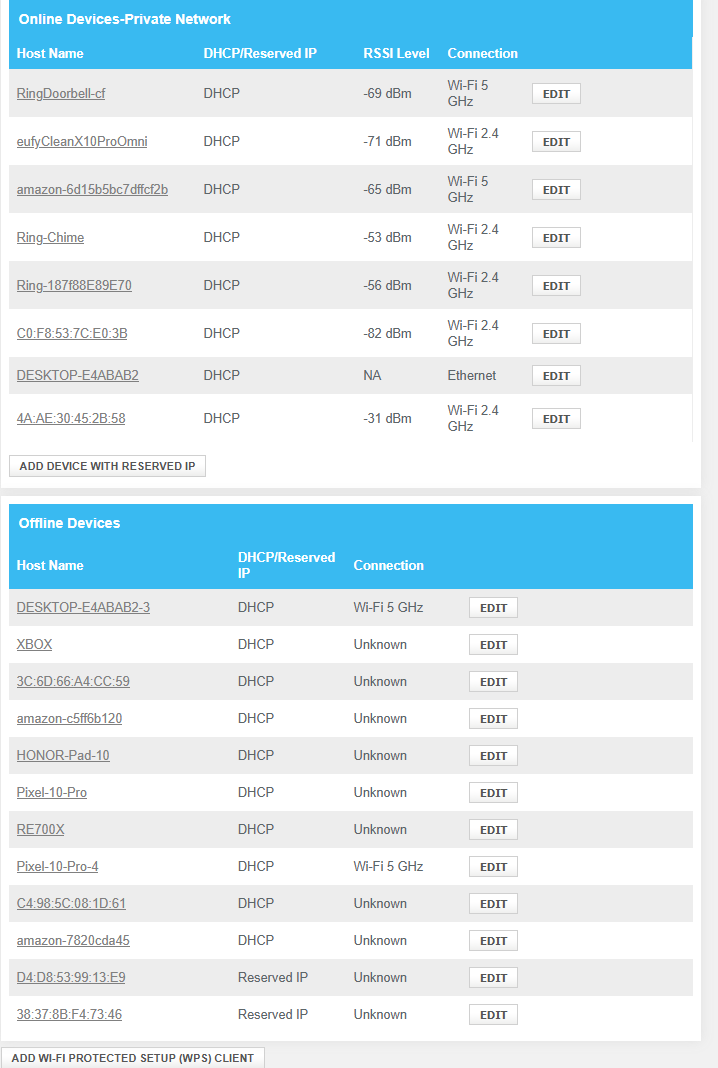

amck24 5 Posted April 19 Author Posted April 19 The shield IP (192.168.0.6) hasn't changed since I got it, I think it is static. I don't see the shield on the router connected devices though.
sa2000 880 Posted April 19 Posted April 19 upnp wizard would show the external public IP address - so should not upload screenshots or should redact them - but your screenshot showed 0.0.0.0 external ip address Do you have more than one modem/router ? Is the shield on wifi or ethernet ? and what is the Mac Address for the one being used - you can then check against the DHCP Reserved mac addresses
