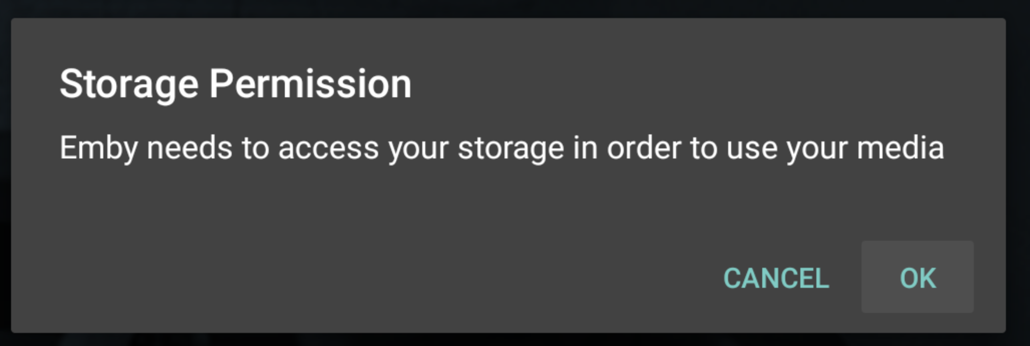

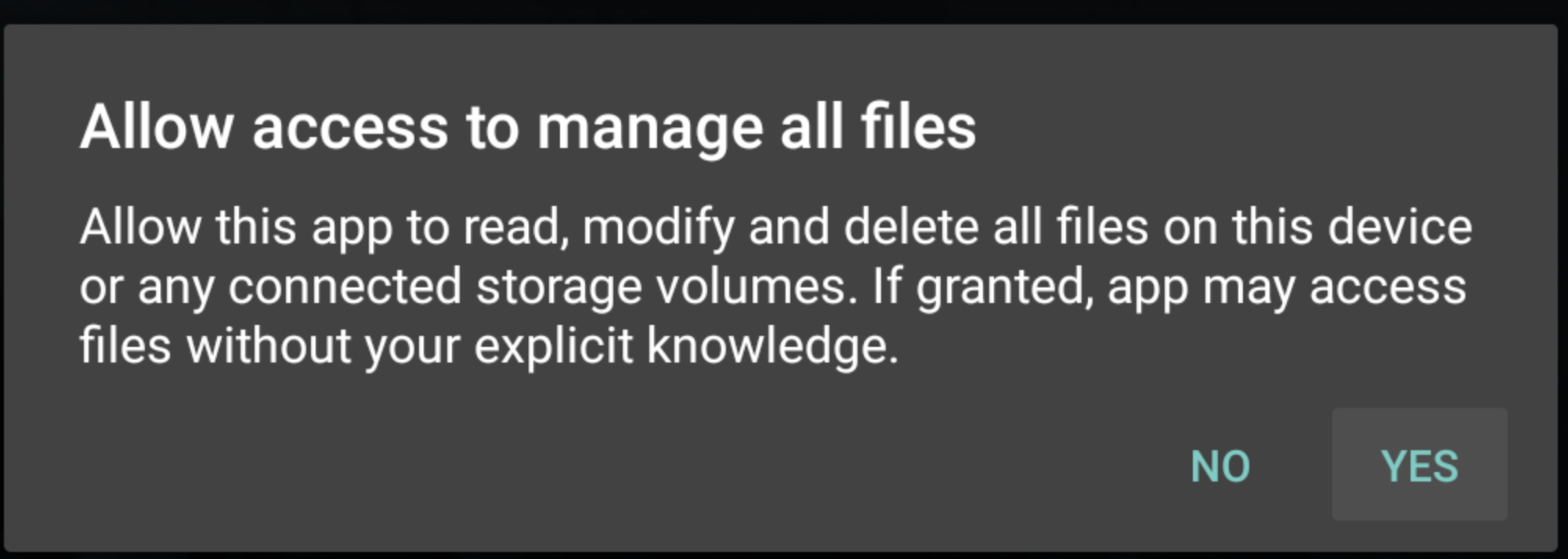

sa2000 880 Posted April 13 Posted April 13 2 hours ago, amck24 said: tried this also. Nothing happens when I click on storage, but other paths like (network) etc open fine. I am willing to screen share; is it possible to have a look? Which version of Emby Server did you install on the NVIDIA SHIELD ? When you launch it after the install, you should get this prompt to give access to the filesystem Did you see this ? After selecting "OK" you would then get this prompt which you need to answer with YES Giving the access then allows you to access the local storage These screenshots are from installing the current public release 4.9.3.0
amck24 5 Posted April 14 Author Posted April 14 Yeah just done that there just now, I uninstalled then re-installed again. I am at the library stage again and when I click on storage nothing happens.
sa2000 880 Posted April 14 Posted April 14 So you selected OK for the first and then YES for the second ? could you download the emby server log for that test and attach here please See How to Report a Problem If you have not restarted emby server or the shield since your test, it would be embyserver.txt otherwise it would be an earlier log file and would have name of form embyserver-xxxxxxxxx.txt
