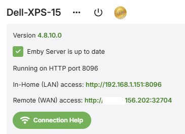

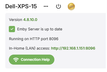

    To locate your server's internal address, simply open the Emby Server Dashboard on the Emby Server machine, typically through http://localhost:8096 and clicking on the Manage Emby Server gear icon in the top right corner.
    Your Emby Server's local address is then displayed in the In-Home (LAN) access field in the Dashboard view.

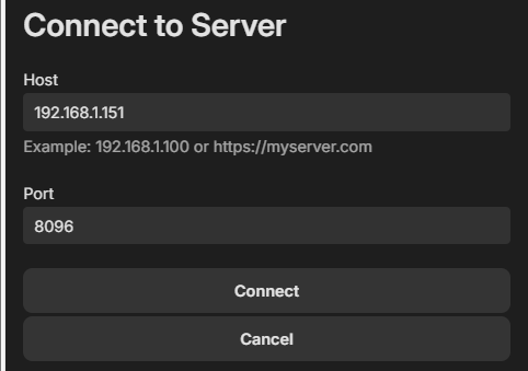

    This information can then be entered into Emby apps when making a manual connection through the Add Server option:
    It is recommended that the local IP Address for the Emby Server machine should be fixed. Use the router's DHCP Reservation feature to do that. Here is a general guide for doing this. https://portforward.com/dhcp-reservation/#how-to-make-a-dhcp-reservation-in-your-router

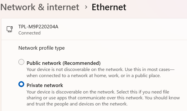

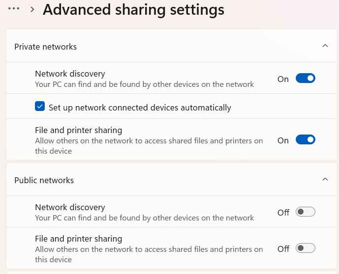

    Windows Network Profile
    If running the Emby Server on Windows, check that your network connection is set as Private and not Public. The profile may get switched to Public after re-configuration or updates. Check all the Windows network connections, Ethernet and WiFi. Example for an Ethernet connection:
    See section headed Make a network public or private in this Windows support article Essential Network Settings and Tasks in Windows.
    The follows shows the differences between the two network profiles:
    If this is set correctly as Private and you are still unable to connect to the emby server locally, then most likely the firewall on the server machine is not allowing access. Below are a list of troubleshooting steps that can be taken to resolve this.

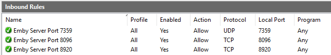

    Open TCP Ports 8096 / 8920 & UDP Port 7359 on your server's firewall
    If running Windows, the built-in Windows Firewall is usually auto-configured by Emby Server. You may validate this by inspecting the Windows Firewall rules and checking to see Inbound Rules for the EmbyServer.exe for both tcp and udp and Inbound Rules for local TCP ports 8096 and 8920 and for server discovery on the local network, UDP port 7359.
    The port rule names are being changed and you may see them as:
    and for the program rules:
    To configure the windows firewall, see How to open a port in Windows Firewall which goes through an example of how allow a specific port through the firewall. Enter port 8096 instead of the port shown in this example. If you have secure connections enabled, do the same for tcp port 8920. And add a rule for UDP port 7359 - this is used for server discovery by client apps.

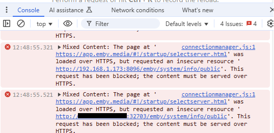

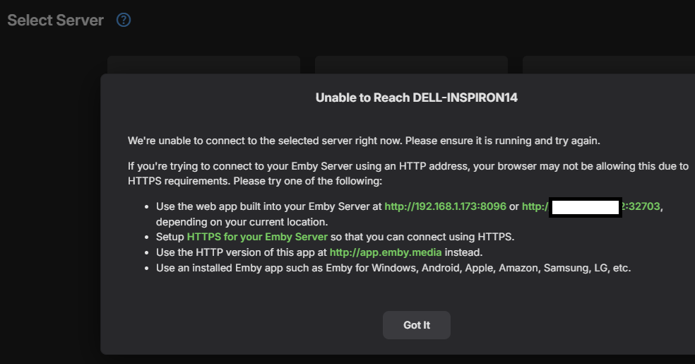

    CORS Mixed Content Block
    For the distinct browser checks involved, see mixed content and same-origin policy and CORS.
    When using the hosted Emby Web app at app.emby.media, access to the Emby Server may be blocked when https secure connections is not enabled on the server and the access in the internet browser is through https://app.emby.media. It gets blocked by the browsers because mixed mode of https and http is not permitted. Entering the http url in the browser http://app.emby.media would get round this problem.
    You can establish if this is due to the CORS mixed mode error, by opening the browser Dev Console (through the F12 key) and checking the console for errors. You would see an error like this

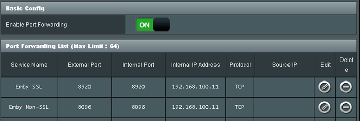

    If you want to use different public port numbers, enter the required public ports in the server Network Settings fields.
    Here is an example router setup showing 2 tcp ports forwarded - using the default public port numbers:
    You will find different names for the ports on different routers when setting up the rules. e.g. The public ports may show on the router as WAN Port, or Public Port, or External Port. The local ports may show as LAN Port, or Local Port, or Internal Port or Private Port.
    Note that the Source IP / Remote IP should always be blank in a port forward rule.
    The server IP Address, to which the port forwards are routed to, may show on the router port forward setup page as host computer, Local IP Address, or Internal IP Address, or Private IP Address.

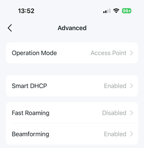

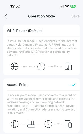

    If you have added a Mesh Network, you can set the device to operate as an Access Point and not a router. This would then leave your existing router to have the port forward.
    The following is an example for a TP-Link Deco M9 Plus Mesh Network. The Deco mobile app has in Advanced Settings an option for changing the operation mode.
    and in the following, you can see it is set to operate in a passive mode as an Access Point.

    For manually created port forward, you will need to login to the router and correct the destination IP address for the port forward. See Setup Port Forwarding above.
    For automatically created port forward with uPnP and the emby server setting: Enable automatic port mapping, you will need to shutdown Emby Server, then reboot the router to clear the existing cached uPnP port forward and then launch Emby Server.

    2. Windows Network Profile
    If running on Microsoft Windows, check if the Network Profile got switched from Private to Public. This has been seen to arise after some system updates. See section Windows Network Profile above.
