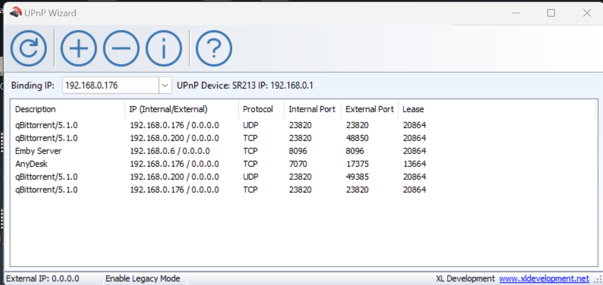

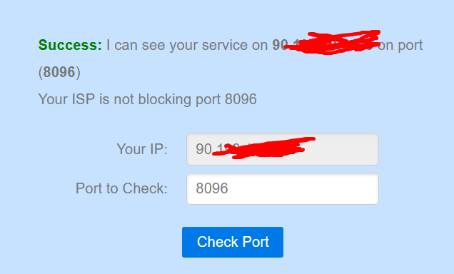

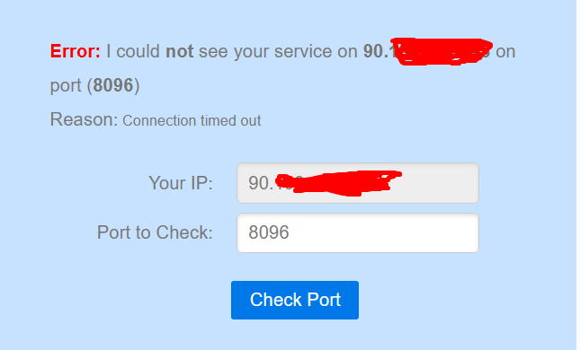

sa2000 880 Posted April 19 Posted April 19 9 minutes ago, amck24 said: MAC - 3C:6D:66:A4:CC:59 ok - that is already in your dhcp reservation set as showing in your screenshot. I presume if you click edit, it will show 192.168.0.6 so the port forward is already in place for 8096 to 192.168.0.6 Launch Emby server on the shield and then in a browser on a PC go to https://canyouseeme.org and enter 8096 in the port to check - if successful then you can test on a phone with just cellular in a browser and go to url of http://your-external-ip-address:8096

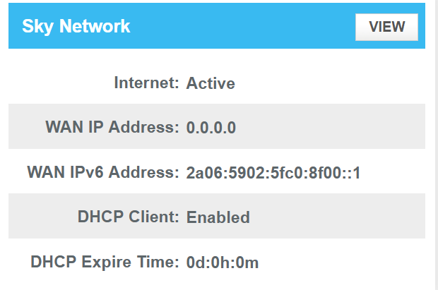

sa2000 880 Posted April 19 Posted April 19 Login to your 192.168.0.1 router and see on the status page what it shows as the WAN / Public IP Address - is it the same as what canyouseeme.org is showing?
sa2000 880 Posted April 19 Posted April 19 maybe the issue is because it is ipv6 and not ipv4 - can you get Sky to switch you to ipv4 from ipv6

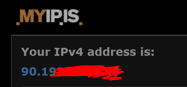

amck24 5 Posted April 19 Author Posted April 19 (edited) `Okay thats me on ipv4 now mate. Success: I can see your service on 90.xxx.xxx.xxx on port (8096) http://your-external-ip-address:8096 loads up too Edited April 19 by sa2000 removed WAN IP Address

sa2000 880 Posted April 19 Posted April 19 and - is emby server running on the shield and accessible on the local network through http://192.168.0.6:8096 from a PC ? and is uPnP Wizaed relaunch now showing an external IP address and port forward of 8096 to 8096 for 192.168.0.6 ? amd does the https://canyouseeme.org show the same public IP as that showing on the Sky Router and in uPnP wizard ? and is it still failing when checking 8096 ?

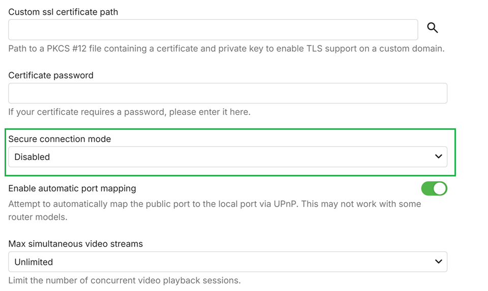

sa2000 880 Posted April 19 Posted April 19 Just now, speechles said: The default https port for Emby is 8920. yes but i did not expect @amck24to be using ssl certificates and https @amck24is https secure connected enabled in emby server network settings?

sa2000 880 Posted April 19 Posted April 19 1 minute ago, speechles said: Sky uses a stateless alternative called MAP-T to share IPv4 addresses over IPv6, which behaves similarly to CGNAT That should show up when check external ip address on the router against what canyouseeme is showing If that is the case then would need to pay sky for a static ipv4 address
amck24 5 Posted April 19 Author Posted April 19 (edited) 19 minutes ago, speechles said: The default https port for Emby is 8920. Error: I could not see your service on 90.xx.xx.xx on port (8920) Emby server is loaded on the shield. and - is emby server running on the shield and accessible on the local network through http://192.168.0.6:8096 from a PC ? Yes and is uPnP Wizaed relaunch now showing an external IP address and port forward of 8096 to 8096 for 192.168.0.6 ? is https secure connected enabled in emby server network settings? I can't find this on the network section? There is no external IP on wizard. Edited April 19 by sa2000 removed public ip
sa2000 880 Posted April 19 Posted April 19 2 minutes ago, speechles said: The can you see me URL is https. I don;t use https and this is checking the http port
sa2000 880 Posted April 19 Posted April 19 Just now, amck24 said: I could not see your service on 90.xx.xx.xx on port (8920) it is 8096 not 8920 5 minutes ago, amck24 said: is https secure connected enabled in emby server network settings? I can't find this on the network section? See Settings / Network and is the WAN IP Address showing on the sky router the same as what canyouseeme.org shows?

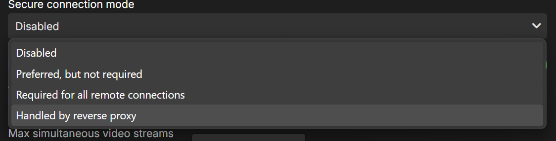

sa2000 880 Posted April 19 Posted April 19 Just now, amck24 said: what do you want me to change it to? Do not change it - leave it as disabled because you would need to have an SSL Certificate if you enable it

sa2000 880 Posted April 19 Posted April 19 (edited) So the 90.xx.xx.xx IP address that can youseme,org showed is the same as what shows on the sky router ? could you send me by PM (Private Message) screenshots of both canyouseme.org test on 8096 and the sky router status page and also output from the following on the windows PC, open cmd and type tracetrt emby.tv wait for it to complete then copy all the response lines and include in your PM Edited April 19 by sa2000
amck24 5 Posted April 19 Author Posted April 19 (edited) I can't seem to log into the router now, it is saying server not found. Will probably need to reset the router 'tracetrt' is not recognized as an internal or external command, operable program or batch file. Edited April 19 by amck24
sa2000 880 Posted April 19 Posted April 19 51 minutes ago, amck24 said: Okay thats me on ipv4 now mate. Success: I can see your service on 90.xxxxxx on port (8096) http://your-external-ip-address:8096 loads up too I missed this post - so it worked ok then - and what followed was unnecessary !
sa2000 880 Posted April 19 Posted April 19 53 minutes ago, amck24 said: `Okay thats me on ipv4 now mate. Success: I can see your service on 90.xxx.xxx.xxx on port (8096) http://your-external-ip-address:8096 loads up too I see you edited the post after I read it to add the success OK - let us rewind now to this time and go forward ignoring what followed Next is - how are you trying to access the server remotely ? By "Add Server Manually" giving the public ip and 8096 or by Emby Connect ? If by emby connect then go to server settings, open users and edit the user removing the emby connect email address, saving the change, then edit again and add it and save teh change. Then on the remote app, exit the app and relaunch and try again through emby connect
