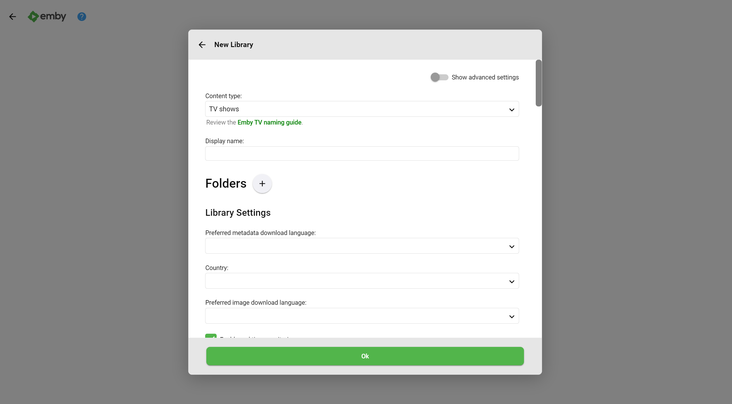

Solution Kerros 3 Posted September 18, 2023 Author Solution Posted September 18, 2023 @Luke Sadly it did not. However, I did manage to install Emby using the TrueNAS interface to initially configure it, then installing the package manually. To be more specific and to outline what I did to at least arrive at the setup wizard for Emby: Go to the TrueNAS "Jails" tab. Click "Create a New Jail" Configure the Jail with: Either a static IP (advised) or DHCP. Auto-config for IPv6 allow_mlock checkmarked (otherwise this will not work in the Jail) Upon completion, start the Jail. Open the shell into the Jail and run: pkg install emby-server Upon finishing, run the below commands: sysrc emby_server_enable="YES" service emby-server start Open your local host connection by going to the URL http://localhost:8096 NOTE: May need to configure your router's inbound/outbound rules This is where I'm at now: At least I'm one step closer. I just hope that my Emby Premiere lifetime code I purchased a while back will still work with a fresh install. For now, I need to start troubleshooting how to make the jail find the pool that's sitting literally right next to it (been a while). I will mark this as my solution. Going forward, I will have to run commands like this on my newly created Emby Jail: pkg update && pkg upgrade Thanks for your time @Luke 1
