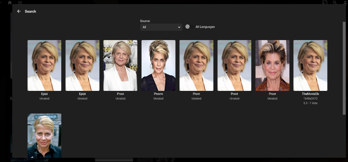

mickle026 604 Posted February 1, 2021 Author Posted February 1, 2021 (edited) Here is a smaller search plugin, There is absolutely nothing to configure. Even trying to get to the config pages will do nothing. Its internal in the images clickable through the normal media views, its currently in aplha state (not even beta), it does work though. Warning: It might slow down your current images search a few seconds or a person page load if it has no image while it looks for one. - so remove it if you're not happy, its not that fast at the moment. Please ignore the provider names. The images only download when you click a person or search the image. Check the laws in your country if you are allowed to web scrape. You are responsible as the end user. again, no warranty whatsoever. built and tested with 4.6.0.22 beta server Edited February 3, 2021 by mickle026

mickle026 604 Posted February 3, 2021 Author Posted February 3, 2021 (edited) Updated the Internal Person Provider plugin with more scrapers and the option to turn them on or off. Its now listed in the first post called Custom Person Provider Edited February 3, 2021 by mickle026
tr0nllam 35 Posted February 4, 2021 Posted February 4, 2021 7 hours ago, mickle026 said: Updated the Internal Person Provider plugin with more scrapers and the option to turn them on or off. Its now listed in the first post called Custom Person Provider Small bug, but I think IMDB is being labeled as Mubi in the search results.
mickle026 604 Posted February 4, 2021 Author Posted February 4, 2021 (edited) 3 hours ago, tr0nllam said: Small bug, but I think IMDB is being labeled as Mubi in the search results. I have fixed this, thanks for pointing it out, I also added a couple more scrapers. If you can run this in a broswer with the plugin config on one tab and your page on another, you can turn them on / off as you look for the actors. Try not to use scrapers that are not valid for a particular search. So don't use the marvel cinema on for stuff thats not marvel etc. That way we reduce hits on their sites. Re-uploaded to first post, I think this may be near to being a beta now Edited February 4, 2021 by mickle026 1
