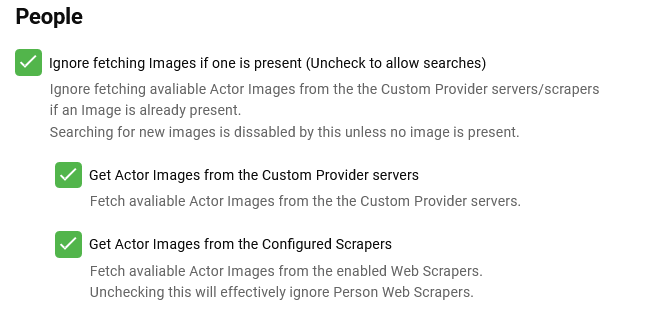

1 hour ago, mickle026 said:
@tr0nllam
Are you wanting the person Image collector to behave like this? Be able to do one or the other or both?
2069908191_Screenshot2022-04-02at15-50-38Emby.png.a849884816dafca991fbe10bc4ee4251.png
Before the scrapers were disabled and then re-added back in, if the Get Actor Images option was turned off, it wouldn't search the custom scrapers when you looked for an actor image. So yes, it would be nice to have the option to turn that on/off without having to turn off the whole plugin.
I'd also like to be able to turn off the fetch metadata option separately because it slows down the loading of actor pages for anyone who doesn't have metadata.
mickle026
I have turned off metadata fetchers here and the pages with no metadata still load slowly.
Investigating this, shows its not the fetching metadata (or trying to) that slows it down.  Servers are still being queried for an image by Emby even if there is one because the metadata is missing.
Ok so now we have a problem that we have to find the best solution to.
Emby uses 1 function trigger to find images and 1 function trigger to get metadata, both are triggered if anything is missing. (would be better if only 1 was triggered but Emby is made that way because traditionally it got all of the items from one place)
So the next logic would be to ignore fetchers/scrapers if the person has an image, but testing that it prevents image searches (clicking edit images) unless you delete the image.
so;
has metadata and image = ignore image collector  (this is good, and happens anyway but implimenting this in the plugin code prevents searches)
has image but no metadata  = ignore image collector  (works and pages load lots faster - however, this prevents searches)
no image but has metadata  = use image collector  (this is ok)
Any thoughs what I could do here? - some sort of toggle on/off for this scenerio ....maybe ...
So what I have tested is just that
896679828_Screenshot2022-04-02at18-43-19Emby.png.bbbeb366d3f9a5ec2c59c0ca96282ec8.png
Let me know if you can think of a better solution ?

mickle026
Latest build.  Zip contains build for stable server (CustomProviderStable.dll), and beta server (CustomProviderbeta.dll).
Adds Localise Images from http to local cache
CustomProvider.zip

Can you explain exactly what this new features does
mickle026
It downloads all remote images to the cache for the chosen items.
When you add a new item and a plugin is used to fetch the metadata and images its image path is likely to be a http link.
This utility will make that remote image local, ie stored on you ssd, nvme or hdd.  This is a user preference, its not a necessity.

Dez_Lamar
The example below shows actor Terrence Terrell, in my library his image was always loaded from online, after running the tool his image is now always from my storage drive.

So, for example in my metadata for movies I have an url link to the image for that actor, will it pull the image from that URL or not at all.
mickle026
As in the example above it pulled the image from tmdb URL to my ssd metadata folder (not media folder)
