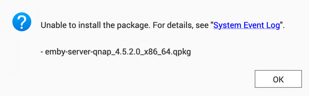

Luke 40079 Posted November 14, 2020 Posted November 14, 2020 11 minutes ago, stevenism said: Running emby 4.5.2.0 for QNAP x86 on QNAP TS-253A on firmware 4.5.1.1480 Emby app shows as running in QBoost. However: - Running port scan from internal devices shows port 8096 is not open. - Emby roku app shows connection refused to 192.168.1.xxx (QNAP NAS internal IP) at port 8096 - Connecting from Firefox to 192.168.1.xxx:8096 give error "Unable to connect" Did the latest firmware killed / closed port 8096? Should I try reinstalling the same version over the existing installation? Thank you so much! Hi, yes you could try that. Thanks.
stevenism 1 Posted November 14, 2020 Posted November 14, 2020 3 hours ago, Luke said: Hi, yes you could try that. Thanks. Cannot install. Error message attached. Also there is no logs recorded in the System Event Log. I have been running Emby 4.5.2.0 for a while. Issue is most likely lie in the updated QNAP firmware.
Luke 40079 Posted November 14, 2020 Posted November 14, 2020 8 minutes ago, stevenism said: Cannot install. Error message attached. Also there is no logs recorded in the System Event Log. I have been running Emby 4.5.2.0 for a while. Issue is most likely lie in the updated QNAP firmware. Hi there, what version of the firmware do you have?
stevenism 1 Posted November 14, 2020 Posted November 14, 2020 54 minutes ago, Luke said: Hi there, what version of the firmware do you have? Now I am running 4.5.1.1480. Was running 4.5.1.1465 before.
