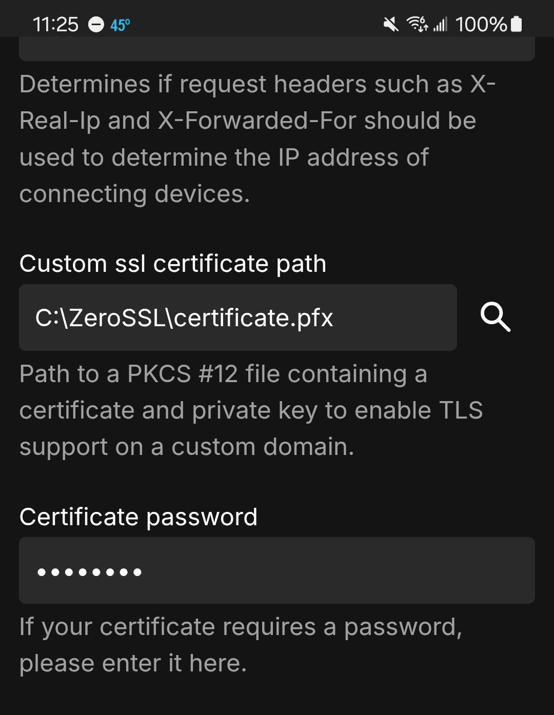

Teknician 4 Posted November 25, 2024 Posted November 25, 2024 Your script to generate your key should include your password and added to the network settings in your Emby server. Here's my batch file script to generate my key for my domain and Emby. cd c:\ZeroSSL @[member="Echo"] off le64 --key account.key --csr domain.csr --csr-key domain.key --crt certificate.csr --domains DOMAINHERE.com --generate-missing --handle-as dns --export-pfx PASSWORDHERE --live pause The capped domain and password, you would add yourself. Then in your settings in Emby 1
