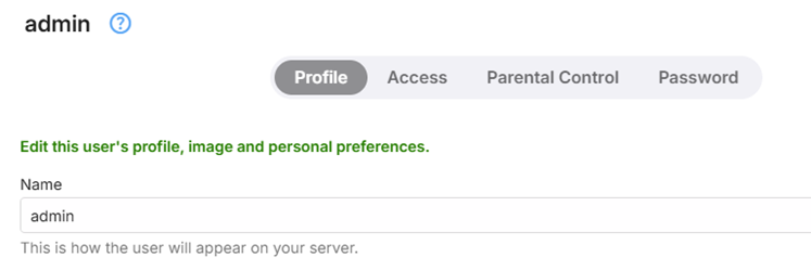

    Server Admin Account
    • Avoid having a name for the admin user account for Emby Server as admin or root.
      If the user name is already set as that, you can edit it through the server settings / users screen and editing the profile.
    • Separate your admin and normal use of the emby server. Have a separate account for normal use and streaming and keep the account with server admin privilege as a separate account used just for server admin.
      You can control which accounts have the ability to manage the server through this user profile setting

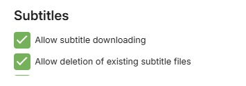

    Check that media deletion is controlled and restricted only to the accounts that you trust to give that privilege to. If you had previously granted media deletion for all libraries, reconsider and where absolutely needed, enable it for specific libraries and channels.
    Note
    You can deselect “All libraries” and select specific libraries and channels.
    Similarly for subtitle deletions.

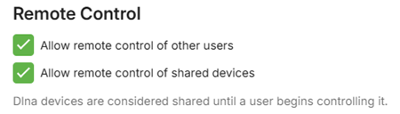

    And for remote control, restrict the permission to control for other users to just the admin accounts.

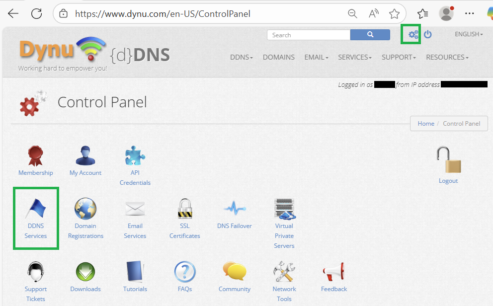

    2. Login to your account and open the Control Panel

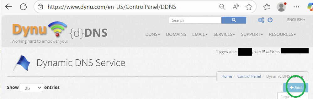

    1. Select "DDNS Services"

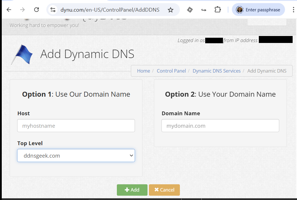

    2. Click on "+Add" to add a domain to the Dynamic DNS Service.

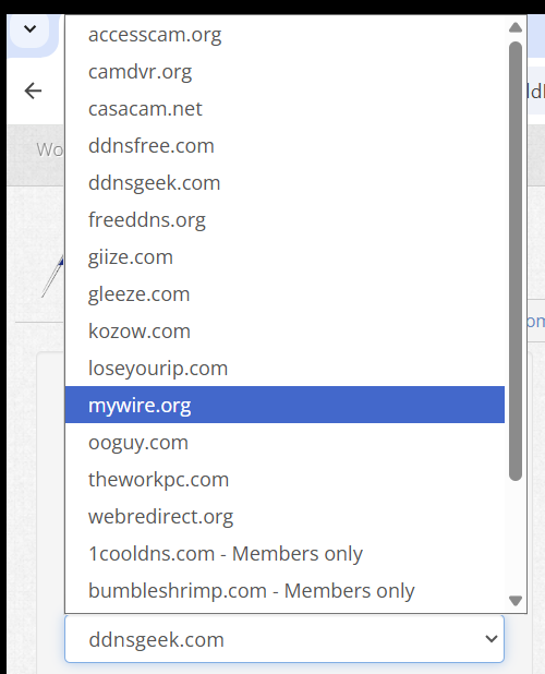

    Next, either choose a free domain name provided by Dynu, selecting one of the many Top Level domain names with your hostname as the prefix, or adding a domain you already own.
    The following shows examples of available Top Level domain names for a free domain name provided by Dynu.
    1. If adding a free domain from Dynu, select your preferred Top Level domain and enter the prefix "Host" name you wish to have.

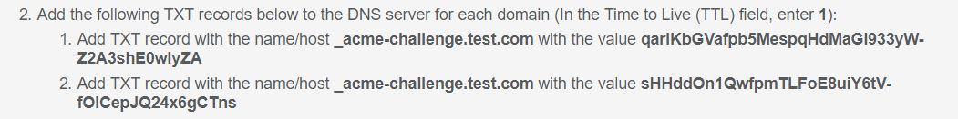

      We now have 2 TXT records (step 2 on the SSL for free website). We will copy back the TXT records to the domain provider. Leave the SSL for free page open. We will come back to it.
    3. On the domain provider website, select your domain > Manage DNS
      Let's create a new TX record. Repeat the steps for both TXT records on SSL for free. Your information should look like this.
      For Dynu DNS, login and open the Control Panel and select DDNS Services, then select the domain from the list of domains for your account, and click on DNS Records and then fill the template for Adding a DNS Record. In the Node Name field replace the preset "www" with _acme-challenge. For the type field, open the drop-down and select "TXT - text". In the "Text" field, you would enter the text character requested for the certificate domain verification process.
      You should end up with a TXT DNS Record like this - these are just examples:
      Type: TXT.
      TTL: 300 (if you can set it to the lowest possible value).
      Target: qariKbGVafpb5MespqHdMaGi933yW-Z2A3shE0wIyZA

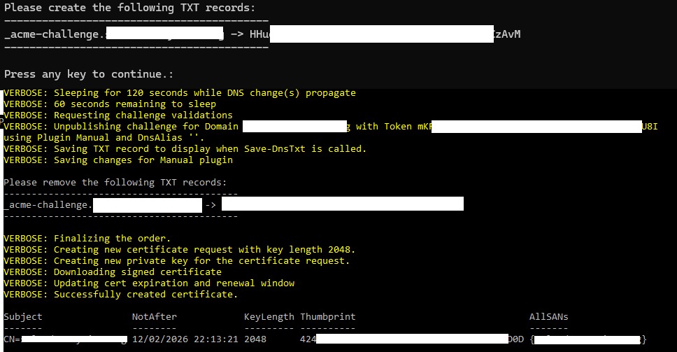

    Select a password to use with the pfx certificate to be configured in the Emby Server Network Settings. This will need to be passed on in the new certificate request.
    You should also include a contact e-mail address in the request which is expected to result in a reminder for renewal.
    Run the following PowerShell command to request the certificate for your domain.
    New-PACertificate <your domain> -AcceptTOS -PfxPass <the-password to be set on the pfx certificate> -Contact '<your e-mail address>' -Verbose -Force
    The additional parameters being:
    -AcceptTOS : To accept the Terms of Service.
    -Verbose : could be useful in event of issues.
    -Force : allows you to re-create the certificate.
    Example:
    New-PACertificate my.domain.org -AcceptTOS -PfxPass gTsjAd!02 -Contact 'my-email@mail-provider.com' -Verbose -Force
    You would then get the TXT record to add your domain DNS Records for the DDNS service.
    Exmaple of response from Posh-Acme:
    Please create the following TXT records:
    _acme-challenge.<your domain> -> xxxxxxxxxxxxxxxxxxxxxxxxxxxxxxx
    Press any key to continue.:
    where xxxxxxxxxxxxxxxxxxxxxxxxxxxxxxx would be the TXT string displayed by Posh-Acme that needs to be in the TXT DNS record.

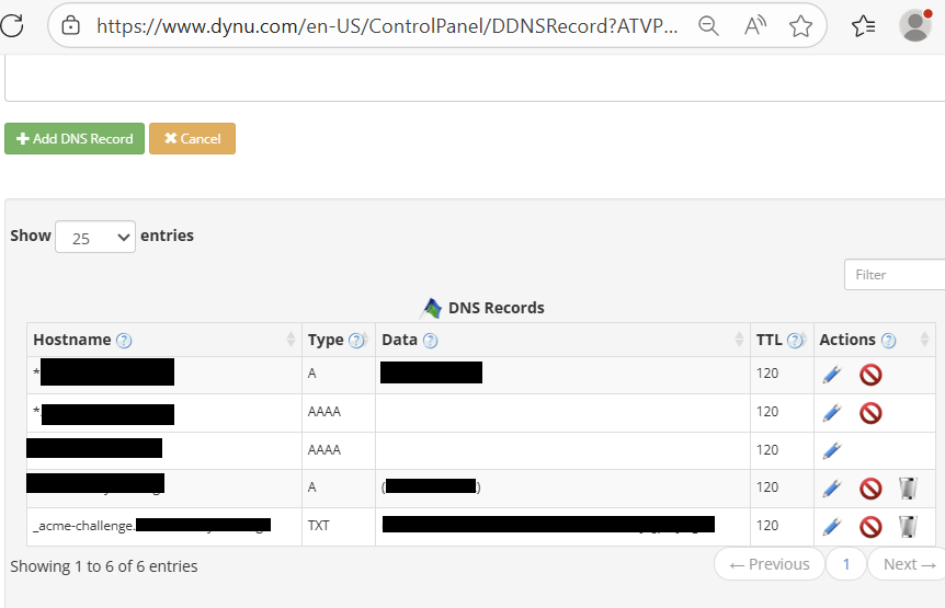

    Now login your DDNS service provider, eg https://www.dynu.com and click on the Control Panel button.
    Click on "DDNS Service"
    Click on your domain name
    and now click on "DNS Records"
    You will see a number of DNS records of Type A and AAAA. You will also see a public IP Address. Check that this is your WAN/Public IP Address.

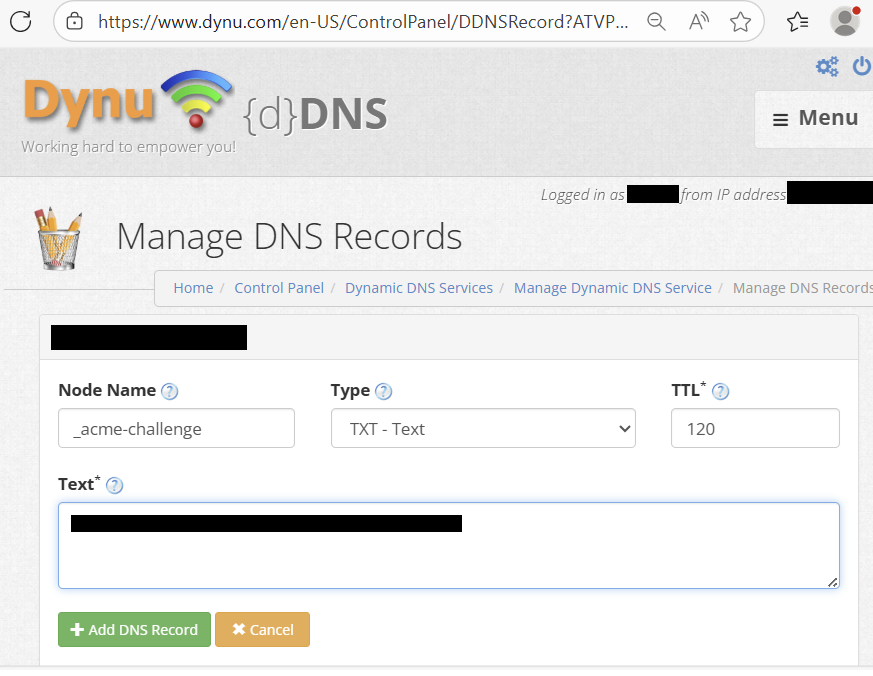

    You now need to add a DNS Record.
    In the Node Name field, overwrite the preset "www" with "_acme-challenge" In the Type field, select "TXT - Text" from the drop-down In the Text field, paste in the text characters returned by Posh-Acme above. Now click on "+Add DNS Record"
    You should now see a new DNS record added with the name "_acme-challenge.your-domain-name"
    Now go back to the Powershell session and hit enter to continue.
    Posh-Acme will now sleep for 2 minutes and then auto connect to your DDNS provider and validate the DNS entry and confirm ownership of the domain through that.
    When validated, Posh-Acme will now request that you remove this DNS record and it will confirm the certificate creation.
    Go back to the DDNS service DNS Records page for your domain, and for the _acme-challenge.your-domain DNS record, click on the recycle bin icon and confirm the deletion.

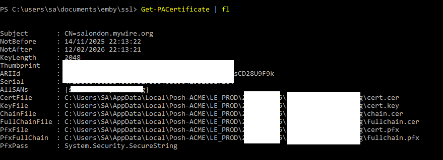

    To see where the certificate files are stored by Posh-Acme, go back to the Powershell session and enter the following command:
    Get-PACertificate | fl
    The file that you will need for Emby Server is that in the path for "PfxFile". Copy the file for where you want to keep the Emby Server certificate and you will also need the password you specified on the New-PACertificate command.

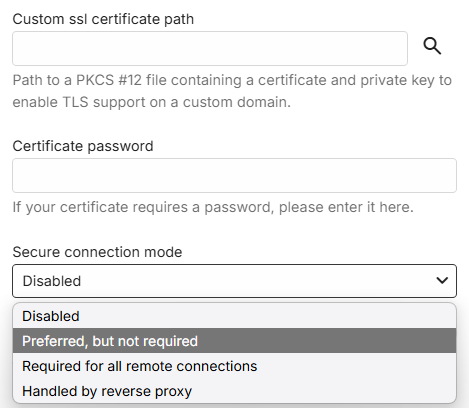

    Setup Emby Server with your domain and SSL certificate
    Go to your Emby server Settings dashboard > Network.
    The following will be the fields you will need to specify:
    where: External domain: yourdomain.com
    Custom SSL certificate path: point to your new certificate.pfx file
    Certificate password: The pfx password you set up in the previous step.

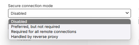

    Secure connection mode: Set it to either "Preferred but not required" or "Required for all remote connections".
    Your Emby Server Settings dashboard should now reflect your remote access through this url https://yourdomain:port. The certificate hostname must match the hostname used for the connection.
    If you followed all the steps, then navigating a browser from outside your local network to this new remote url should reach your Emby server.
    If it doesn't work, verify your https ports and try connecting from outside of your network. If the dashboard is still showing the domain url with http, check that you have entered the correct certificate password. You may need to look at the server logs to see if there was an error in processing the certificate.
