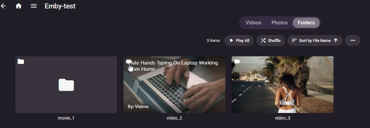

wkl_lau 0 Posted December 9, 2022 Posted December 9, 2022 On 08/12/2022 at 03:02, Luke said: Hi, can you please attach the emby server log from when you tried to do that? Thanks. Hi @Luke here is the log, I redo the VM twice and still got the same result. You have to see it in folder view to observe the issue (see screenshot) Notice the folder for movie_1 is blank and have no primary image. Screengrabber just refuse to do anything if here is already an image in the folder. If the image has the same name as the video, then it will be used as primary image (ex: video_2.mov/video_2.jpg) embyserver.txt

wkl_lau 0 Posted December 11, 2022 Posted December 11, 2022 On 09/12/2022 at 16:41, Luke said: No that's not true. You're not looking at the video, you're looking at the folder. If you drill into the folder, then i think you'll see the video does have a generated image. @LukeMy issue has always been about the folder. I can see the video inside without problem. My issue is about the folder not having a primary image On 09/12/2022 at 16:29, Happy2Play said: This issue is it is a folder with a video and 2 photos. So technically it should not get an image as there is no way to know whether a photo or video image should be used. But eventually it will use the first image in the folder. So folder content changes the distinction of item vs folder. @Happy2Play So I went back and create another folder called movie_4, and having one video and one picture, and I make sure the picture is named differently than the video. And again the folder has no primary image (see attachment)

wkl_lau 0 Posted December 16, 2022 Posted December 16, 2022 @Luke @Happy2Play I am still having problem... So in movie_4 folder, I rename the image to not matching the video's name video_4.mov/video_4_cover.jpg (notice I added text in the video_4_cover.jpg so I can tell if it show up) I did a rescan and refresh metadata, and I notice not only the image is not used as folder primary image, it is not even show up in the photo view In another word, I cannot see that picture at all in Emby
Happy2Play 9452 Posted December 16, 2022 Posted December 16, 2022 @wkl_lau This is not a folder it is a video item per the icon. So the image was used for the item as cover is an acceptable naming scheme.
wkl_lau 0 Posted December 16, 2022 Posted December 16, 2022 3 minutes ago, Happy2Play said: @wkl_lau This is not a folder it is a video item per the icon. So the image was used for the item as cover is an acceptable naming scheme. Exactly! The image is not used at all, just a screen grab from the video is used as covered. Are you saying the naming of the image make it not being used as cover? But then why it doesn't show even in photo view??
Happy2Play 9452 Posted December 16, 2022 Posted December 16, 2022 3 minutes ago, wkl_lau said: Exactly! The image is not used at all, just a screen grab from the video is used as covered. Are you saying the naming of the image make it not being used as cover? But then why it doesn't show even in photo view?? Hard to say maybe a cache issue but with the images so much alike I can't really see much difference in the images. But since it is not showing a folder the image is being used by the item in some way.
wkl_lau 0 Posted December 16, 2022 Posted December 16, 2022 2 minutes ago, Happy2Play said: Hard to say maybe a cache issue but with the images so much alike I can't really see much difference in the images. But since it is not showing a folder the image is being used by the item in some way. Thanks, that's why I added the text to the image in order to make it easier to distinguish the image from screengrab And from both the photo and folder view, the image is no where to be found
Happy2Play 9452 Posted December 16, 2022 Posted December 16, 2022 Yes in this example I will guess a naming conflict but @Lukewill have to confirm as this video_4_cover.jpg is ignored while a change to video_4-cover.jpg will get used.
Luke 40122 Posted December 16, 2022 Posted December 16, 2022 32 minutes ago, Happy2Play said: Yes in this example I will guess a naming conflict but @Lukewill have to confirm as this video_4_cover.jpg is ignored while a change to video_4-cover.jpg will get used. That is correct.
wkl_lau 0 Posted December 16, 2022 Posted December 16, 2022 1 hour ago, Happy2Play said: @wkl_lau This is not a folder it is a video item per the icon. So the image was used for the item as cover is an acceptable naming scheme. If I rename the image as per the acceptable naming scheme, yes it will be used automatically as primary image, but a metadata refresh + replace existing image will cause it to be deleted. I tried a few different formats: {name}.ext, {name}-cover.ext, cover.ext. It behave the same.. Is there anyway I can use an image as the primary image without the worry of being deleted when trigger a metadata refresh+replace image?
Happy2Play 9452 Posted December 16, 2022 Posted December 16, 2022 2 minutes ago, wkl_lau said: If I rename the image as per the acceptable naming scheme, yes it will be used automatically as primary image, but a metadata refresh + replace existing image will cause it to be deleted. I tried a few different formats: {name}.ext, {name}-cover.ext, cover.ext. It behave the same.. Is there anyway I can use an image as the primary image without the worry of being deleted when trigger a metadata refresh+replace image? To a point it deviates from accepted -cover.ext naming scheme but don't know why it would be completely ignored. But proper naming works just fine shown earlier and now. Renamed image and did library scan.
Luke 40122 Posted December 17, 2022 Posted December 17, 2022 55 minutes ago, Happy2Play said: To a point it deviates from accepted -cover.ext naming scheme but don't know why it would be completely ignored. But proper naming works just fine shown earlier and now. Renamed image and did library scan. It's because the photo scanning is just blindly ignoring all images starting with the video file name. That's something that needs to be adjusted. 1
