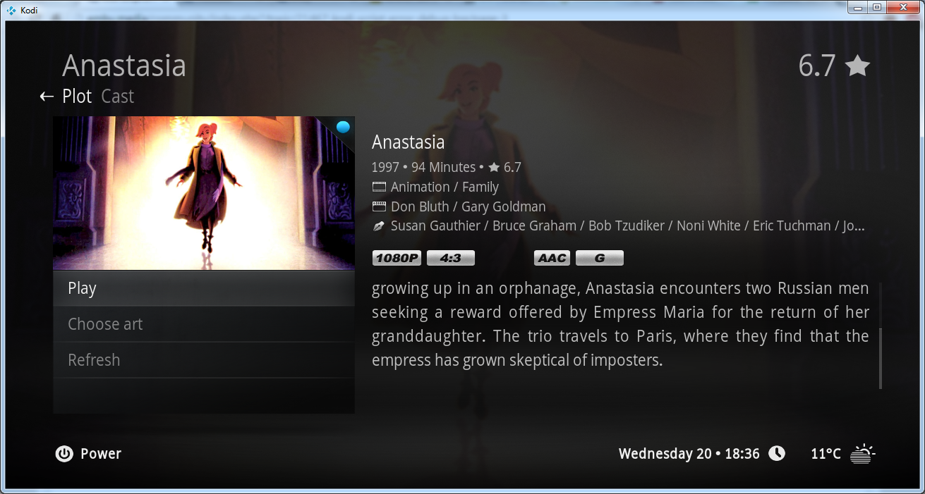

Yes for those two .MOV files we were talking about in the other thread, they are actually SD but in Kodi it has a 1080P flag still. If I start to play one and then stop it, the flag is still wrong when viewing the movie information page.
Which is why I was going to check all the various video formats to see what flags they are showing and if they are correct or not?
  • Like 1

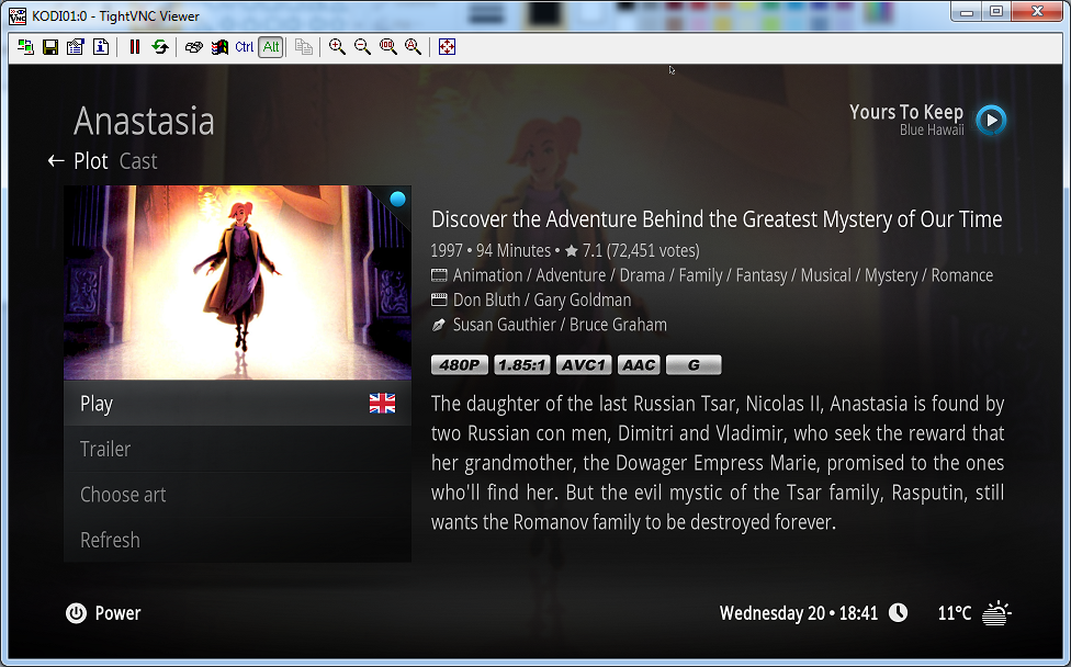

There is a flag missing as well, "AVC1"
Media Info, the flags should be saying SD 480p
Complete name                            : \\whs\Kids Movies\Apple\Anastasia (1997)\Anastasia.mov

Here is the same movie in Kodi still connected to MySQL
