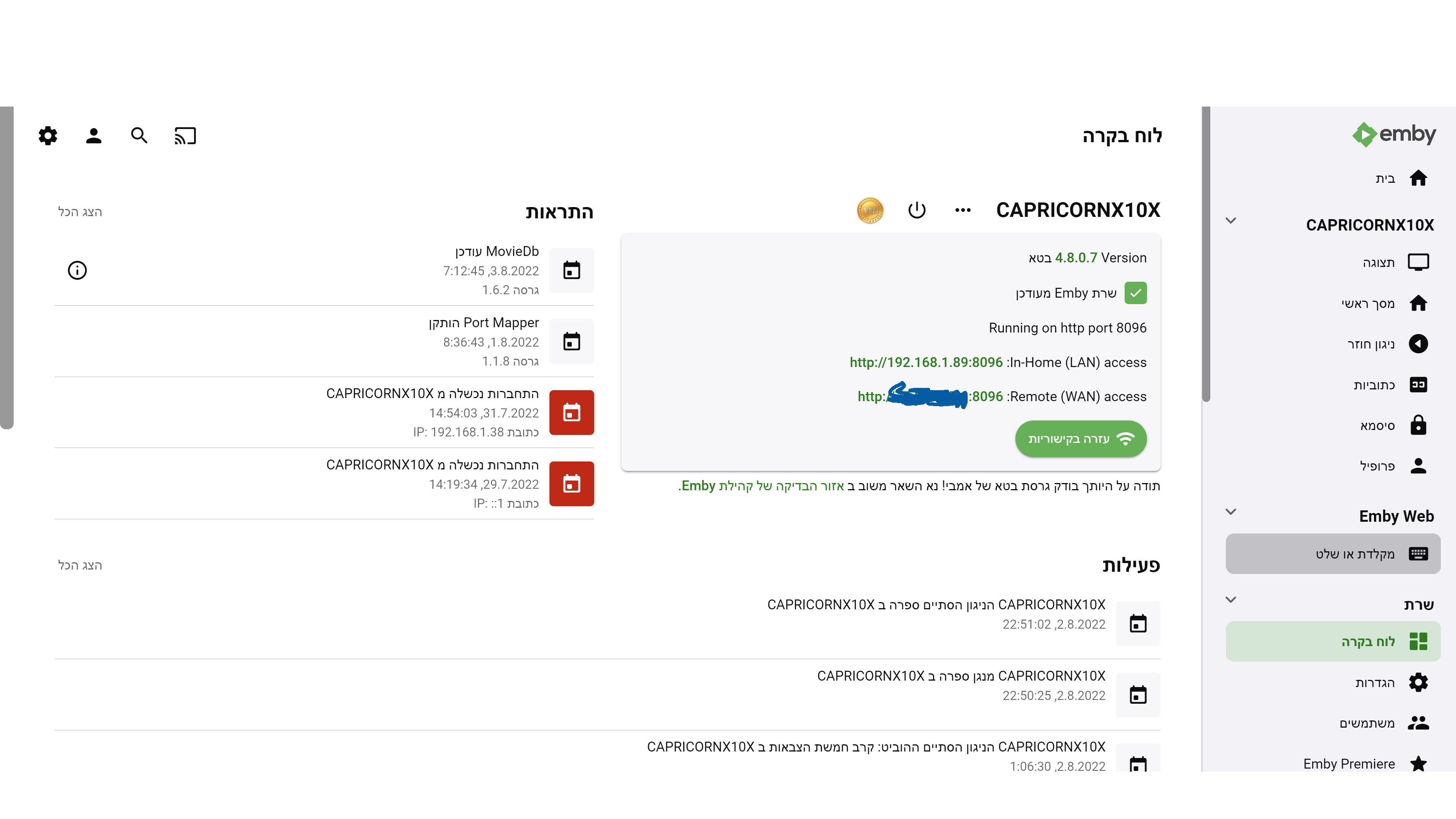

CAPRICORNX10X 68 Posted August 3, 2022 Author Posted August 3, 2022 3 minutes ago, Luke said: 8096 is the default, so there's nothing you need to change, unless you already changed it once, then just change it back. Is this how the settings should be?
CAPRICORNX10X 68 Posted August 3, 2022 Author Posted August 3, 2022 The thing is really strange...it was like that from the beginning.
Luke 40083 Posted August 3, 2022 Posted August 3, 2022 1 hour ago, Luke said: yes. Are you sure your ISP opened up the ports? Maybe they didn't?
