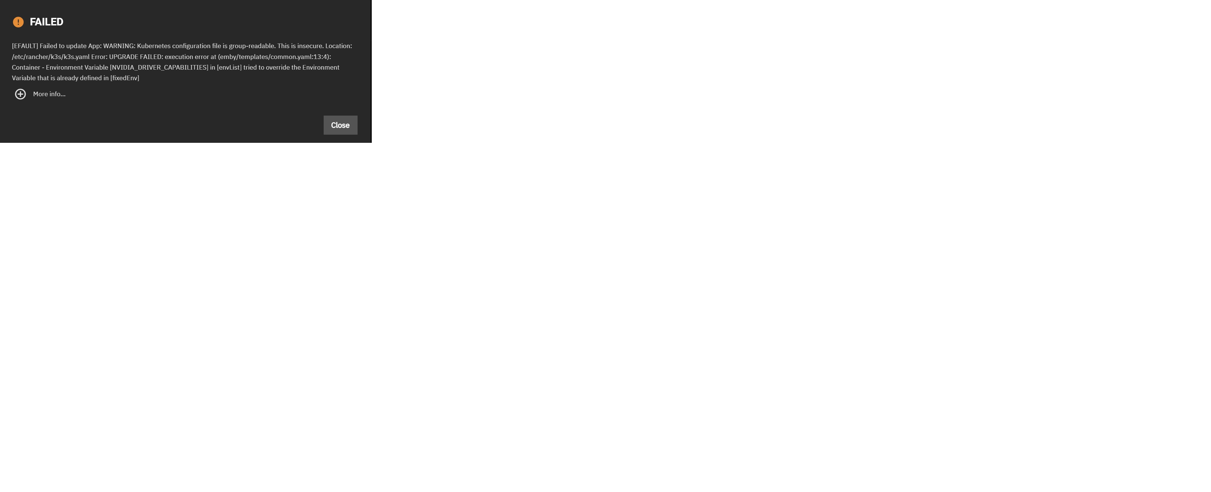

audiom3 11 Posted August 1, 2024 Posted August 1, 2024 Thanks @jaycedkI will do that when I can. I tried the guide located here: https://www.truenas.com/community/threads/can-multiple-apps-utilize-the-same-gpu.99757/ Seemed so easy. But naturally with my luck, it was far from it. I get this error when I do exactly as the poster stated with the Env Variables.
audiom3 11 Posted August 3, 2024 Posted August 3, 2024 Ok got it working...finally! For some reason, my on board GPU was disabled in bios. I've had a headless setup for over two years and never needed a GPU... But this also sent my Nvidia 3060 into a crashloop, 3 minutes after rebooting (lots of posts about this issue). But once I enabled the built in GPU as the primary, the Nvidia stopped going into a crashloop and was available for transcoding within the app container setup. Thanks for your suggestion @jaycedk 1 1

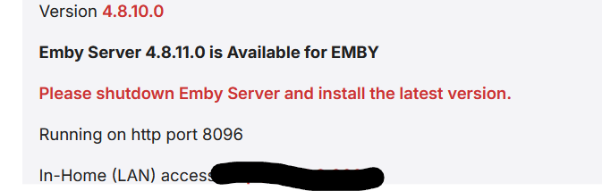

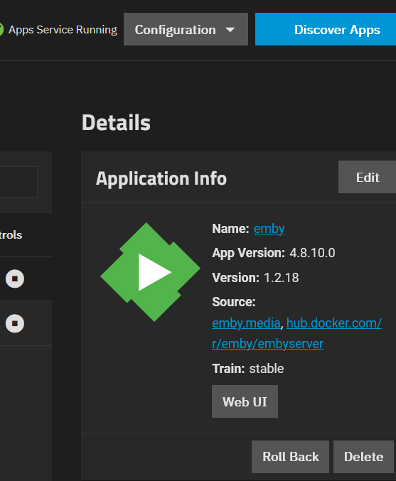

hjason7812 34 Posted March 11 Posted March 11 There is an issue with the emby server on truenas scale that just popped up today. for some reason the emby Gui is saying there is an update for emby went to truenas and there was i updated emby and no other update was available for emby rebooted emby server but the gui keeps saying theres a new update available and it is different than what truenas had and updated to.. so what do i do to get rid of this update on my Gui dashboard if there isn't an update available for it??? I have included screenshots of emby GUI and also truenas GUI Thanks
hjason7812 34 Posted March 11 Posted March 11 20 minutes ago, Luke said: Hi, the update is coming. Apologies for the delay. Thanks just weird how it updated to as new version this am when it was all updated to latest then the GUI says it has a newer update that doesn't even exist yet
