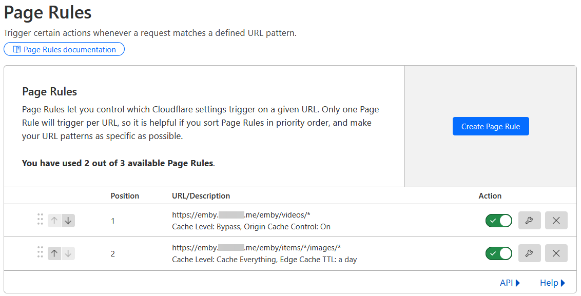

  • 1 month later...
I've been off from Emby forums for a couple of years now, but i have been reading up on this thread lately.
My CF account is still not TOS capped, and my bandwidth usage fluctuates between 250GB-1TB per month.
What has changed personally the last year or so, has been my migration from ovpn.com to Njal.la. Since Njalla changes IP every day, i have automated it to reflect the IP change automatically to CF with Marcs Updater..
See screenshot of my cloudflare dns setup.
I have no idea if that has enabled me to continue using CF, or if im just lucky.

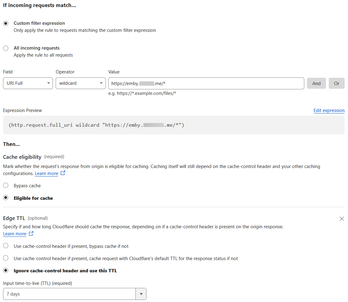

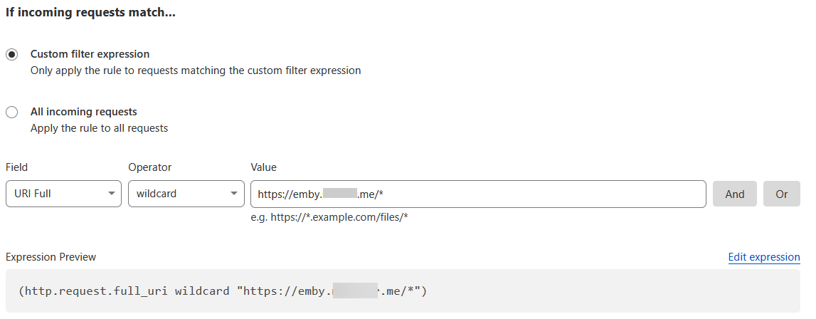

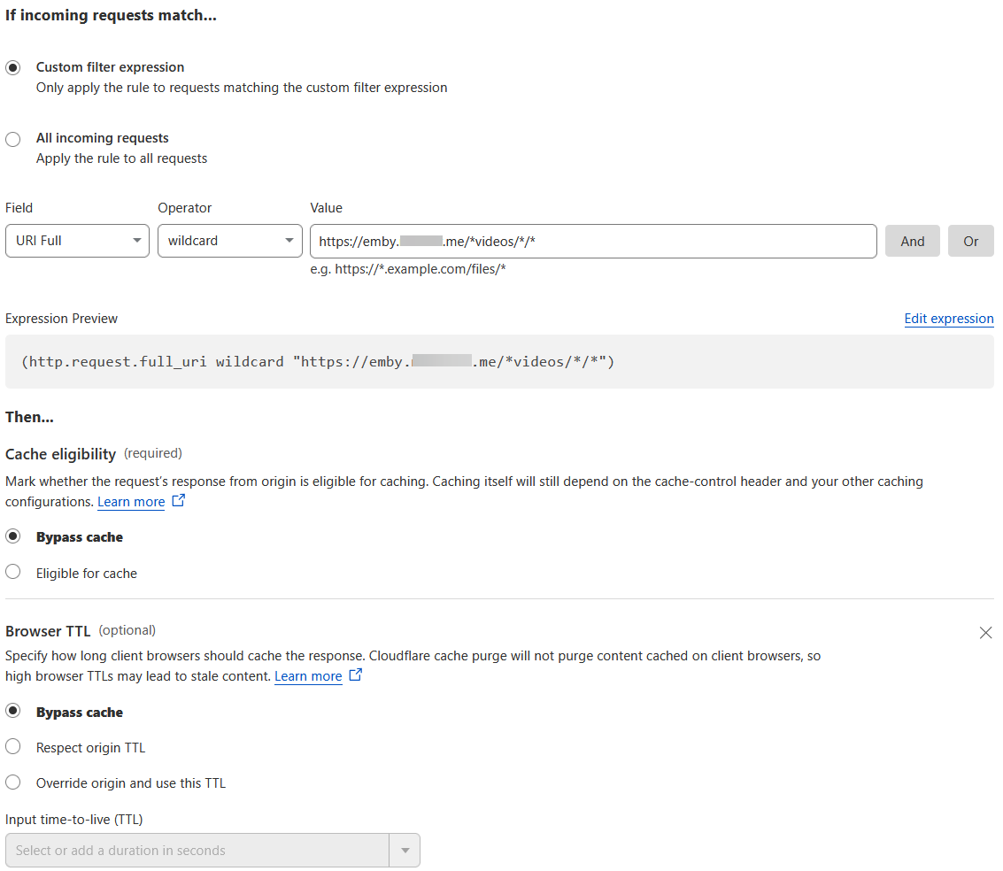

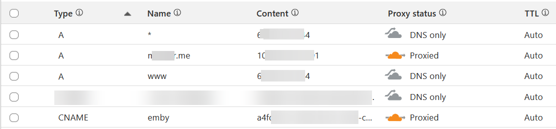

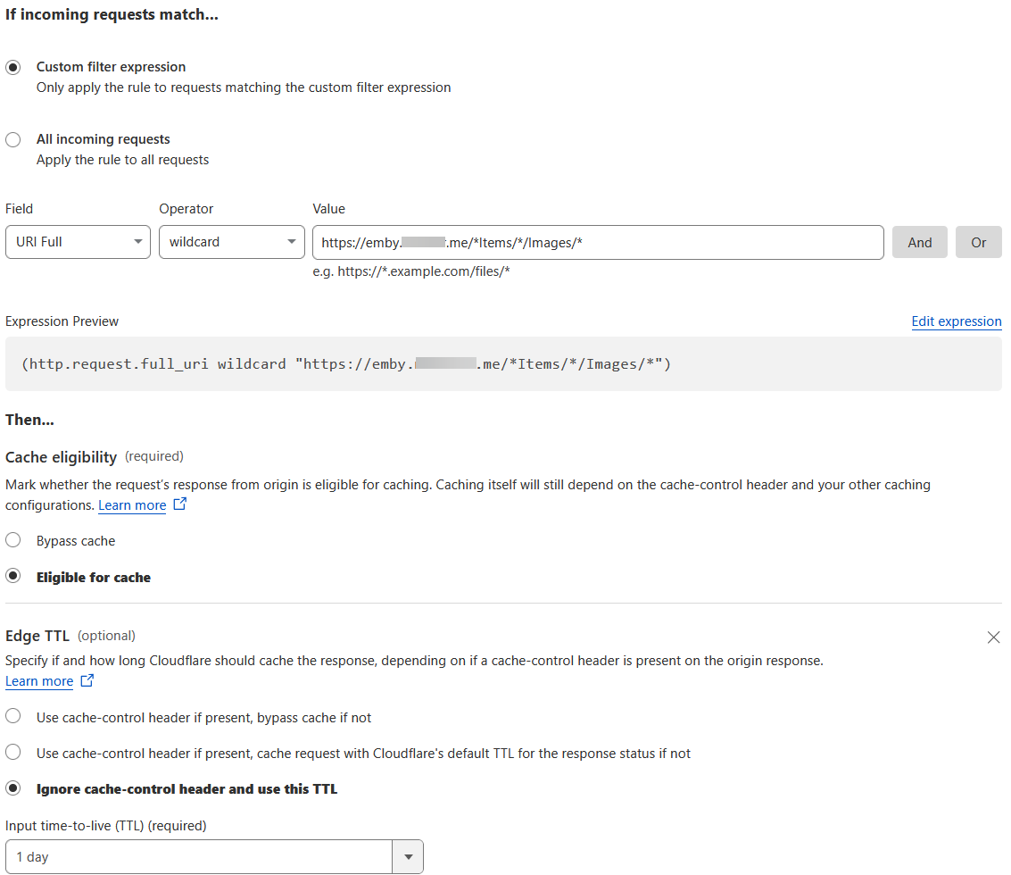

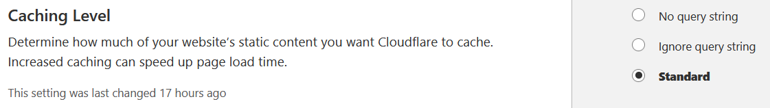

Hello,
I'm having troubles getting Cloudflare to work correctly with my Emby server. I had created a separate post for this, but Luke suggested I review this thread to see if I have a configuration problem. With so many pages to go through, I hope I got the up-to-date settings out of all of this.
For the most part it works, with the notable exception that if you pause a show, leave and come back, it either 'spins' forever, or just starts playing from the beginning again.
My setup:  Synology NAS hosting a licensed copy of Emby Server. No ports are open on the router.
(Also, when I got started, I didn't realize that streaming video was against Cloudflare's TOS. So if there's a better option, that allows me to not open ports AND is easy for a few friends/family to use the Emby app on their smart device (i.e., no VPN's), that would be great.)
Here are my CF settings:
Cache rules:
Relevant DNS records:

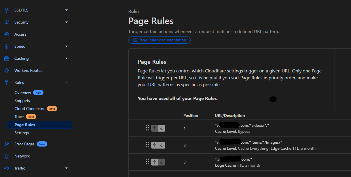

Dunno if this helps.  A load to read through yes.
I still have this from my OLD cache rules - which are done in the rules/page rules.  But I no longer play through CF (see end of this post for what I do now).
My CF is also connected via a tunnel - not that it matters to the config.
The *'s are very critical to NOT cache - but as I said, all this videos stuff is redirected direct now and bypassing CF so the cache it not really relevent - but I leave it there in case of rollback to CF - which I had to do recently when my reverse proxy had an issue - it was simply a disable of the redirect rules.
I never had all that other stuff you have in yours.

Removing the cache rules, and only using the page rules seems to fix most my problems. It's still possible that a video ends up getting replayed from the beginning after a 'pause and later resume,' but it does seem much more stable now.
Sounds complicated, but I'll look into your/horsePDF's solution to see if that would fit better for my needs as well. Thanks again!

34 minutes ago, MarkKelly70 said:
Thanks so much, @vaise!
Cool.  Dont forget to take advantage of the free cloudflare WAF rules to further lock down your instance.
If you have a reverse proxy already in use (like many people did before finding cloudflare), then it really is not complicated to redirect your 'playback' to direct.
In a nutshell :
1 - create a non cloudflare cached dns record pointing to embyredirect.mydomain.com
2 - create a listen for embyredirect.mydomain.com in your reverse proxy.
3 - Add redirect rules to cloudflare for the 'playback' urls to go direct.
vaise
Can I also ask - if you are hosting your own server on your own lan, why is it going to cloudflare ?  All my local devices go direct to the IP of my emby server, hence are not affected when there is an internet outage etc, plus simply faster.
