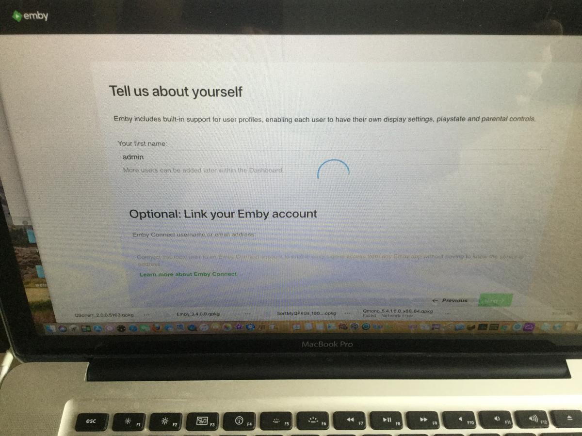

MAVER!CK 0 Posted July 4, 2018 Posted July 4, 2018 Hi I’m trying to install the server on my TS-453a and I get to the screen in the photo and it just hangs. I’ve try removing emby from the nas and reinstalling and still the same. Qmono and ffmpeg are both installed.

MAVER!CK 0 Posted July 5, 2018 Author Posted July 5, 2018 First off thanks for the help. This is my first NAS so still finding my feet. Basically the when I try to run emby I either get to the screen that I first post and when I click next it just hangs with the busy circle ️ going round and round, I’ve left it over an hour and nothing changes or it just state the attached picture.

MAVER!CK 0 Posted July 6, 2018 Author Posted July 6, 2018 I see one or the other pictures I posted in my previous post. If I get the first picture I get the choose your language screen, I can click next then move on to the tell us about yourself screen, when I click next on that screen it just hangs.

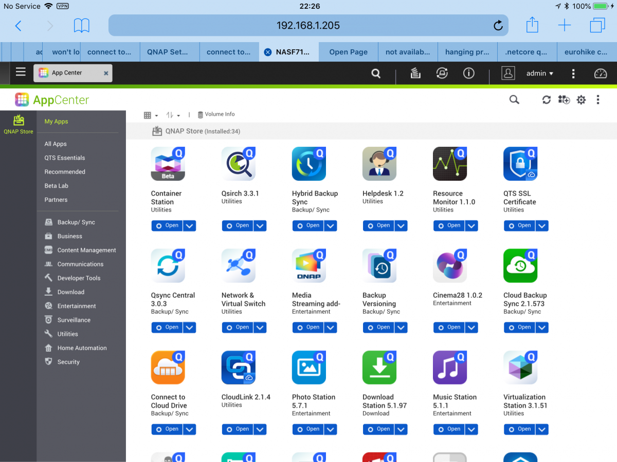

PenkethBoy 2068 Posted July 6, 2018 Posted July 6, 2018 Yes it is - but some have reported issues some have it working fine QNAP - have had four bad firmware versions in the last couple of months What other packages do you have installed on your QNAP?
MAVER!CK 0 Posted July 6, 2018 Author Posted July 6, 2018 Here are all the packages I have installed.
PenkethBoy 2068 Posted July 6, 2018 Posted July 6, 2018 I only have 2 other than the 5 of the remaining standard ones a lot of yours are all to do with media management - as you are new to the NAS you are trying things out which is fine - but when you get emby working the vast majority of those packages you can uninstall as they are poor to useless
