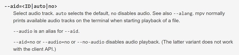

Guest asrequested Posted January 23, 2018 Posted January 23, 2018 @@Luke maybe you could make use of this, in conjunction with ffprobe? An if this then that. If MP2 is 1, then choose 2? https://mpv.io/manual/stable/#options-aid I've been trying to get the audio-remove command to work, but can't seem to. https://mpv.io/manual/stable/#command-interface-audio-remove
