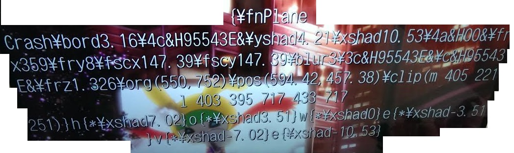

Ponyo 22 Posted February 23, 2016 Author Posted February 23, 2016 Luke, I've sent you a PM with regards to the sample file. I've did some more testing, all files are playing fine when transcoding for playback in Firefox (vpx, vorbis). However, both the android app en dlna aren't working as soon as I enable .ass/.vobsub subs. The transcoder shows these files as being transcoded to h264/aac. Containers are different too but forgot to write them down. Could it be an issue with the formats Emby is trying to encode these files/subs to? I've attached the created when play the .ass sub file on my tv. Strangly no transcode log is generated by the tv does show a error after which subtitles stop playing (right before that its actually showing subs). If I open the .vobsub file, it does generate a log but no subs are shown. The tv is a 3 ~4 year old LG. The Yen signs are slashes. server-63591849432.txt

Luke 42186 Posted February 24, 2016 Posted February 24, 2016 The transcoder isn't crashing, but rather the android video player doesn't like the output for some reason so it stops playing. i'm looking into it.
Luke 42186 Posted February 24, 2016 Posted February 24, 2016 I've put a fix for android up on the open beta http://emby.media/community/index.php?/topic/24350-android-open-beta-testing
