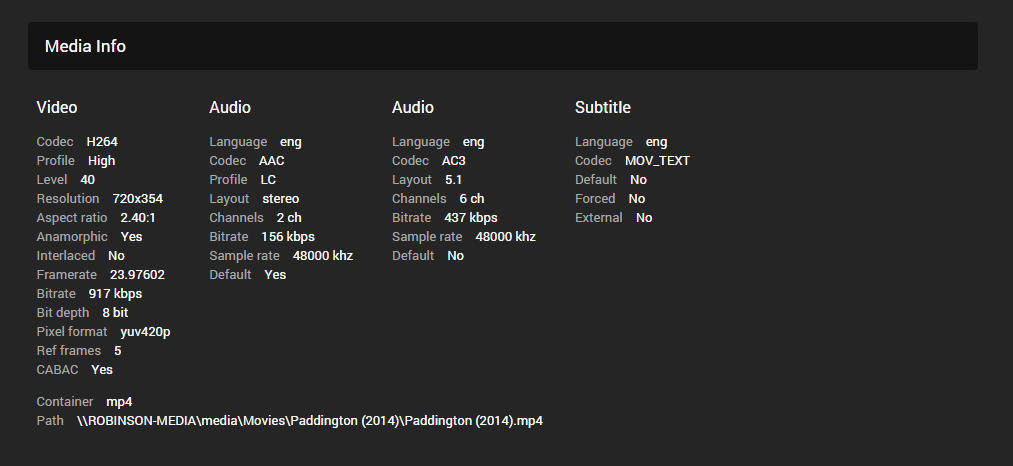

mediacowboy 438 Posted May 6, 2015 Author Posted May 6, 2015 (edited) I don't think this is related to Framerate as I have a movie that isn't getting a bif file created and it has a Framerate of 23.97602. It looks like it may be the Ref frames. This is a 5 but the Roku BIF creator need a 4 or less. Which I don't recall seeing before is that something new? Or it may be a combination of things. Any help from a Dev would be awesome. Edited May 6, 2015 by mediacowboy
mediacowboy 438 Posted May 6, 2015 Author Posted May 6, 2015 (edited) the server log will contain the reason Luke, This is what I found for this movie in the log's 2015-05-06 08:27:12.4324 Debug - App: Profile: Roku Thumbnails, Path: \\ROBINSON-MEDIA\media\Movies\Paddington (2014)\Paddington (2014).mp4, isEligibleForDirectPlay: True, isEligibleForDirectStream: True 2015-05-06 08:27:12.4324 Debug - App: Profile: VideoCodecProfile, DirectPlay=false. Reason=Roku Thumbnails.RefFrames Condition: LessThanEqual. ConditionValue: 4. IsRequired: False. Path: \\ROBINSON-MEDIA\media\Movies\Paddington (2014)\Paddington (2014).mp4 But this is happening on a lot of my files. When it use to work just like on the one I showed that started this thread. I really do appericate your help and all that you and the team have done. Edit: If you need more log file let me know. It is to big to upload to the paste2 site. Edited May 6, 2015 by mediacowboy

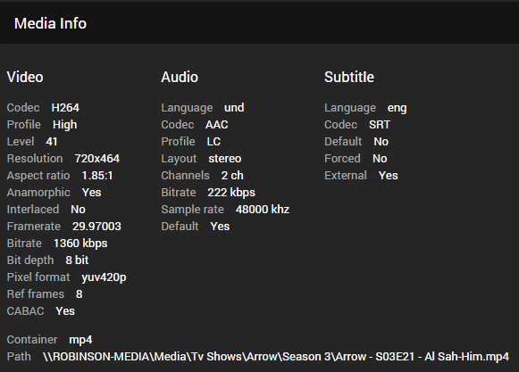

mediacowboy 438 Posted May 7, 2015 Author Posted May 7, 2015 @@Luke, What does this mean, Reason=Roku Thumbnails.IsAnamorphic? 2015-05-07 12:10:23.5081 Debug - App: Profile: Roku Thumbnails, Path: \\ROBINSON-MEDIA\Media\Tv Shows\Arrow\Season 3\Arrow - S03E21 - Al Sah-Him.mp4, isEligibleForDirectPlay: True, isEligibleForDirectStream: True 2015-05-07 12:10:23.5081 Debug - App: Profile: VideoCodecProfile, DirectPlay=false. Reason=Roku Thumbnails.IsAnamorphic Condition: Equals. ConditionValue: false. IsRequired: False. Path: \\ROBINSON-MEDIA\Media\Tv Shows\Arrow\Season 3\Arrow - S03E21 - Al Sah-Him.mp4 I am seeing it on more then just this show is why I ask.
mediacowboy 438 Posted May 9, 2015 Author Posted May 9, 2015 Anyone able to tell me what I need to do to get these files fixed so they can get BIF files.
farside847 39 Posted May 11, 2015 Posted May 11, 2015 I ran into this too. It wants videos that have 4 or less reframes, and 30 or less fps. Even though the roku3 will play the files directly I think it is trying to maintain compatibility with all the older roku boxes that could not handle them. I had to re encode some of my files.
mediacowboy 438 Posted May 11, 2015 Author Posted May 11, 2015 @@farside847, What did you use to re encode? Also re encoding also fix the IsAnamorphic issue?

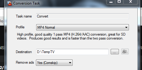

mediacowboy 438 Posted May 12, 2015 Author Posted May 12, 2015 Do you mind sharing a screen shot of the mcebuddy? Also how do you do the commercial cutting, show analyzer or comskip?
mediacowboy 438 Posted May 13, 2015 Author Posted May 13, 2015 (edited) Ok, I know this may come off as me being upset. Which I kinda of am. Everything was working great with the roku plugin until two verison ago. I dont mind having to re encode my stuff but when the only reason it wont create a bif is because we are looking to see if the file is scalable. Sounds weird. 2015-05-12 18:45:28.3300 Debug - App: Profile: Roku Thumbnails, Path: \\ROBINSON-MEDIA\media\TempTV\Arrow\Season 3\Arrow - S03E21 - Al Sah-him.mp4, isEligibleForDirectPlay: True, isEligibleForDirectStream: True 2015-05-12 18:45:28.3300 Debug - App: Profile: VideoCodecProfile, DirectPlay=false. Reason=Roku Thumbnails.IsAnamorphic Condition: Equals. ConditionValue: false. IsRequired: False. Path: \\ROBINSON-MEDIA\media\TempTV\Arrow\Season 3\Arrow - S03E21 - Al Sah-him.mp4 Anamorphic - having or producing unequal magnifications along two axesperpendicular to each other. I understand wanting that feature in the file but why do we need to check for it in a BIF(Base Index Frames) which dont even show full screen? Please tell me I am not losing my mind when it comes to this feature. P.S. I have even ran files back through handbrake and still get the same results. Even using Rokoding's 480p Film setting's. Edited May 13, 2015 by mediacowboy

mediacowboy 438 Posted May 14, 2015 Author Posted May 14, 2015 After re encoding I did not refresh but I didn't need to. I used a different folder to store the new encoding in. See the different paths between the pic in post 12 and post 18. My biggest gripe is this worked for the longest time no issue's. Both my rip's and recording worked. Even with the frame rate being up in the 59 range. I do apologize for the rudeness last night I was just having a bad day and want this to work like it did. Also waiting to hear back from other devs that I am trying to help test stuff for. What profile are you using in MCEBuddy? I was just using the standard one and everything worked. It wasn't until more recently that it stopped working. Maybe two versions ago I think.

mediacowboy 438 Posted May 15, 2015 Author Posted May 15, 2015 @@farside847, I am not seeing that as a profile option. What verison MCEBuddy you running?
