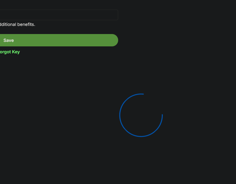

AHrubik 2 Posted May 21 Posted May 21 (edited) After updating my Emby Premier key is not registering and I get a spinning wheel on the admin page trying to save it. I've restarted and reinstalled. Blanked it out, shutdown and resaved it. All results in the spinning wheel and the "get emby premier" button at the top of the page. Edit: This seems to be resolved after I cleared the mb3 domain through noscript. This is something I have not had to do before so I'm not sure what's changed in the code. Edited May 21 by AHrubik Resolved. 1
Suliamu 57 Posted May 21 Posted May 21 4 hours ago, AHrubik said: Edit: This seems to be resolved after I cleared the mb3 domain through noscript. This is something I have not had to do before so I'm not sure what's changed in the code. Same here. And i haven't even updated. Still on 4.9.1.90.
