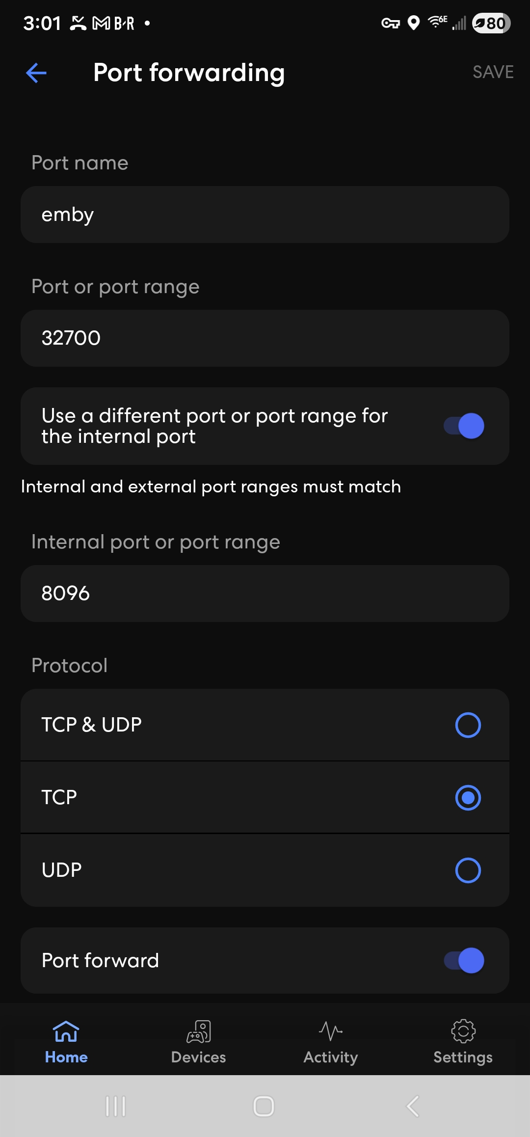

sa2000 881 Posted March 19 Posted March 19 (edited) 16 minutes ago, Zenith Media said: 16 minutes ago, Zenith Media said: Port Forwarding 8096-32700 I am concerned this might be a port range 8096 to 32700 Do you have a screen in the eero app like the one below?s If you do, then it needs to be: Name: Emby Port or Port Range: 32700 Use a different port or port range for the internal port: enabled Internal Port or Port Range: 8096 Protocol: TCP ticked and saved Then in Emby Server Network Settings you keep Local http port as 8096 and you set Public Http port as 32700 and you have "Enable automatic port mapping" unticked and Save I am assuming you have "Secure Connections Mode" as "Disabled" If your eero app screen is different, let me have a screenshot Edited March 19 by sa2000
sa2000 881 Posted March 19 Posted March 19 that is good. you don't need to have udp for this - so sufficient for TCP to be ticked Lets check the server network settings - for ports and automatic mapping and secure connections
sa2000 881 Posted March 19 Posted March 19 great - only one thing to change: Public http port number - change from 8096 to 32700 and save
sa2000 881 Posted March 19 Posted March 19 If you can get me a screenshot of the eero app with tcp only ticked and not with udp, i will use it as an example in the documentation
