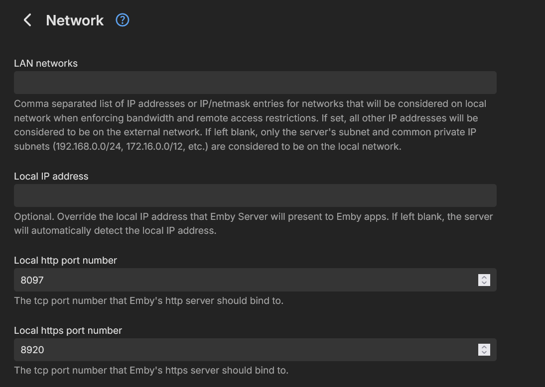

tedfroop21 89 Posted November 9, 2025 Posted November 9, 2025 Another option may be to set the local IP under the Network options. I would imagine it would lock to the local address if you entered it. I played with this and you can have the server use tailnet or not. I was testing to see if it worked with my setup but the Roku networking has issues with it. Set it back to dhcp ip and all worked OK again. 1
