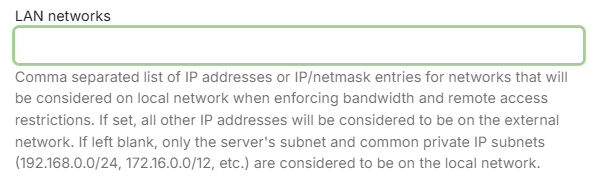

    LAN Networks
    If you have more than one local network subnet, you may need to use this setting to define the IP subnets that are deemed to be local. Also if using a vpn on the router, you should use this setting to add the local subnet address range used by the vpn. When there is more than one subnet, enter here all the IP subnets that are to be treated as local network subnets, including the subnet the Emby server is connected to.
    This setting is used when enforcing bandwidth controls and remote access controls.
    When the LAN Networks field is filled, any subnet not defined here will be deemed external and the remote access controls and external bandwidth restrictions would apply. If left blank, only the server's subnet and common private IP subnets are considered to be on the local network. See example below.
    Here is an example of two 256-addresses subnets defined as being local for the server: 192.168.1.0/24,10.253.0.0/24.
    Important
    When specifying IP subnets, make sure you use the correct netmask/cidr value. A /24 denotes 256 addresses
    Note
    The system API is used to determine if an IP Address is local. For the 192.168.x.x and 172.x.x.x subnets shown above, there is an override where they would always be classed as local. If you find that your 10.x.x.x subnet is not classed as local, enter the subnet together with the subnet for the server in the LAN Networks field.
    Important
    You should only use this setting, if you know you need it. Once you configure, you will need to keep it up to date - in event of network subnet changes.

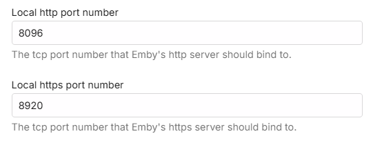

    Local Ports
    This allows you to specify both the http and https local ports that the server should bind to and use. The https port would be used if secure connections (SSL) are enabled. Whilst the local ports can be customized, it is recommended that you leave them as per the default.

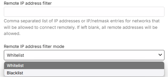

    Remote Connections IP Address Filters
    You have the option to restrict remote connections to be allowed only from specific public IP addresses or IP Address subnets. The reverse is also possible, blocking specific remote IP addresses and subnets. When left blank, all remote addresses would be allowed.

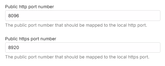

    Public Ports
    This allows you to specify both the http and https external public WAN ports that the server should use when reporting its external url to Emby clients. The https port would be used if secure connections (SSL) are enabled. By default, these ports are the same as the local port numbers. You can choose alternative port numbers and in some cases - eg if having more than one server with remote connections enabled, you would need to use different public/WAN port numbers. For added security, you may also decide to having a non standard public port number. More details about added security in this article Secure Your Server.

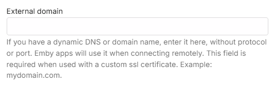

    External Domain
    When using a Dynamic DNS service (DDNS) or a domain name, enter it here without the port number. Emby apps will use this when connecting remotely. The field should be used when a custom SSL certificate is used for Secure Connections. Example: mydomain.com

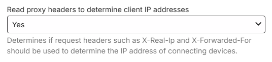

    Checking Proxy headers to determine real client IP addresses
    The setting is on by default and gives added security where the server checks request headers such as X-Real-Ip or X-Forwarded-For to determine the real IP address of the sender.
    Optionally you can disable it or limit it to just check when the headers indicate the request is from an external source.

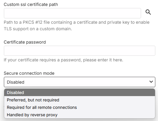

    Secure Connections (https / SSL)
    To enable secure connections, you will need to acquire a certificate and provide the filesystem path to the certificate and the certificate password. By default, use of https for requests made to the server is disabled. The path is to be to a PKCS #12 file containing a certificate and private key to enable TLS support on a custom domain. The Certificate password should be entered if it requires a password.
    Three secure connections modes are available to choose from,
    • Preferred, but not required
    • Required for all remote connections
    • Handled by reverse proxy
    Important
    Some legacy devices may not be able to connect to the server using https. In such environments, do not use the "Required for all remote connections" mode.
    Note
    Please ensure that you are using the latest versions available for Emby Apps.
    For detailed information on setting up secure connections, refer to this section Using secure https connections in the Secure Your Server article.

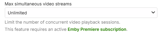

    Streaming Controls
    With Emby Premiere, you can limit the number of concurrent video streams on the server. By default there is no limit.

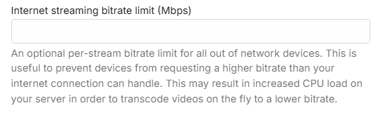

    Internet streaming bitrate limit
    You have an option to specify the streaming bitrate limit in Mbps for streaming to remote devices. This limit is per stream. Bandwidth limits are not enforced by default. For the combined demand of several remote streams, see upload bandwidth.

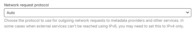

    Network Request Protocol
    This allows you to optionally disable iPv6 for outgoing requests made by Emby Server. Selecting iPv4 instead of Auto would disable use of iPv6 for outgoing requests.
