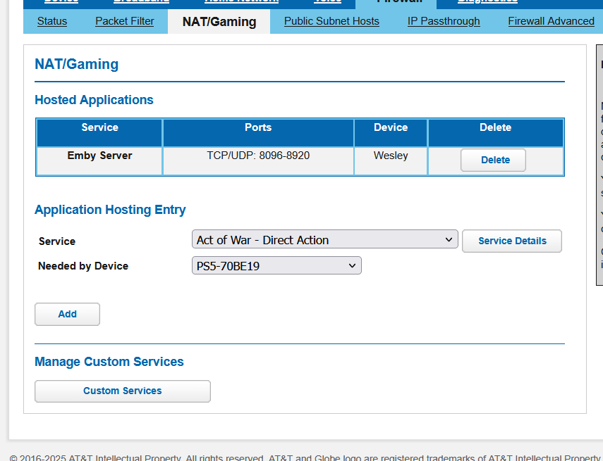

goner 3 Posted April 29, 2025 Author Posted April 29, 2025 (edited) I have tried to open ports in my modem/ router. It is an att fiber modem and I am pretty sure that I didin't do it right. I have gone into my firewall on windows and verified that ports are open. I have also made sure that everything is on in the Emby setup for external viewing. In the setup it says that my server is running on both that local (LAN) and the external (WAN) access. I still have the Plex server running for now. I assumed that Emby would work the same way as Plex. Edited April 29, 2025 by goner

Solution seanbuff 1353 Posted May 1, 2025 Solution Posted May 1, 2025 Looks like you may have opened up a range between 8096 and 8920, I would recommend that you only open specific ports, and not an entire range. i.e. add a service for only 8096, and another for 8920 if you are using TLS I assume "Wesley" is the host device that has your Emby Server installed on it?
goner 3 Posted May 1, 2025 Author Posted May 1, 2025 I have no idea how to do that though. I don't want to mess anything else up so that nothing else works either. Can you explain to me how I would do such a thing? Thank you everyone for your replies. It is great to have people that want to help us lost souls, lol.

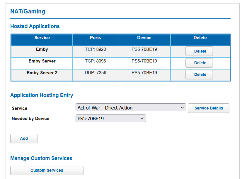

goner 3 Posted May 1, 2025 Author Posted May 1, 2025 (edited) I hope that this is what you were talking about seanbuff. BTW, what is TLS and what is it utilized for? Also, How do I check to see if cgNAT is my issue? Yes Wesley is my device. Edited May 1, 2025 by goner
seanbuff 1353 Posted May 2, 2025 Posted May 2, 2025 1 hour ago, goner said: I hope that this is what you were talking about seanbuff. Looking better, one port per service. Not sure what UDP port 7359 would be used for though? The device you have specified, is that really pointing at a PlayStation 5? The "Device" field needs to point to the host machine on your network where your Emby Server is installed, usually a Windows PC or NAS. 1 hour ago, goner said: what is TLS and what is it utilized for? Also, How do I check to see if cgNAT is my issue? TLS is used to secure your remote connections to your Emby Server over HTTPS. TLS and cgNAT are all explained in more detail here: Connecting from Client Apps and Secure Your Server

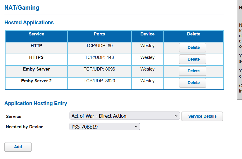

goner 3 Posted May 3, 2025 Author Posted May 3, 2025 This is now what I have set up. Not sure if I need the http and the https ports.
seanbuff 1353 Posted May 4, 2025 Posted May 4, 2025 1 hour ago, goner said: This is now what I have set up. Not sure if I need the http and the https ports. This is looking better, although you don't need ports 80 and 443 forwarded unless you're running some kind of Reverse Proxy on 'Wesley' -- i would remove those if not. So with port 8096 now forwarded to Wesley (Emby Server) -- what is the experience from outside your local network?

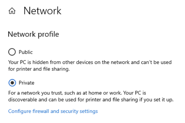

seanbuff 1353 Posted May 5, 2025 Posted May 5, 2025 9 hours ago, goner said: I just did an ipconfig and it doesn't show an ip address that is in that range. You'll need to check a site like https://whatismyipaddress.com/ to see your Public IP to see if it falls in that range, ipconfig will typically only show you your local IP address on that host. 9 hours ago, goner said: I am running it on a Windows Workstation. Can you check that your network profile is set to 'Private' and not Public? Right-click the Network or Wi-Fi icon on the taskbar, then select 'Network and Internet settings'
