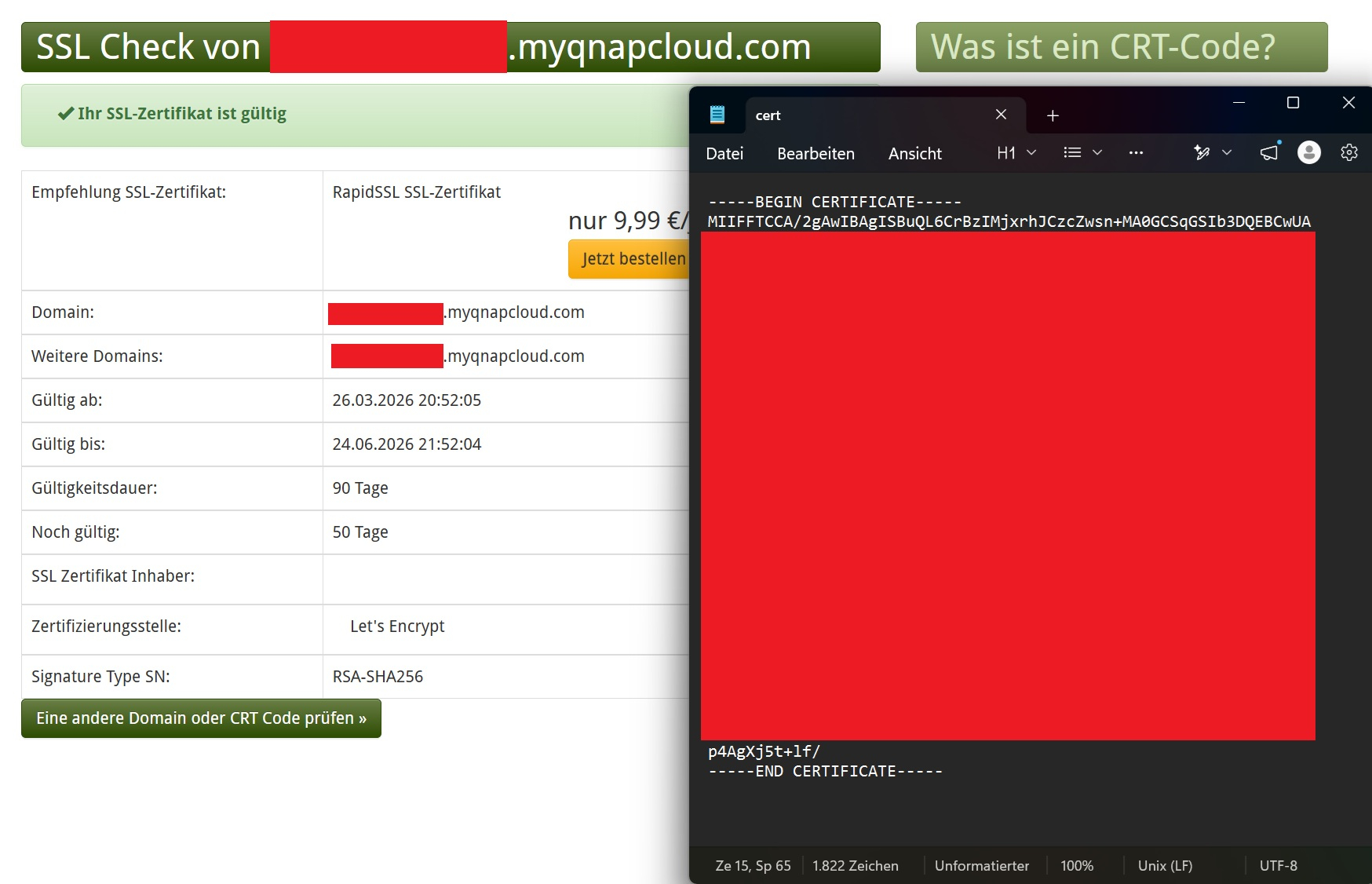

renefw 9 Posted May 5 Posted May 5 Thank you for your feedback: I've now tried it. It seems to be working without an error message. Unfortunately, the same issue occurs as with the old script. The message "The certificate key has not changed" appears. Therefore, I downloaded the certificate from /mnt/sync/.config/QcloudSSLCertificate/cert and examined it. It is the current certificate, as I suspected from the date. Here is a screenshot. I have obscured the sensitive data with a red box. The domain is also correct. What is the problem with the old script and now with this one that, on the one hand, it doesn't recognize that the certificate and key have changed, and therefore the emby.p12 file isn't updated? Tue May 5 01:00:00 PM CEST 2026 - Certificate key has not changed CERT_DIR: /mnt/sync/.config/QcloudSSLCertificate/cert CRT_FILE: /mnt/sync/.config/QcloudSSLCertificate/cert/cert KEY_FILE: /mnt/sync/.config/QcloudSSLCertificate/cert/key Tue May 5 01:00:00 PM CEST 2026 - Certificate key has not changed If you would like it and it would be helpful, I can also send you the certificate file as a private message.

renefw 9 Posted May 5 Posted May 5 I inserted the specified line before the one described. I added the page to the check-p12.log file and ran the script. The log file still contains exactly the same information as before. No new entries were added. The following was displayed via Putty: File: /mnt/sync/.config/QcloudSSLCertificate/cert Size: 12 Blocks: 17 IO Block: 4096 directory Device: 1fh/31d Inode: 423 Links: 4 Access: (0777/drwxrwxrwx) Uid: ( 0/ admin) Gid: ( 0/administrators) Access: 2026-05-05 12:00:01.000000000 Modify: 2026-05-05 11:37:00.000000000 Change: 2026-05-05 11:37:00.000000000

renefw 9 Posted May 5 Posted May 5 [~] # stat /mnt/sync/.config/QcloudSSLCertificate/cert/cert File: /mnt/sync/.config/QcloudSSLCertificate/cert/cert Size: 1822 Blocks: 9 IO Block: 2048 regular file Device: 1fh/31d Inode: 2112 Links: 1 Access: (0644/-rw-r--r--) Uid: ( 0/ admin) Gid: ( 0/administrators) Access: 2026-05-04 22:08:00.000000000 Modify: 2026-03-26 21:50:38.000000000 Change: 2026-03-26 21:50:38.000000000 [~] # ls -ail /mnt/sync/.config/QcloudSSLCertificate/cert total 78 423 drwxrwxrwx 4 admin administrators 12 2026-05-05 11:37 ./ 421 drwxrwxrwx 4 admin administrators 4 2026-01-10 18:11 ../ 1272 drwxr-xr-x 2 admin administrators 3 2026-01-19 20:51 account/ 2112 -rw-r--r-- 1 admin administrators 1822 2026-03-26 21:50 cert 2113 -rw-r--r-- 1 admin administrators 1801 2026-03-26 21:50 chain 1700 -rw-r--r-- 1 admin administrators 3522 2026-05-05 11:37 combine 1598 -rw-rw-rw- 1 admin administrators 956 2026-03-26 21:50 csr 1275 -rwxr--r-- 1 admin administrators 7521 2026-03-26 21:50 csr.cnf* 1607 -rw-rw-rw- 1 admin administrators 3000 2026-03-26 21:50 intermediate.pem 2110 -rw------- 1 admin administrators 1700 2026-03-26 21:50 key 1635 -rw-rw-rw- 1 admin administrators 7104 2026-03-26 21:50 local_post_content 1270 drwxr-xr-x 3 admin administrators 3 2026-01-15 20:05 .well-known/ I inserted a space before /mnt/.. because otherwise an error message would be displayed. [~] # stat/mnt/sync/.config/QcloudSSLCertificate/cert/cert -sh: stat/mnt/sync/.config/QcloudSSLCertificate/cert/cert: No such file or directory [~] # ls -ail/mnt/sync/.config/QcloudSSLCertificate/cert /bin/ls: invalid option -- '/' Try `/bin/ls --help' for more information.
sa2000 890 Posted May 5 Posted May 5 4 minutes ago, renefw said: I inserted a space before /mnt/.. because otherwise an error message would be displayed. I did have a space on the command line between "stat" and "/mnt" 4 minutes ago, renefw said: Modify: 2026-03-26 21:50:38.000000000 Change: 2026-03-26 21:50:38.000000000 5 minutes ago, renefw said: 2112 -rw-r--r-- 1 admin administrators 1822 2026-03-26 21:50 cert 2113 -rw-r--r-- 1 admin administrators 1801 2026-03-26 21:50 chain 1700 -rw-r--r-- 1 admin administrators 3522 2026-05-05 11:37 combine 1598 -rw-rw-rw- 1 admin administrators 956 2026-03-26 21:50 csr 1275 -rwxr--r-- 1 admin administrators 7521 2026-03-26 21:50 csr.cnf* 1607 -rw-rw-rw- 1 admin administrators 3000 2026-03-26 21:50 intermediate.pem 2110 -rw------- 1 admin administrators 1700 2026-03-26 21:50 key 1635 -rw-rw-rw- 1 admin administrators 7104 2026-03-26 21:50 local_post_content 1270 drwxr-xr-x 3 admin administrators 3 2026-01-15 20:05 .well-known/ interesting - all files except the "combine" file have 26th March as last modified date -so that is the issue You are sure the cert and key files are new ? They have last modified date and time for 26 March We can check for the combine file change in the script #!/bin/sh now="$(date)" # Password for exported PFX PFX_PASSWORD="my password" # Output file PFX_FILE="/share/SSL-Certificate/emby.p12" # Log file PFX_Log="/share/SSL-Certificate/check-p12.log" # Search filesystem for latest QNAP cert file CRT_FILE=$(find /mnt -type f -name "cert" 2>/dev/null \ | while read -r file; do stat -c "%Y %n" "$file" done \ | sort -nr \ | head -n 1 \ | cut -d' ' -f2-) if [ -z "$CRT_FILE" ]; then echo "$now - No certificate file found." >> $PFX_Log exit 1 fi CERT_DIR=$(dirname "$CRT_FILE") KEY_FILE="$CERT_DIR/key" echo "CERT_DIR: $CERT_DIR" >> $PFX_Log echo "CRT_FILE: $CRT_FILE" >> $PFX_Log echo "KEY_FILE: $KEY_FILE" >> $PFX_Log if [ ! -f "$KEY_FILE" ]; then echo "$now - Private key not found: $KEY_FILE" >> $PFX_Log exit 1 fi COMBINE_FILE="$CERT_DIR/combine" if ! find "$CERT_FILE" -mtime -1 | grep -q .; then if ! find "$COMBINE_FILE" -mtime -1 | grep -q .; then echo "$now - Certificate & Combine files have not changed" >>$PFX_Log exit 1 else echo "$now - Certificate combine file has changed - will pick the cert and key files" >>$PFX_Log fi echo "$now - Using certificate directory: $CERT_DIR" >> $PFX_Log echo "$now - Certificate: $CRT_FILE" >> $PFX_Log echo "$now - Private Key: $KEY_FILE" >> $PFX_Log echo "$now - combine file: $COMBINE_FILE" >> $PFX_Log # Build the OpenSSL command OPENSSL_CMD="openssl pkcs12 -export \ -out \"$PFX_FILE\" \ -inkey \"$KEY_FILE\" \ -in \"$CRT_FILE\" \ -passout pass:$PFX_PASSWORD" # rename existing pfx file mv -f $PFX_FILE $PFX_FILE.old 2>/dev/null # Execute eval "$OPENSSL_CMD" if [ $? -eq 0 ]; then echo "$now - PFX successfully created: $PFX_FILE" >> $PFX_Log else echo "$now - PFX creation failed." >> $PFX_Log exit 1 fi fi
renefw 9 Posted May 5 Posted May 5 The spacebar wasn't visible to me. I'm certain that the certificate and key are valid from March 26, 2026. As you can see from the screenshot in my message from an hour ago, it's valid from March 26, 2026, 8:52:05 PM to June 24, 2026, 9:52:04 PM. You can also verify this yourself, as I sent you the certificate as a private message. The certificate in the emby.p12 file (which I also sent you privately) was created on January 22, 2026, expired after 90 days, and is therefore no longer valid. How can this problem be resolved? I updated the script as sent. The following was displayed in the check-p12.log: CERT_DIR: /mnt/sync/.config/QcloudSSLCertificate/cert CRT_FILE: /mnt/sync/.config/QcloudSSLCertificate/cert/cert KEY_FILE: /mnt/sync/.config/QcloudSSLCertificate/cert/key Tue May 5 03:44:05 PM CEST 2026 - Certificate combine file has changed - will pick the cert and key files Tue May 5 03:44:05 PM CEST 2026 - Using certificate directory: /mnt/sync/.config/QcloudSSLCertificate/cert Tue May 5 03:44:05 PM CEST 2026 - Certificate: /mnt/sync/.config/QcloudSSLCertificate/cert/cert Tue May 5 03:44:05 PM CEST 2026 - Private Key: /mnt/sync/.config/QcloudSSLCertificate/cert/key Tue May 5 03:44:05 PM CEST 2026 - combine file: /mnt/sync/.config/QcloudSSLCertificate/cert/combine Tue May 5 03:44:05 PM CEST 2026 - PFX successfully created: /share/cmd/SSL-Certificate/emby.p12 CERT_DIR: /mnt/sync/.config/QcloudSSLCertificate/cert CRT_FILE: /mnt/sync/.config/QcloudSSLCertificate/cert/cert KEY_FILE: /mnt/sync/.config/QcloudSSLCertificate/cert/key Tue May 5 04:00:00 PM CEST 2026 - Certificate combine file has changed - will pick the cert and key files Tue May 5 04:00:00 PM CEST 2026 - Using certificate directory: /mnt/sync/.config/QcloudSSLCertificate/cert Tue May 5 04:00:00 PM CEST 2026 - Certificate: /mnt/sync/.config/QcloudSSLCertificate/cert/cert Tue May 5 04:00:00 PM CEST 2026 - Private Key: /mnt/sync/.config/QcloudSSLCertificate/cert/key Tue May 5 04:00:00 PM CEST 2026 - combine file: /mnt/sync/.config/QcloudSSLCertificate/cert/combine Tue May 5 04:00:00 PM CEST 2026 - PFX successfully created: /share/cmd/SSL-Certificate/emby.p12 The last line is what puzzles me. Why does it say that the PFX file was created successfully? The file already existed. The entry was simply added to it.
