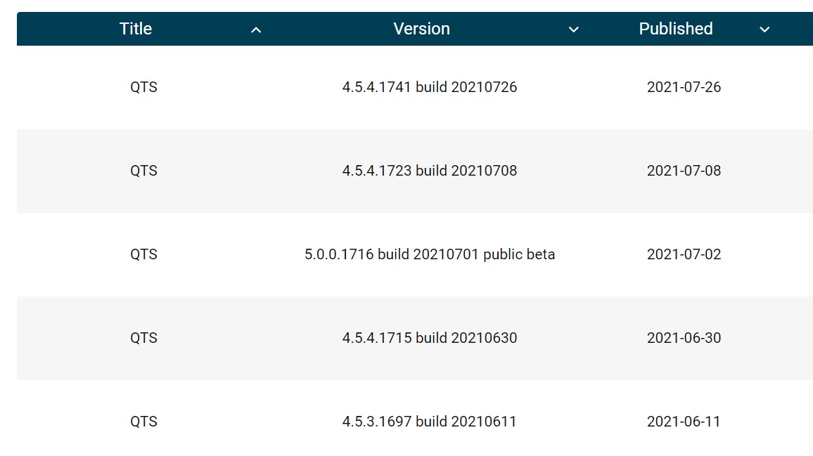

NiftieNev 1 Posted September 14, 2021 Posted September 14, 2021 H, I have the same problem as above. I was running Emby Server just fine until I used the internal command to stop the server and apply an update. I removed the server as per the commands and tried to installed the updated version. The server would not install. It returned the error : Error 2021-09-14 17:16:46 admin 192.168.0.21 App Center App Installation [App Center] Failed to install EmbyServer. Try again later. I have tried everything I know (not a lot) but I cannot get my fantastic Movie Server to install. System info QNAP TS-541D2 Firmware Ver: 5.0.0.1716 4Gb memory EMBY Premiere User
NiftieNev 1 Posted September 14, 2021 Posted September 14, 2021 I read what was said about QTS 5.x.x so I tried to roll back the software. The QNAP server has older version 4s but it also has newer ver 4 files after the ver 5 one. So I installed a newer ver 4 and Emby installed just fine. See attached
