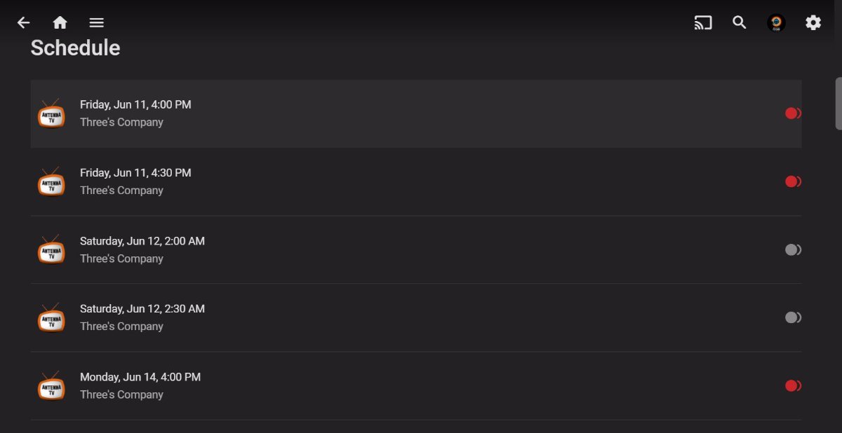

clarkss12 299 Posted June 11, 2021 Posted June 11, 2021 It appears that Emby has stopped recording my scheduled TV shows............ The last recoded shows was June 8, so it has missed a lot of recordings. Threes company is scheduled to record today at 4pm, but I doubt it will record. See attached photos.
clarkss12 299 Posted June 11, 2021 Author Posted June 11, 2021 As expected, nothing recorded......... What can I try???
