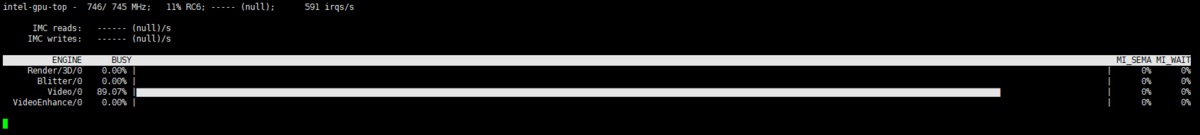

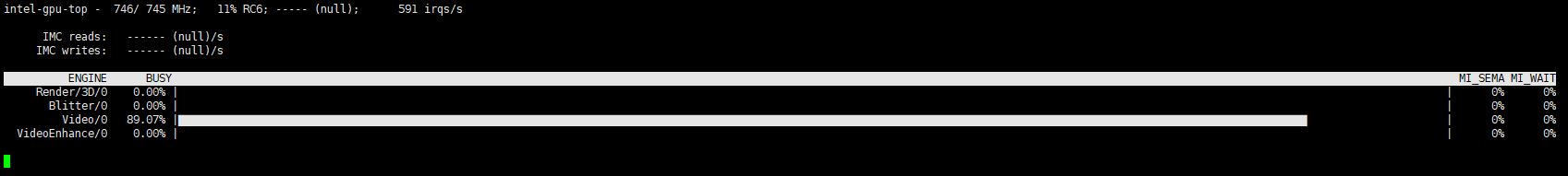

elapsed=00:00:26.50 frame= 4127 fps=156 q=-0.0 Lsize=   33586kB time=00:02:17.67 bitrate=1998.5kbits/s throttle=off speed=5.19x
video:33568kB audio:0kB subtitle:0kB other streams:0kB global headers:0kB muxing overhead: 0.053766%
gpu_tool:
But why we cannot enable VAAPI in emby-server?
